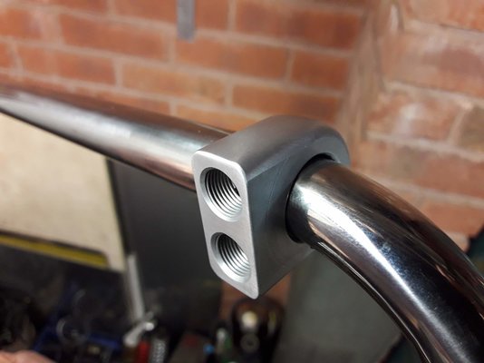

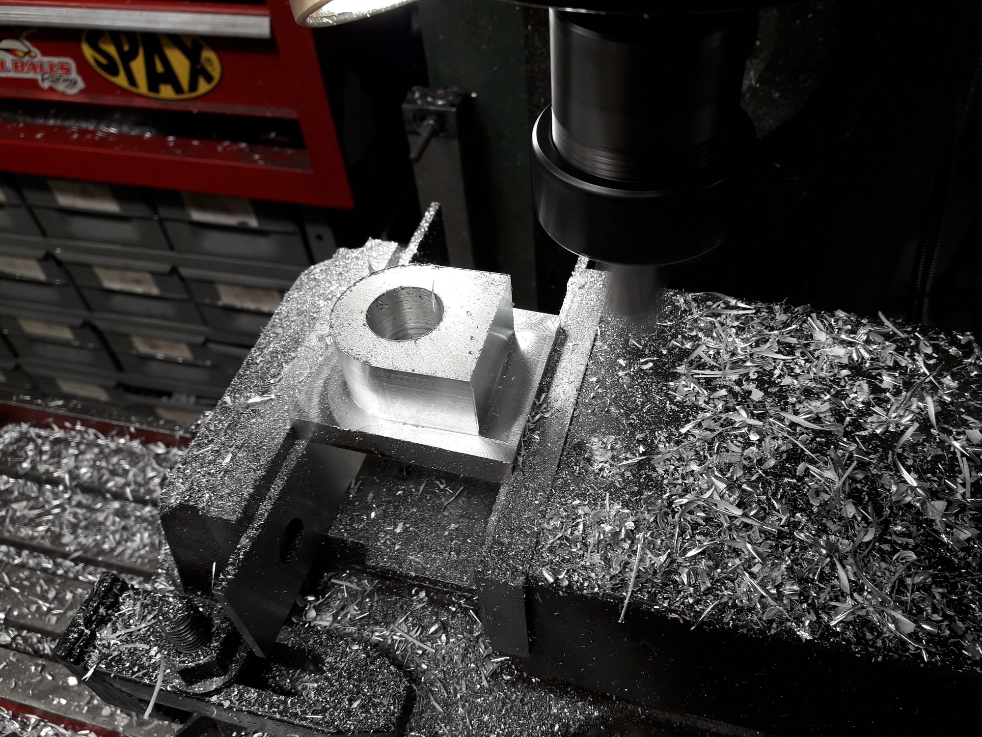

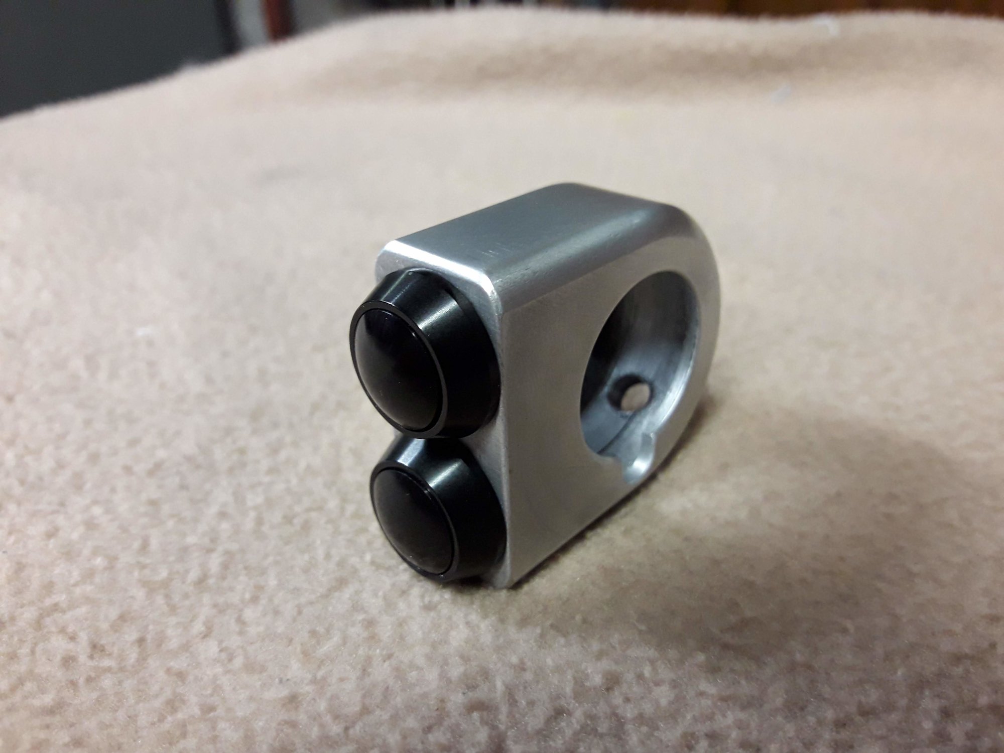

some switchgear for my bike build...
View attachment 199838 View attachment 199839 View attachment 199840
thats what the slot in the side is forSmart
Now you need in bar cables

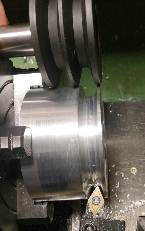

Lathe. New motor and pulleys.Going on from your wanted thread...can i ask what are you making of fixing with stepped pullys?![]()
Rough atttempt at a pulley. Started cutting right side angle by compound and the rest is rough.
Problem being, without a tool angled under 38? degrees, wont have clearance enough to sweep the bottom. Should I start with a square groove tool to full depth, and then cut the angles, until they intersect?

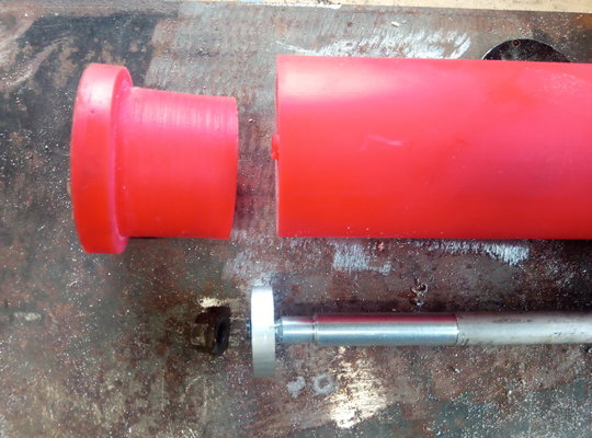

Just to make some stainless sleeves and its done. Hopefully Only an hour left
I have only ever machined it once and thought it was quite nice to machine, maybe a different grade or something. I used a DNMG insert but it was actually a HSS insert, polished and very sharp with a positive rake.Horrible bloody stuff.
I've tried that once, I found it worked much better using the more rigid rear toolpost, tightening the gibs on the compound would have probably helped too.You can do the keyway on the lathe too if you don't have broaches and a press. Using the carriage like a shaper.
