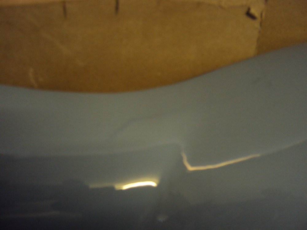

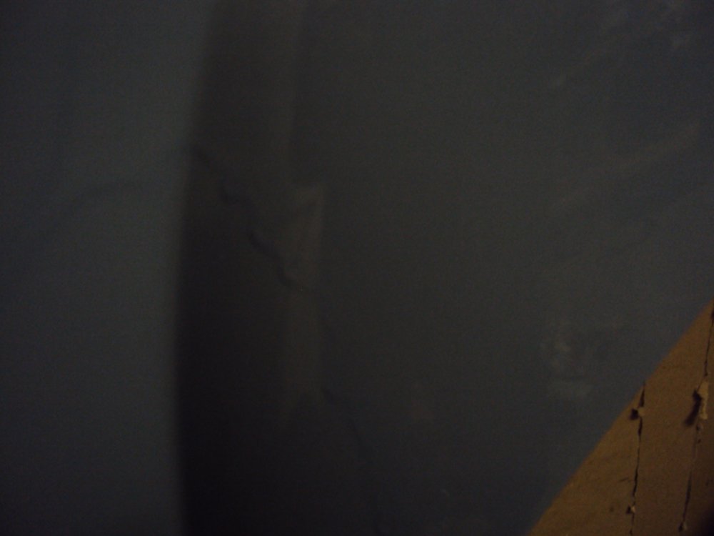

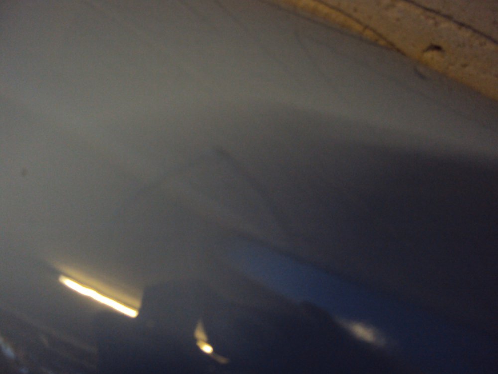

Ok tried that , Its gone on much better , it looks pretty good, one or two small runs but hopefully I can get them out. I watched a youtube video , where you cover the the run with filler and then flat it back , has anyone tried this ?
Yes that will work but it's a lot of fafthing about if you ask me, most painters will just razor the top off, flat it and polish
