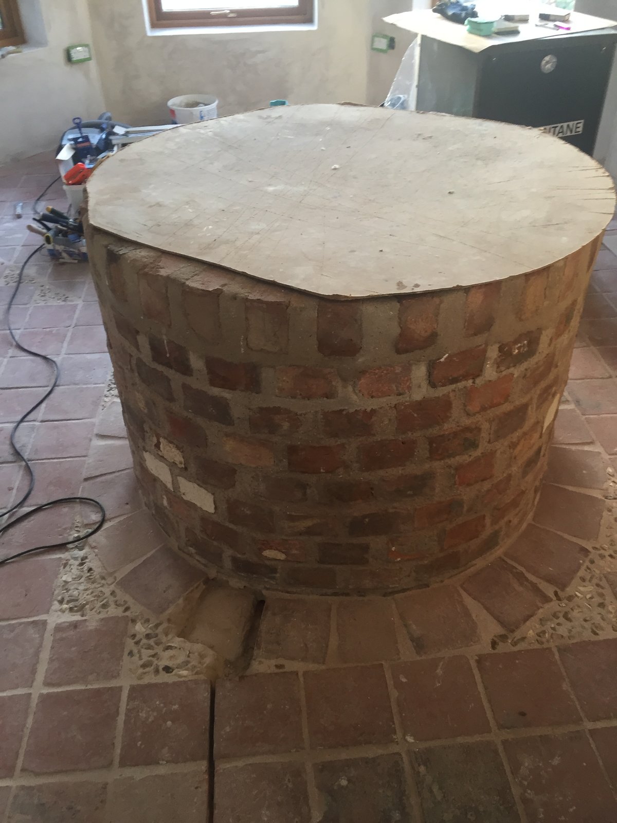

The wells are about 20 feet diameter and 80 feet deep.

I’m confident with the break tank and pumps for the W/C and washing machine supplies, just the drinking water treatment. They are getting it tested so we can proceed from that with what specific treatment is needed, however today she rightly pointed out we drank from untreated wells for a long time
Pic of the well, was looking at other stuff today so couldn’t get any more

My biggest worry would be getting a suction pipe down the well without damaging the floor.

A piece of stainless steel pipe coming from the ceiling and down into the well. Hide it in the ceiling and then to the pump package. If you get a decent pump it should work. Or run a large diameter pipe with a power cord and a hose inside it and use a submersible pump

Test it.
Se what needs doing to it then spec system to treat it.
Just hitting it with UV will only kill bugs not alter trace elements / metals that can be just as hazardous.
