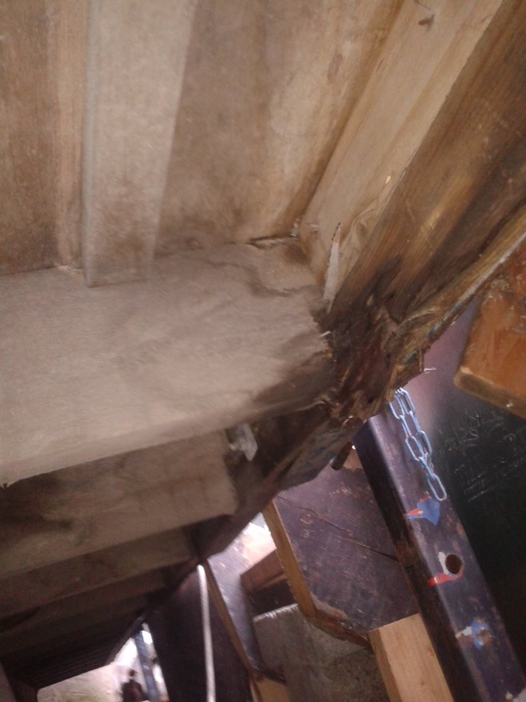

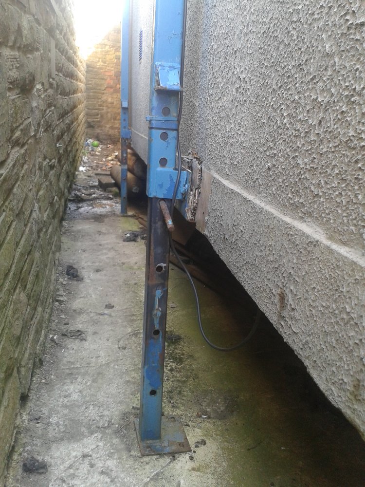

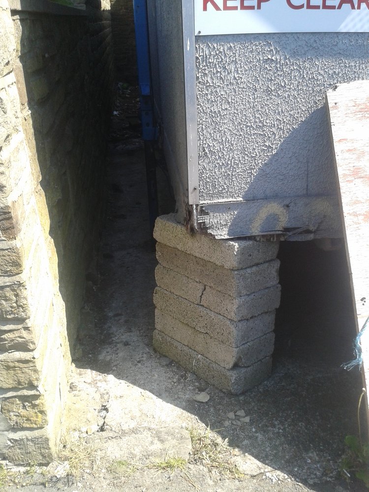

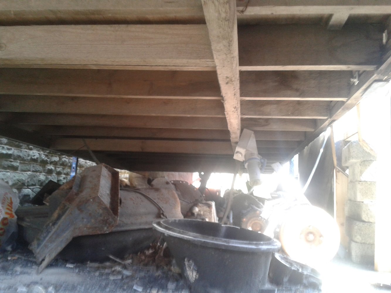

Not all site offices / welfare units have steel floors.Another good cheap idea but I doubt the floor would take any of the weight or the access route. Thanks
I have a 20x8 that only had wooden beams & the floor surface with no steel under.

Just as a side note , you could probably save yourself some money on hardcore as they only put any stress / load on the 4 corners . So in an ideal way , concrete 4 pads for the 4 corners to sit on and lay weed membrane underneath it .Work should be starting in the new year at my place so everything will be have to moved into a shipping container at the bottom of the garden.
