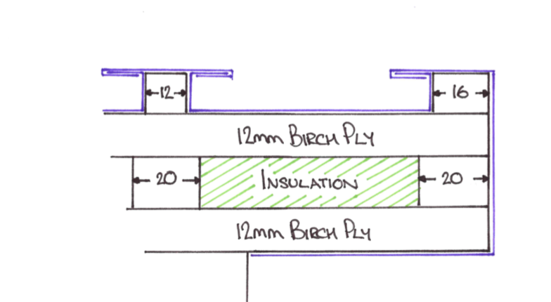

0.5mm is going to be a sod to weld without distortion unless you’re experienced, let alone with wood behind it.
Change the design.
How thick would it have to be to stand a chance of being welded? 1mm is getting pretty thick considering large portions of the roof will be up to three layers by the time they're folded on the ribs
