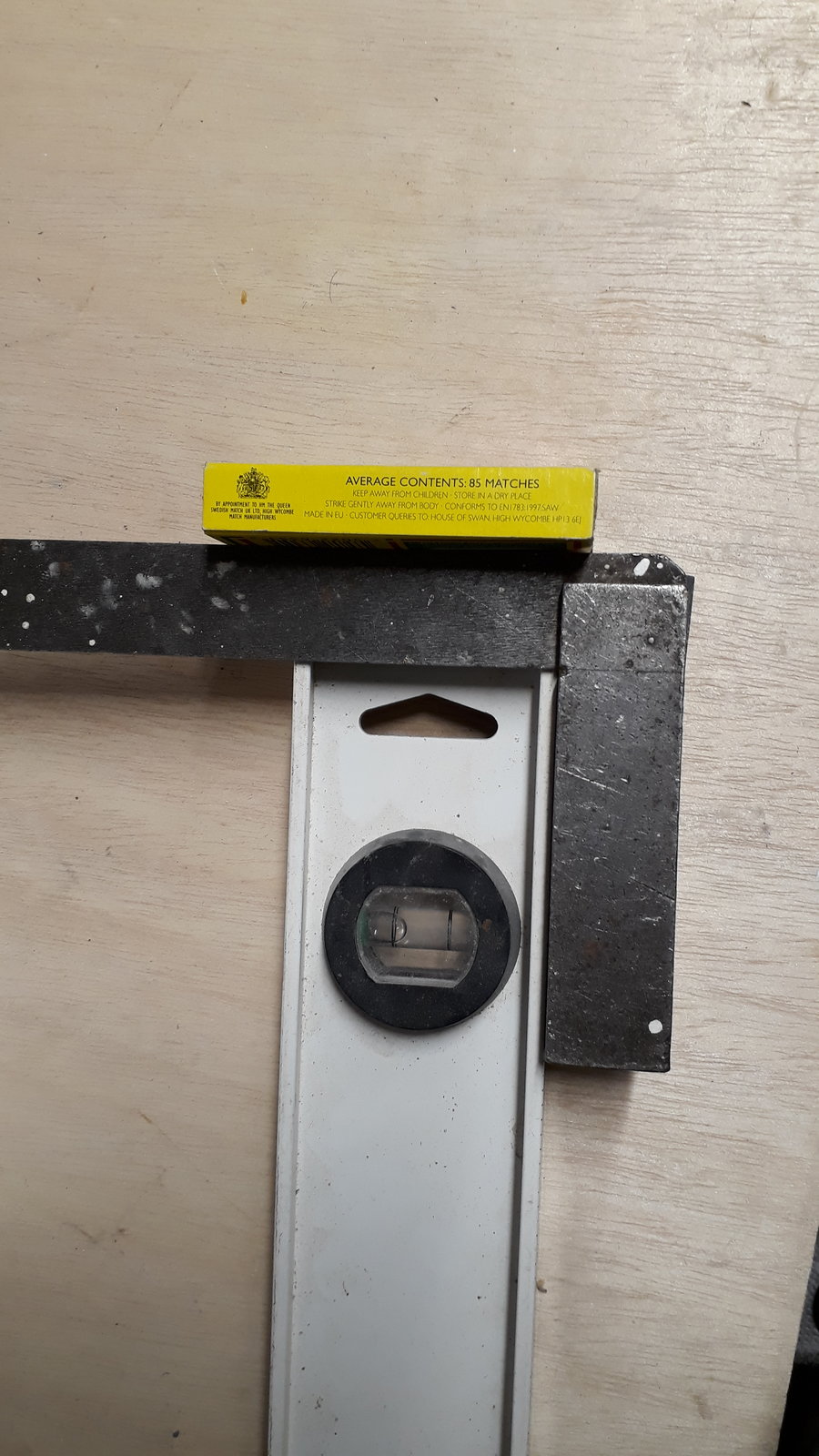

Burdekin Chief Bodger Messages 6,657 Location Aberdeen Nov 18, 2018 #21 Clamp it together, get it square etc then tack fully and weld, job done.
Pond frog Member Messages 383 Location Warwickshire uk Nov 18, 2018 #22 Leave your flat section long enough to use a square then cut it down to size after its welded up.
Hitch Moderator Staff member Messages 13,276 Location England Nov 18, 2018 #23 Imagine the matchbox as the plate, level as the box section... 20181118_193916.jpg 226.6 KB · Views: 12
james butler Member Messages 1,496 Location birmingham england Nov 18, 2018 #24 righty ho will give it a go and see what appens. thanks for all the input everyone
fixerupper Member Messages 1,685 Location Crete Greece Nov 18, 2018 #25 Oh right that gives a better idea of what you are doing ...I would do all the taping and then bolt it altogether and then clamp it up and get it square , clamp in two diagonals to hold it true and then weld it ...
