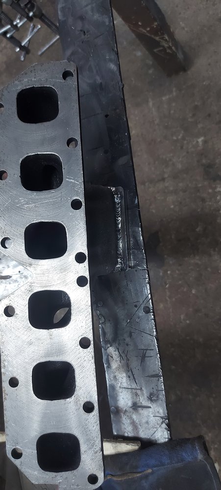

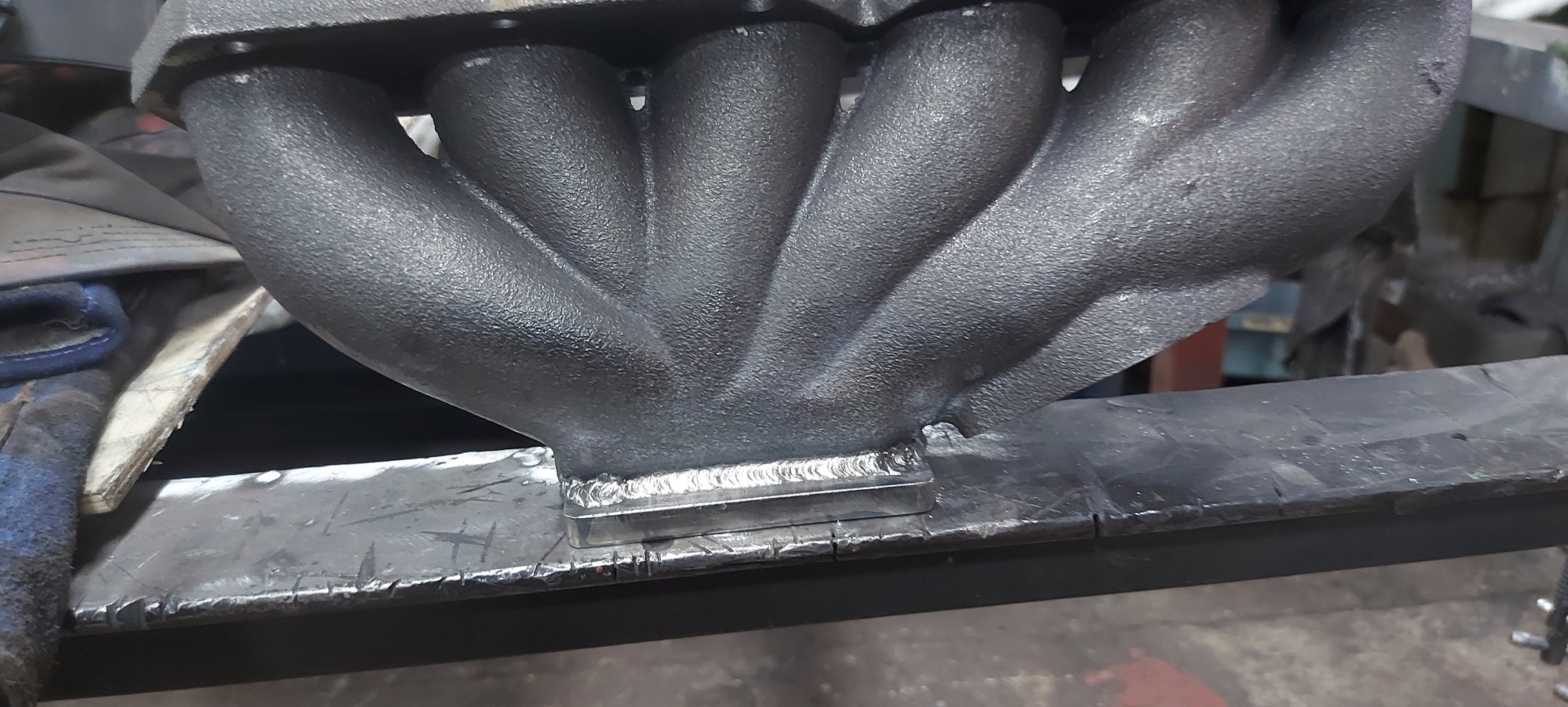

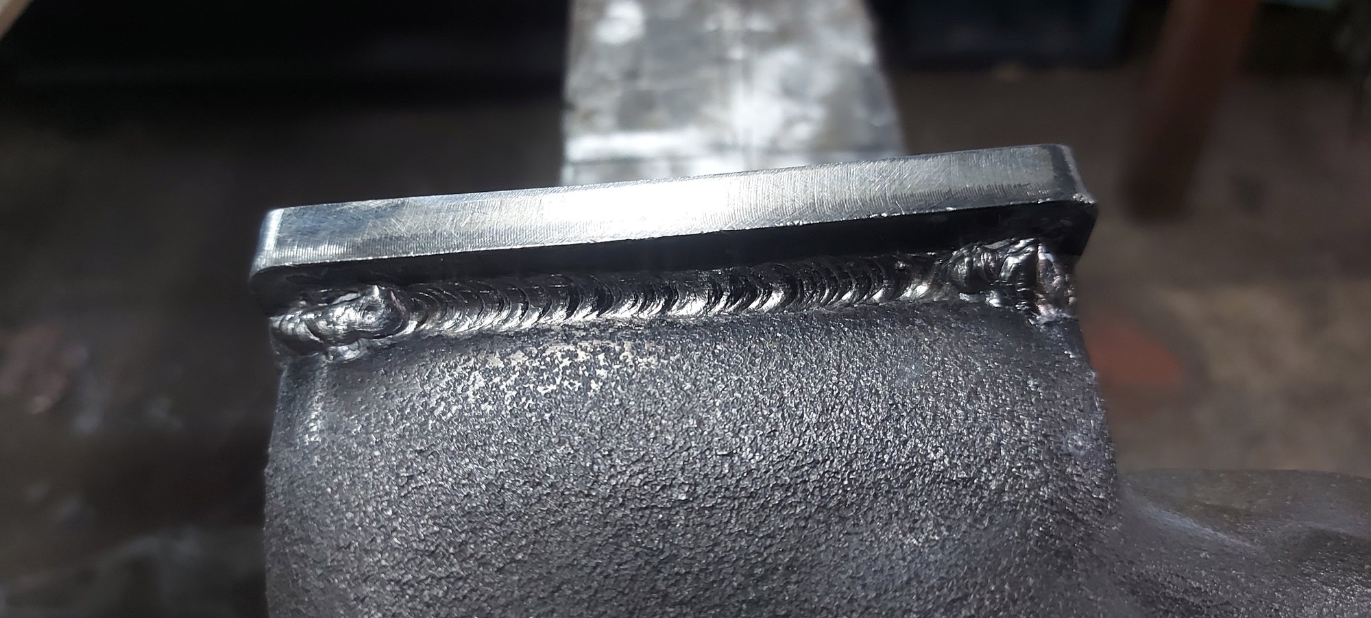

Maybe that is why it welded okish with the mig then.That's got to be cast steel.
If it was cast iron them welds would have been glass hard and destroyed your inserts.
Shamelessly copied from a website
"Cast iron usually refers to gray iron, ductile iron and malleable iron. Which is an iron casting with carbon content higher than 2%.
Cast steel usually refers to normal carbon steel and alloy steel. Which is a steel casting with carbon content lower than 2%."
