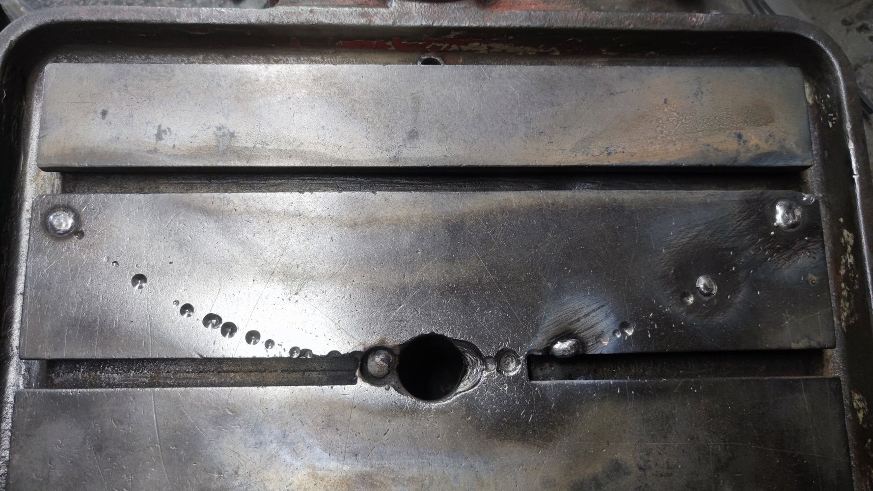

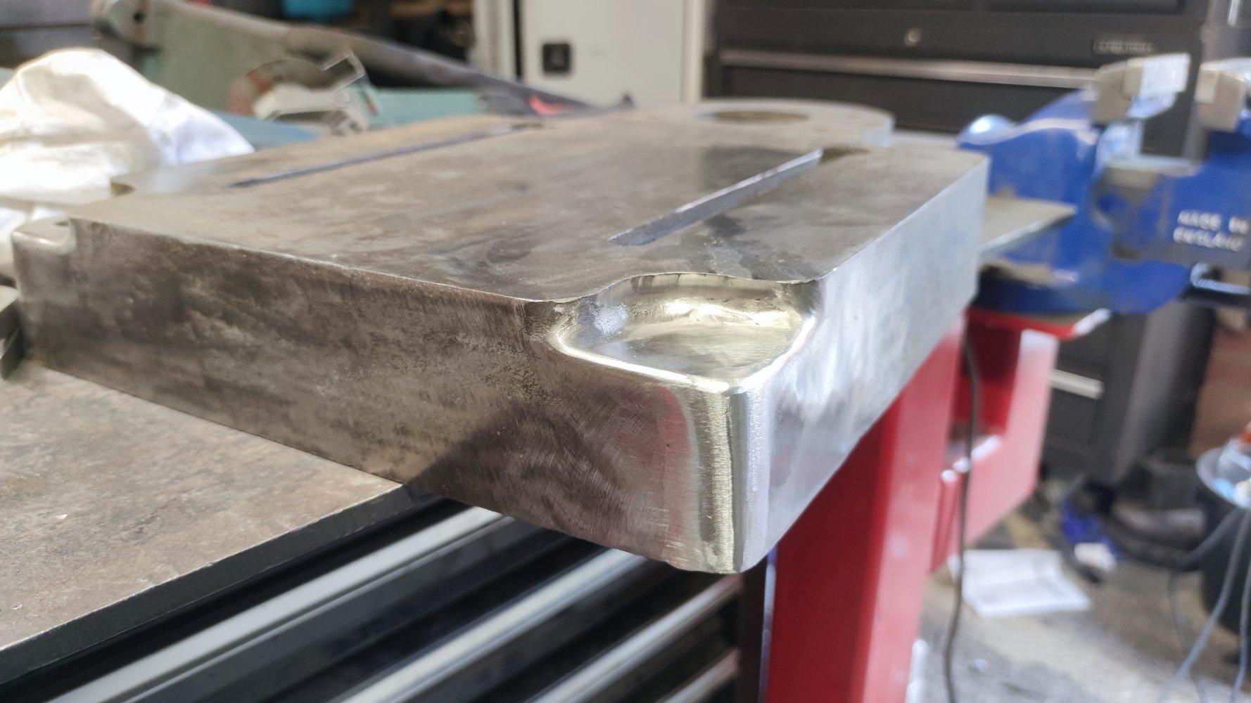

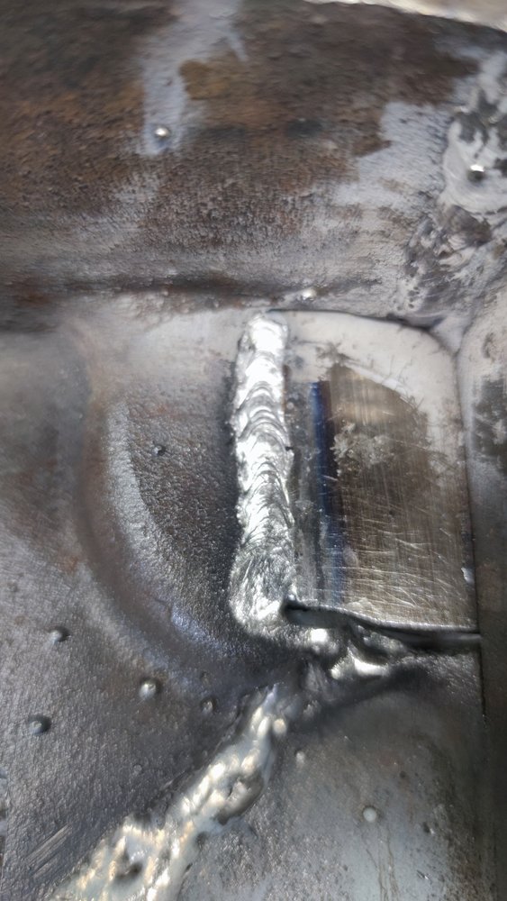

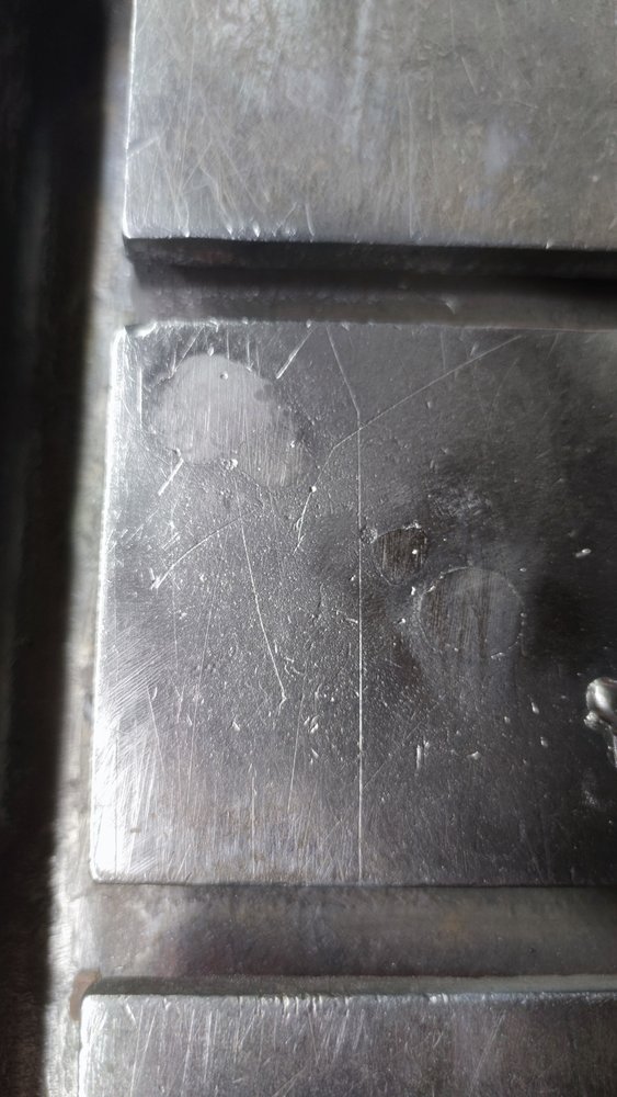

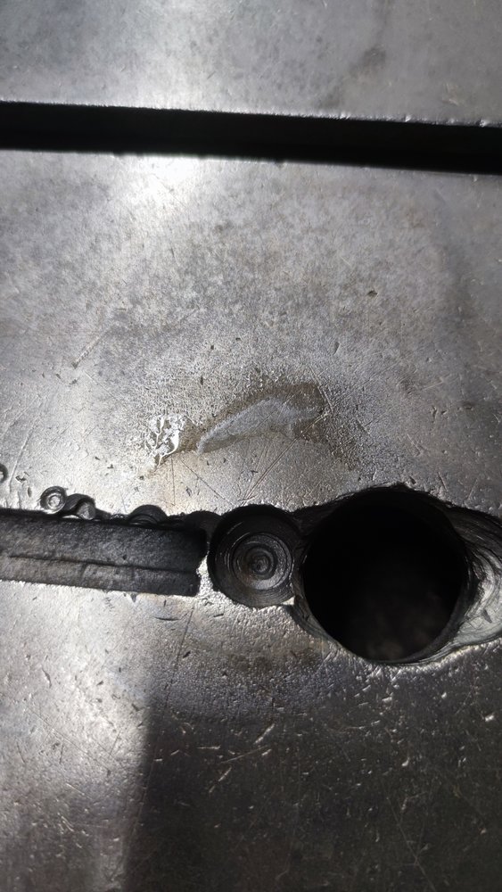

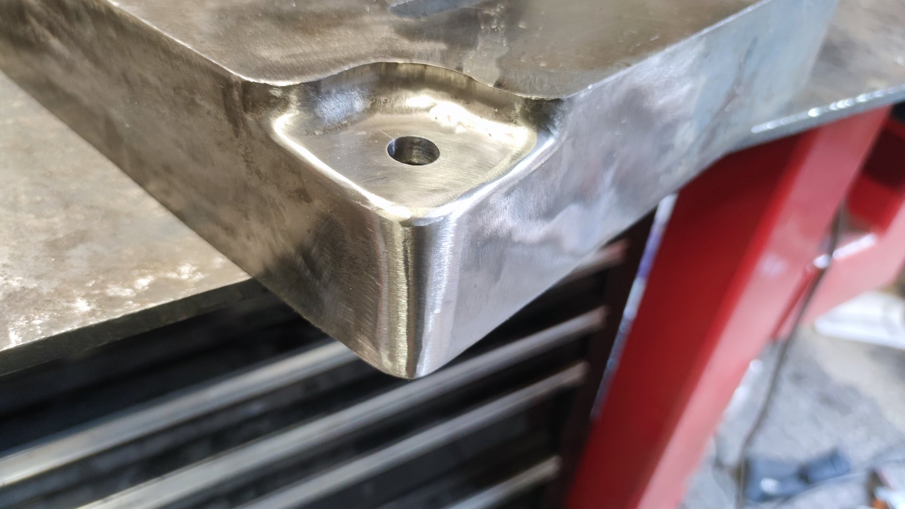

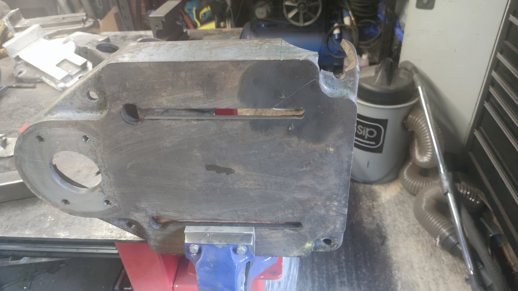

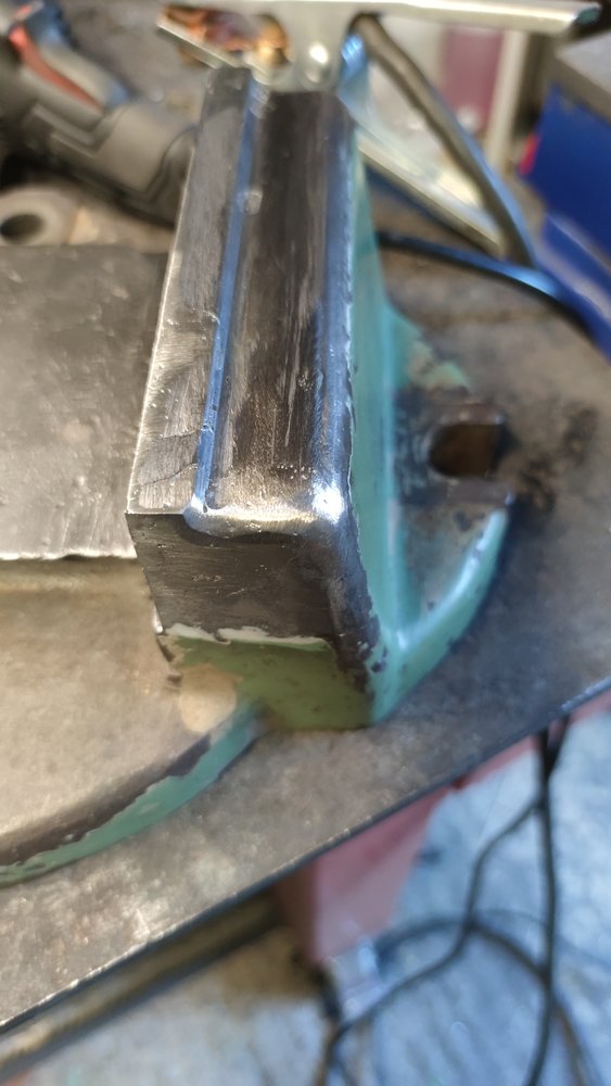

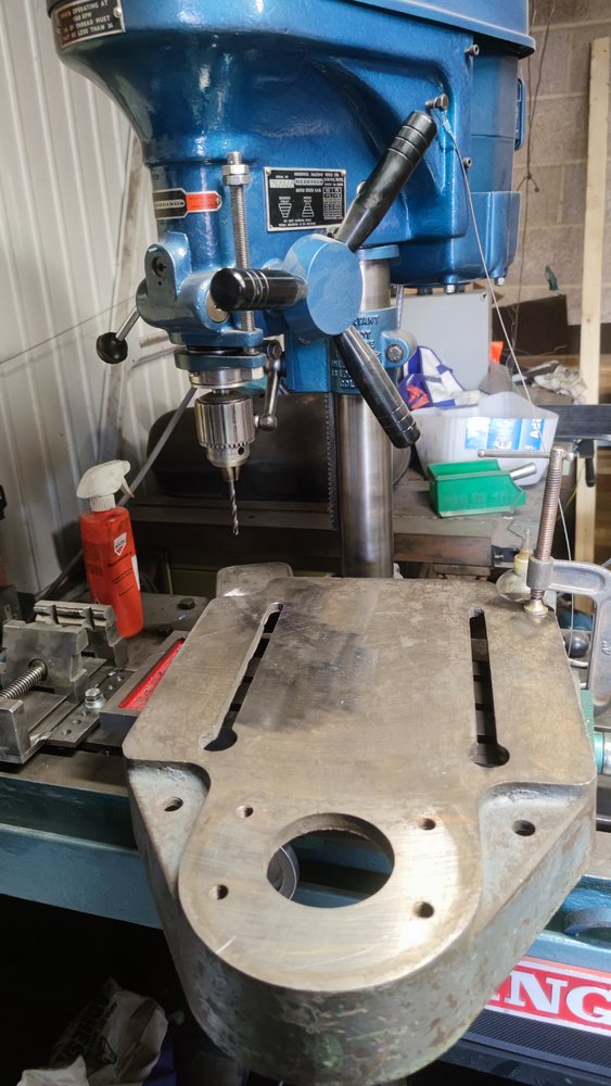

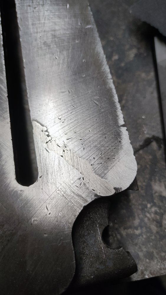

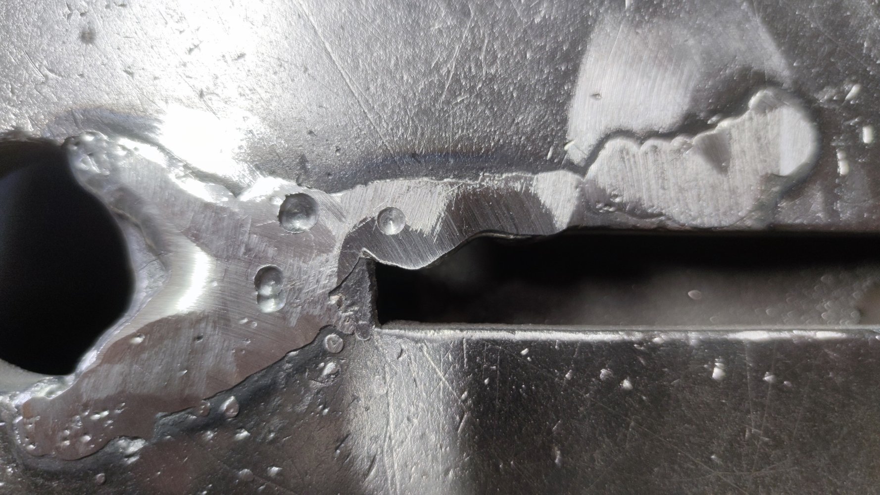

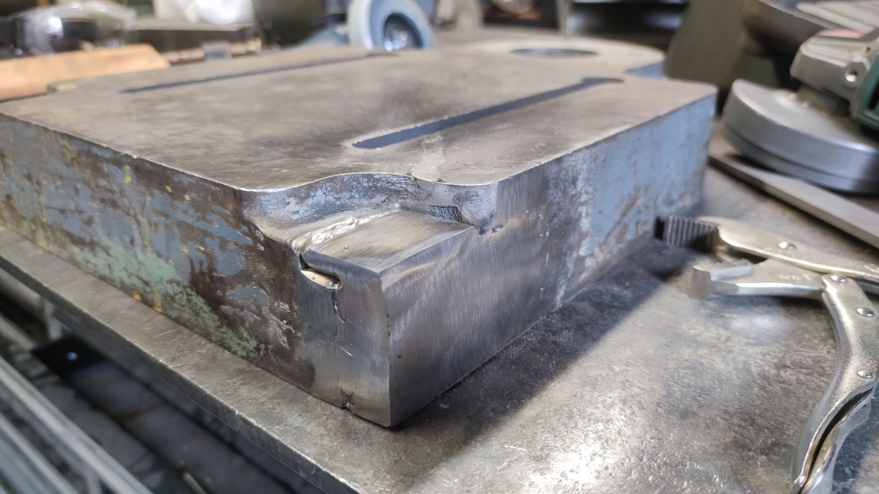

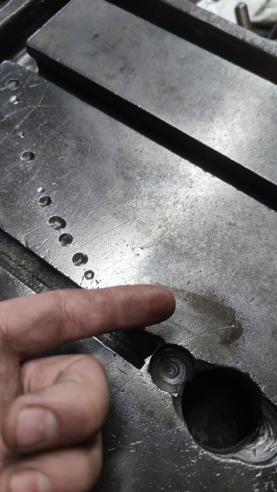

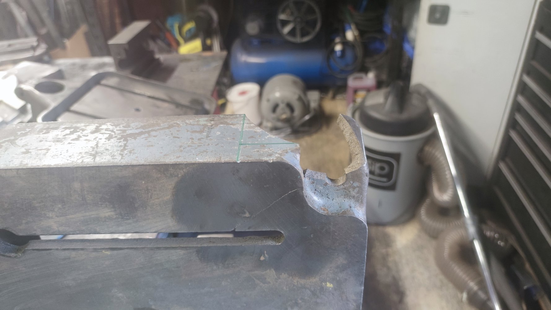

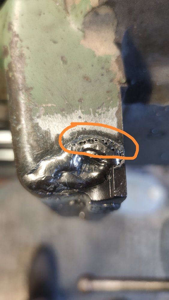

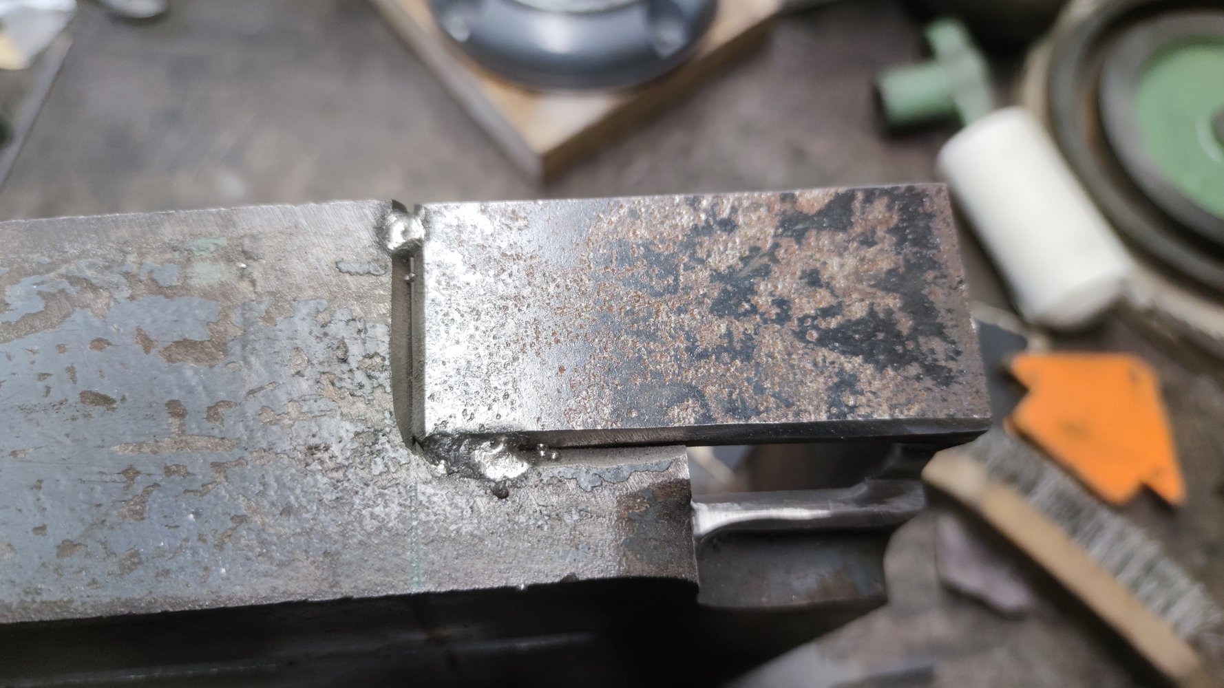

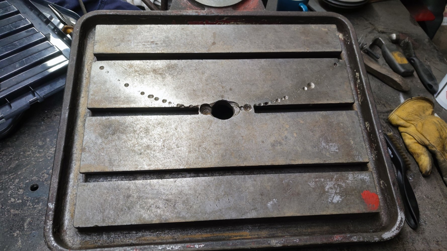

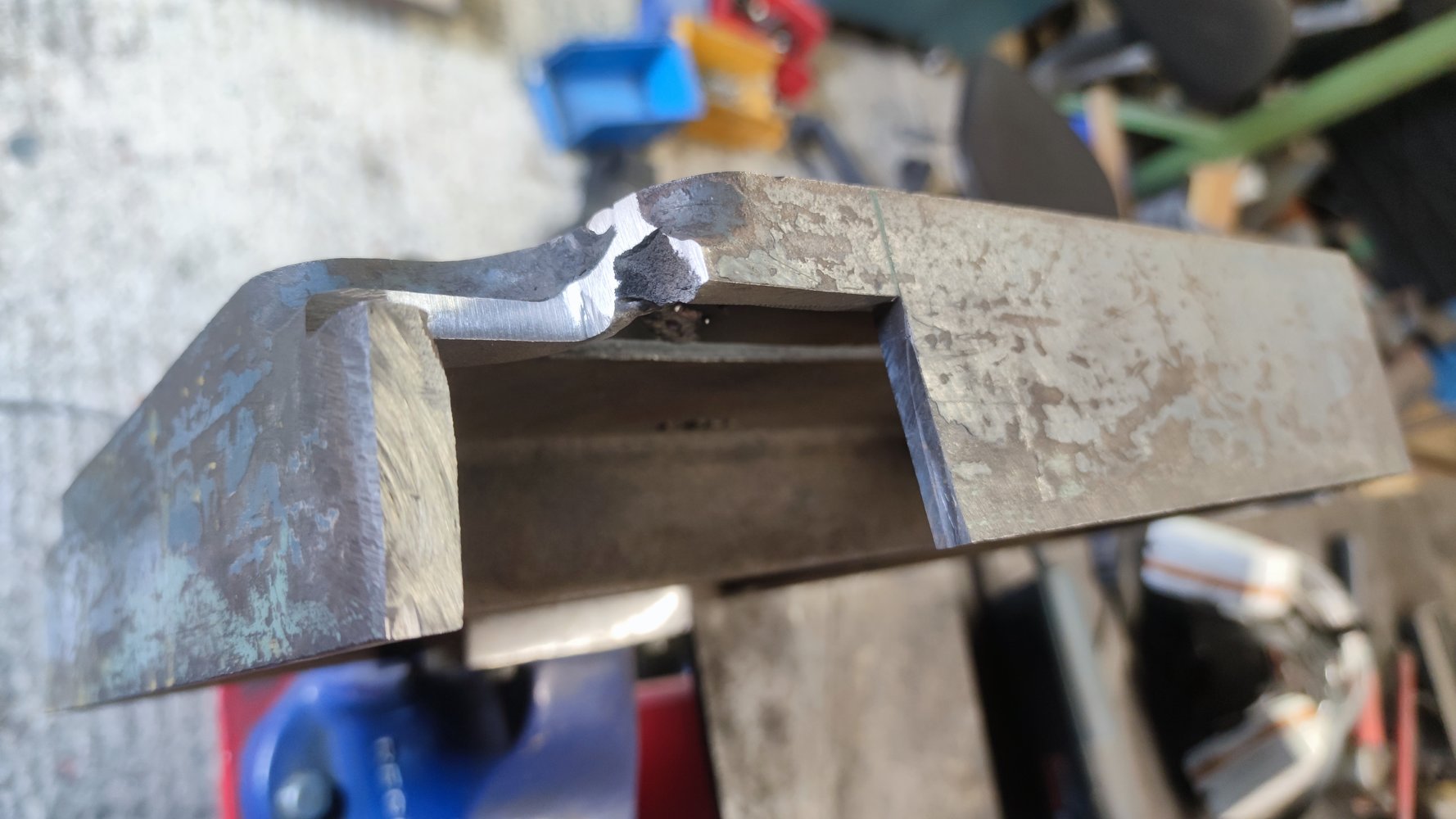

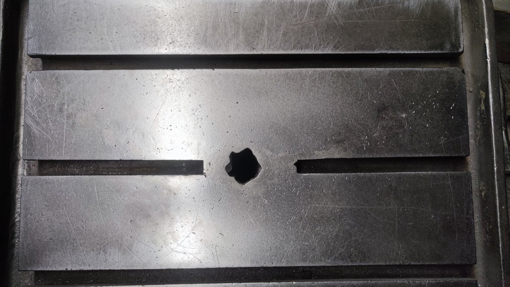

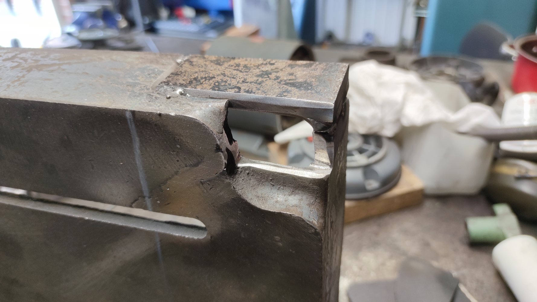

Hi,
I have been trying to repair a few cast iron drill tables and vices.
I have been using NI-CI 2mm rods with varying success. Also some cast iron seem to weld better than others.
I have bee using the 'cold weld' method doing short runs to keep the heat down.
Can anybody explain why these holes/craters sometimes appear? It is driving me insane.
