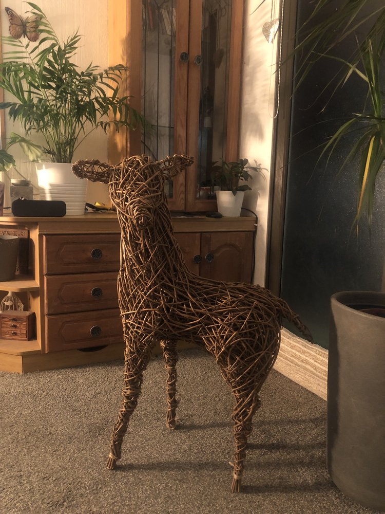

I’m a willow sculptor; this one isn’t finished but you get the idea. I want to go bigger so I need to learn to weld armatures7018s are better for a stronger weld granted, but they seem to start and restart better on rusty quarry crap, which I used to do plenty.

Will that grow?I’m a willow sculptor; this one isn’t finished but you get the idea. I want to go bigger so I need to learn to weld armatures

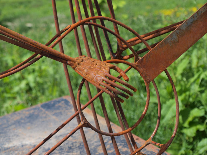

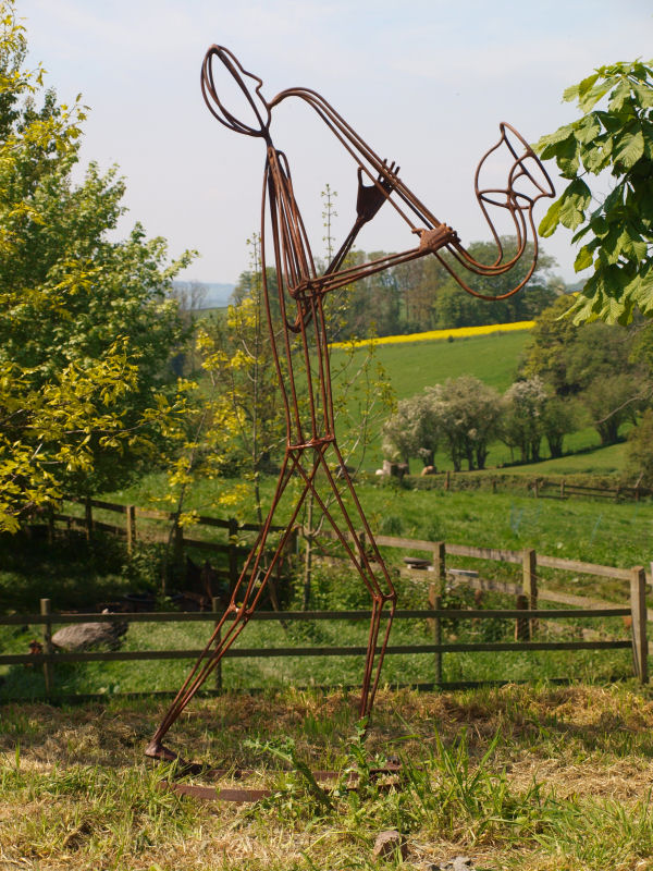

Thank you, it’s good to see the welds up close and I understand what you meanI used a clarke 130 amp Mig welder on this for years, more than enough power and leaves a nice clean tidy weld that does not need dressing or grinding.
Runs happily on a 13amp plug as did my 180 amp Butters Mig
These are made of cold bent 8mm mild steel bar I prefer top use the black finish stuff as its easier to form than bright cold rolled and a lot cheaper.
With practice you can radius the welds off as in the close up photo, just make a couple of passes close in and twist your wrist almost as though you are using a pallet knife with clay. Hard to describe.; easy to do

No it’s not living willow, it’s dried Black Maul but some people do make them so they’ll growWill that grow?
