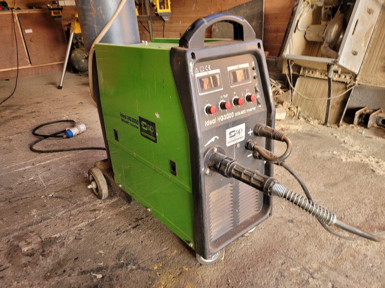

Yeah no problem I'll take some photos in the next few daysThe very early SIPs and one or two of their "industrial grade" later machines were decent, but in general, and especially on this Forum, SIPs have a bad reputation. This includes their recent hobby-level inverter machines, which are overpriced rebranded generic imports, with typical reliability issues.
However, this HG3000 looks like a different beast. Any inverter with a 4-roll feeder and weighing 48kg must have something going for it. If you ever need to take the covers off, some internal photos would be appreciated.

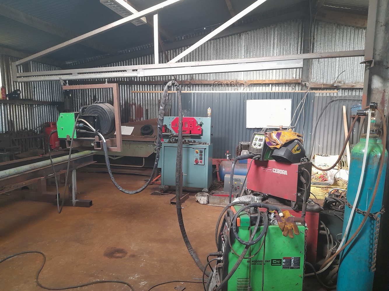

Thats a handy setup with the swinging arm and door track when I get a bigger work shop I'll be doing something similar. Do u do structural steel fab? Those are some seriously heavy stands in the backgroundView attachment 339730

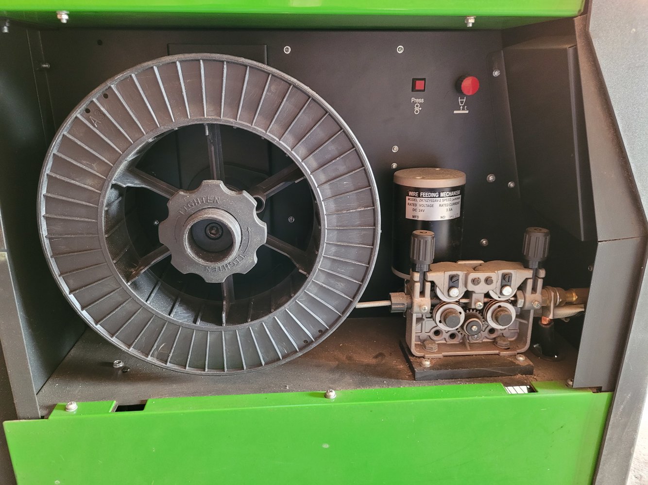

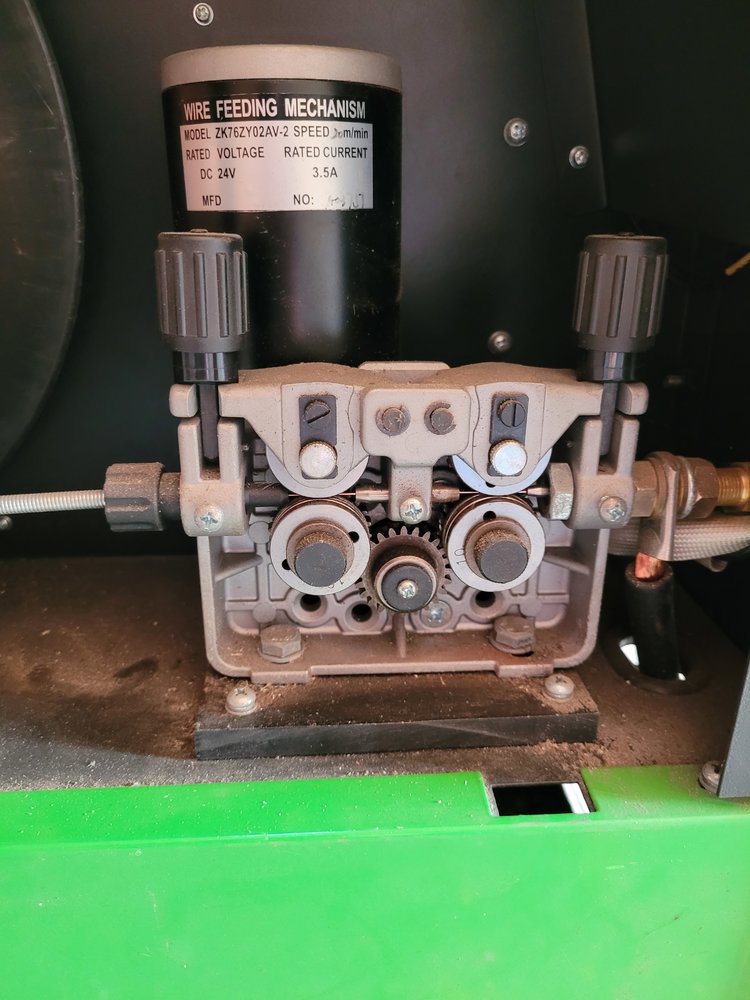

Here's mine with separate wire feed and yes it will spray 0.8 wire with light gas
That looks identical to my Cros Arc 291cHere's a few pics of my machine for anyone interested.
View attachment 339575 View attachment 339576 View attachment 339577
They're quite a bit different to look at...?That looks identical to my Cros Arc 291c
Case, wire feed motor/gears/ quick wire feed switches look much the same to me, maybe same frock with different knickers?They're quite a bit different to look at...?
