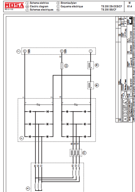

So the first test is check AC voltage going into the rectifier If it is then check the diodes on the rectifier

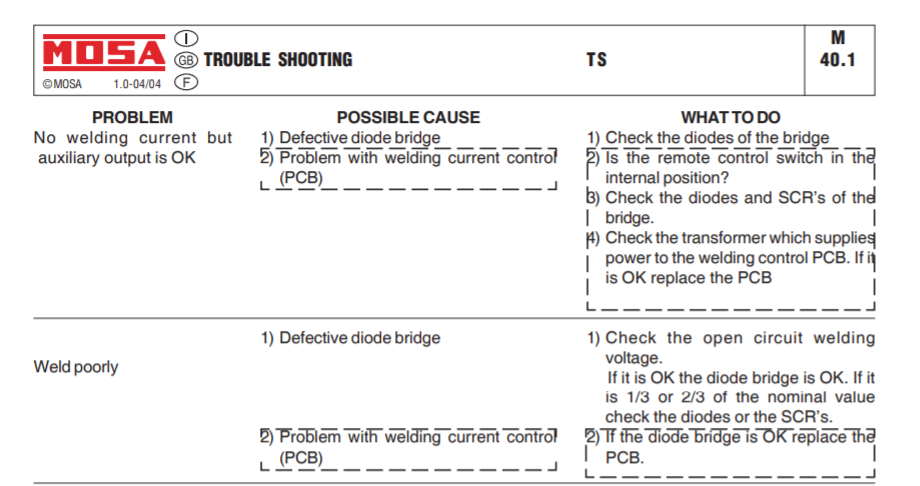

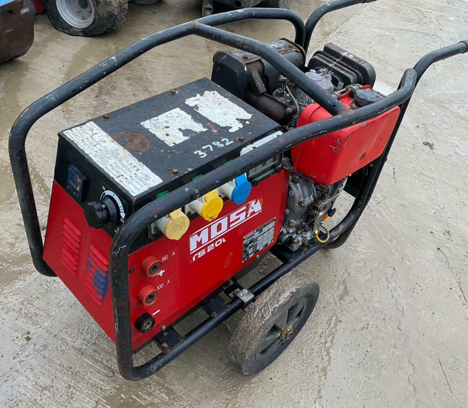

Mosa TS 200 is an engine driven generator and welder.
The generator side of it works but the welder doesn't.
The manual says to check or replace the diode bridge. I know where and what the diode bridge looks like and what a diode does (like a one way valve) i'm just unsure how to test it in this context.

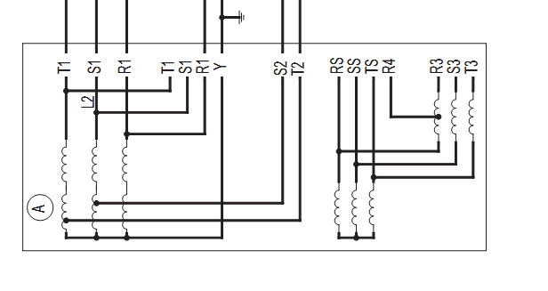

Well i'm glad the windings are OK.If auxiliary power works diodes are not short .
And windings are good

Diodes might just blown open circuit.
They still need to be replaced but at least you're not cooking the windings.

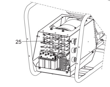

If the diodes are blown are they indentifiable and easily replaced or does the whole rectifier have to be replaced?
