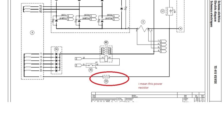

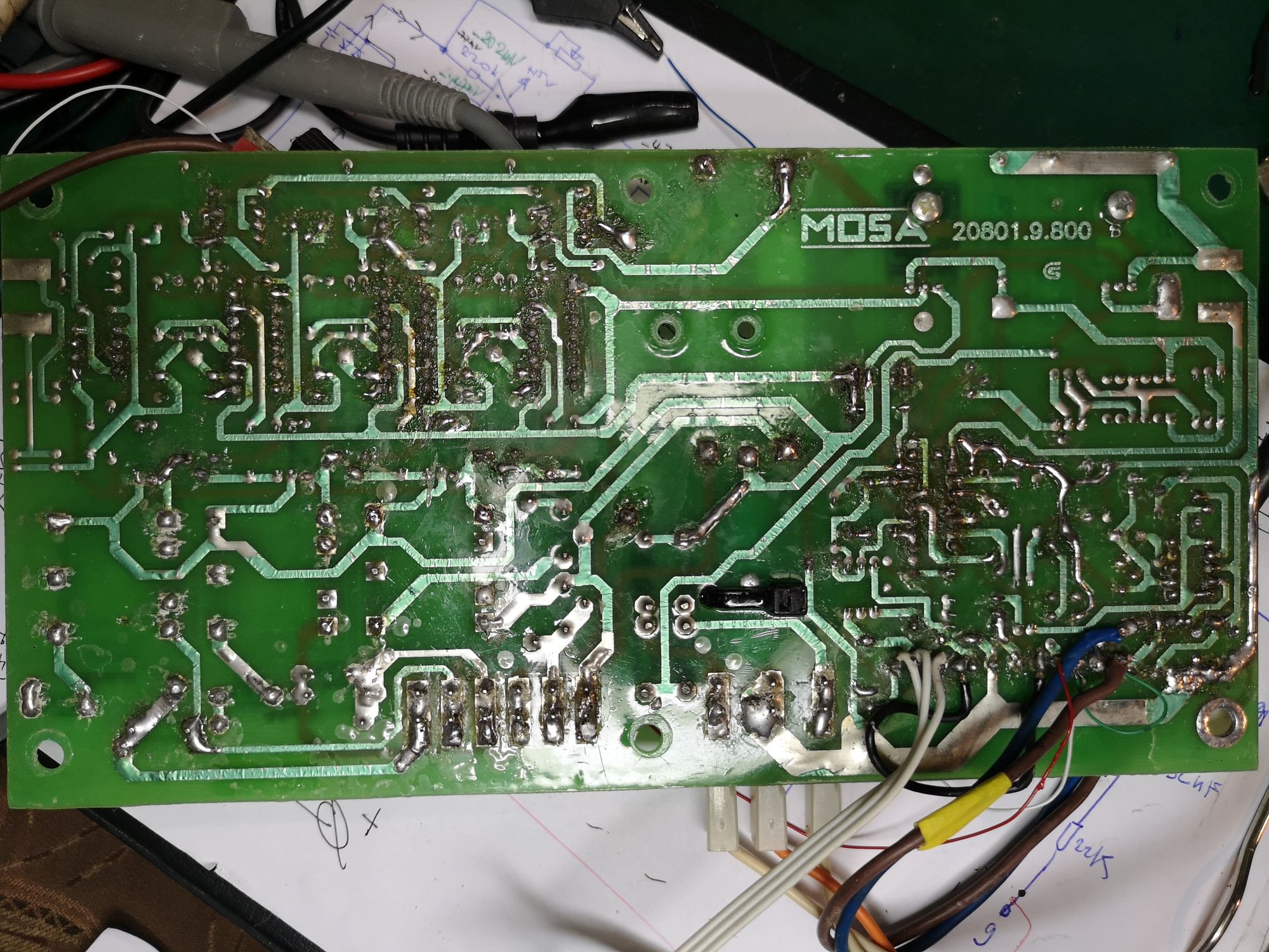

Nota : the LM348 becomes now giving a different voltage that's increase up by the potentiometer adjusting; but the strange is the pin q2 of TCA785P n°15 is at 0v and the q1 14 is having 3,6V 5KHZ the thing that i couldn't understand why this q1 output is connected to anypoint is working and the one who is used supplying the signal to the ZTX455 is at 0V, what could be blocking this output ?
i upload for you the back side of the pcb.
