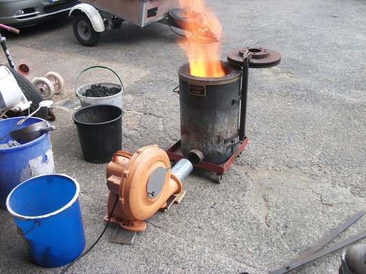

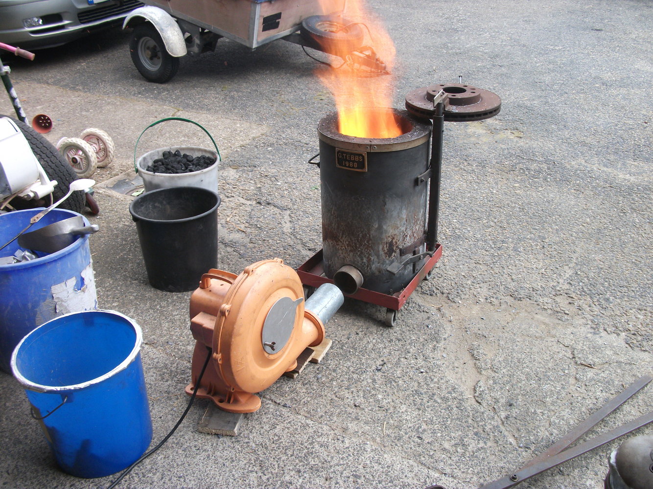

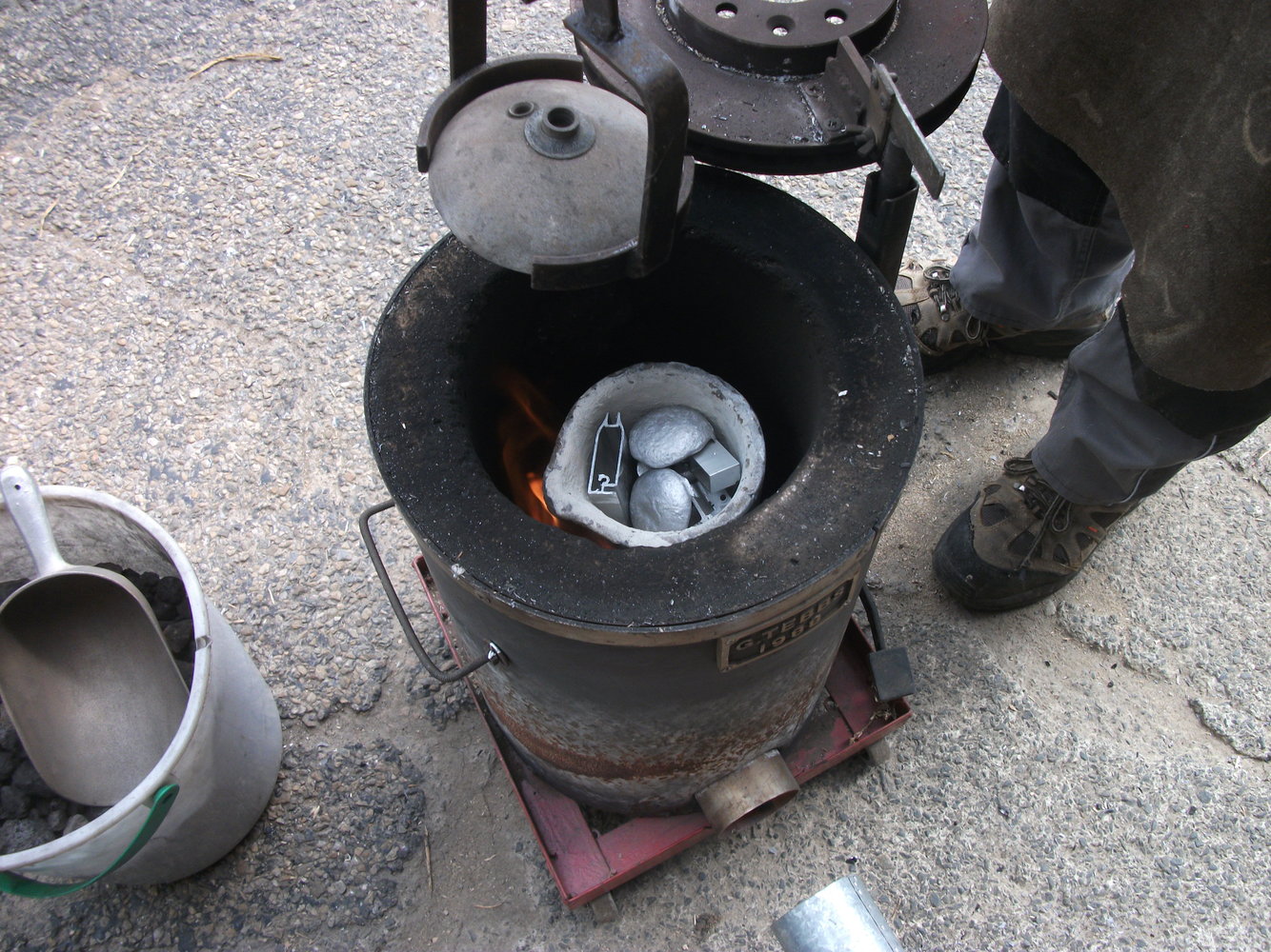

wimpIts a syphon jet that sucks up its own oil and the air also atomises. The reason I have rigged it up to use a gas bottle as a resevoir is because I wanted to add a few psi to it so I can maintain a consistent oil flow, using it as a syphon the oil flow slows as the oil level drops which in turn alters the flame. All experimental atm but its getting there. Next stage is to tip the whole thing upside down and cast the refractory concrete lining in the roof to form an arch, dont think my bricklaying skills are up to building arches
