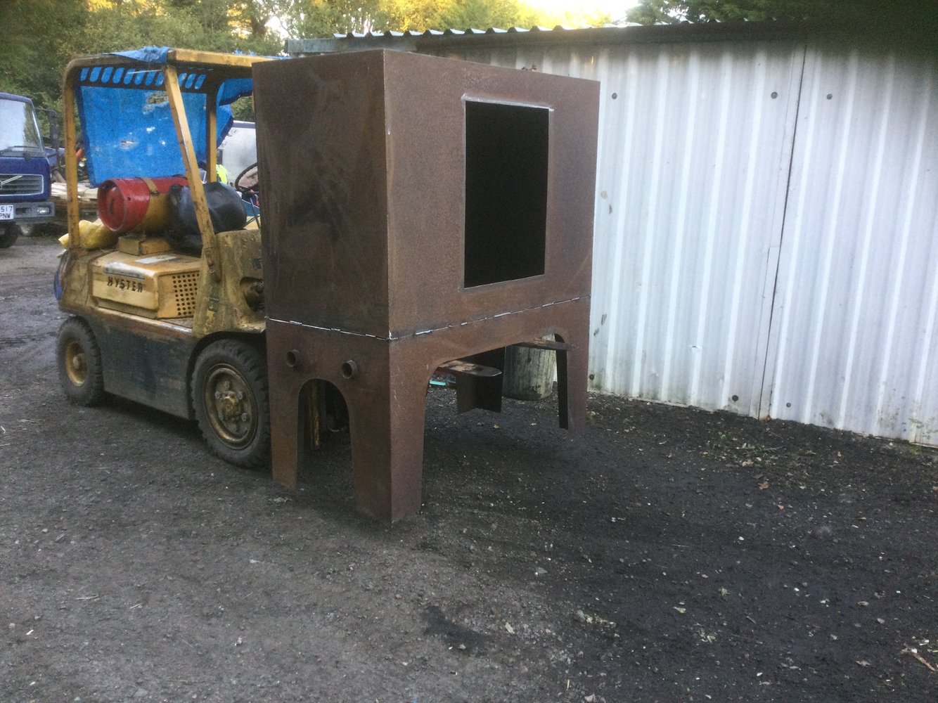

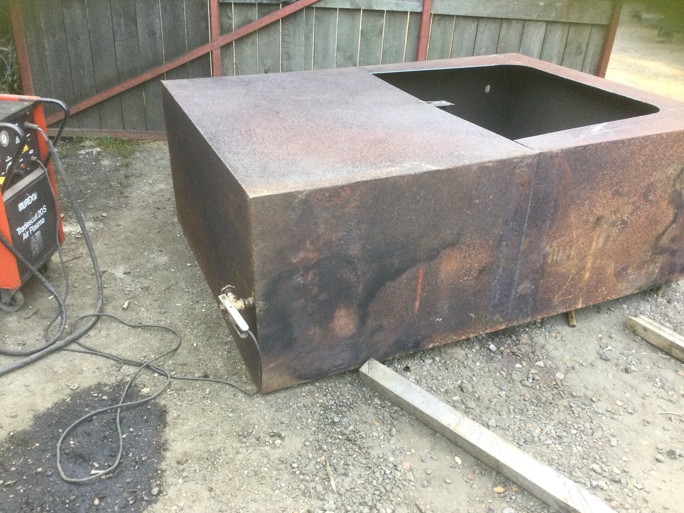

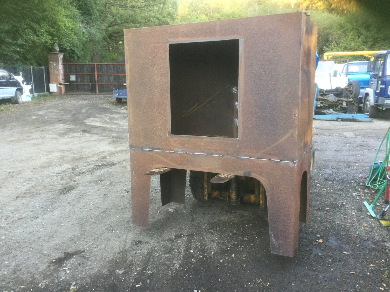

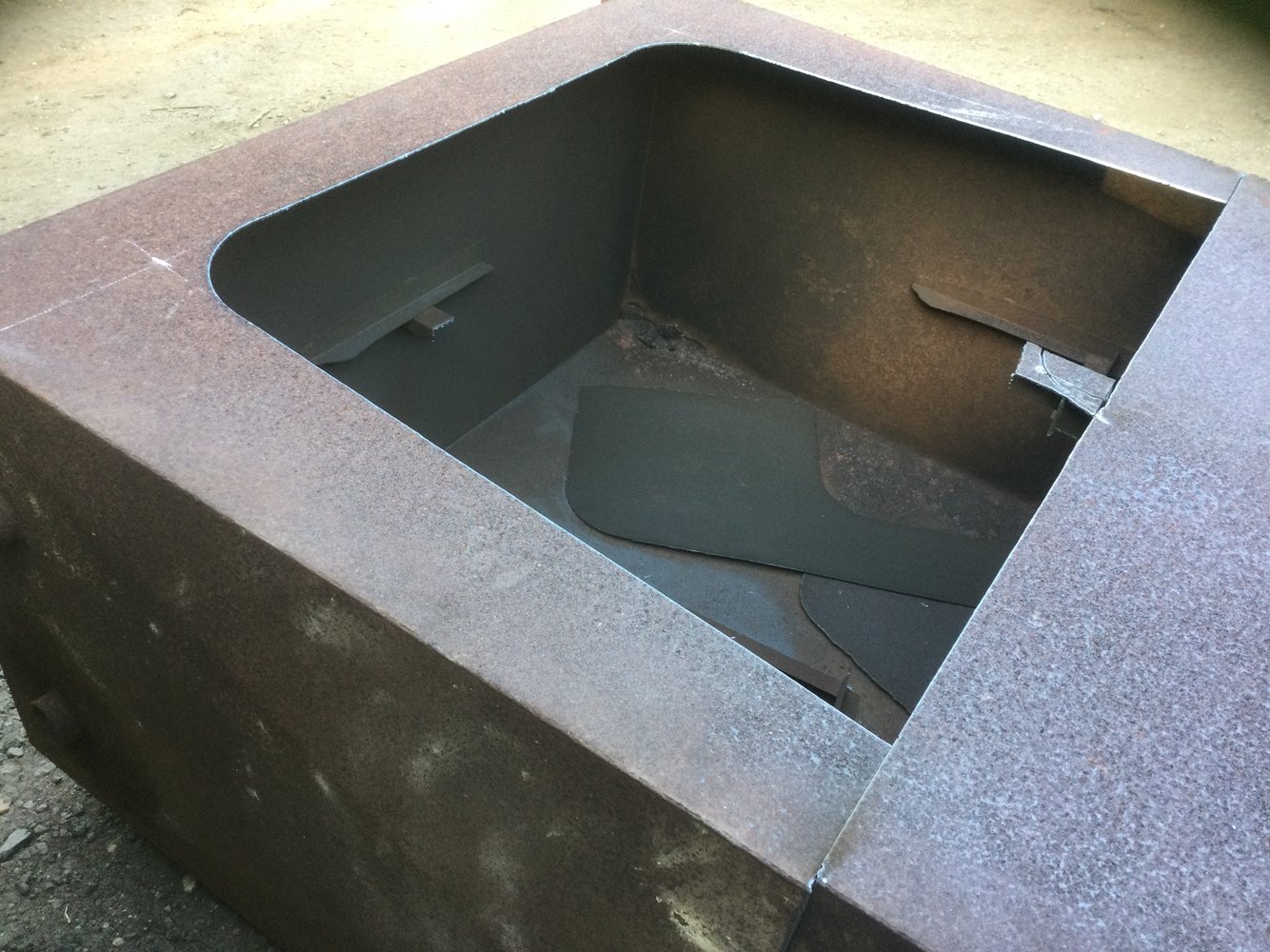

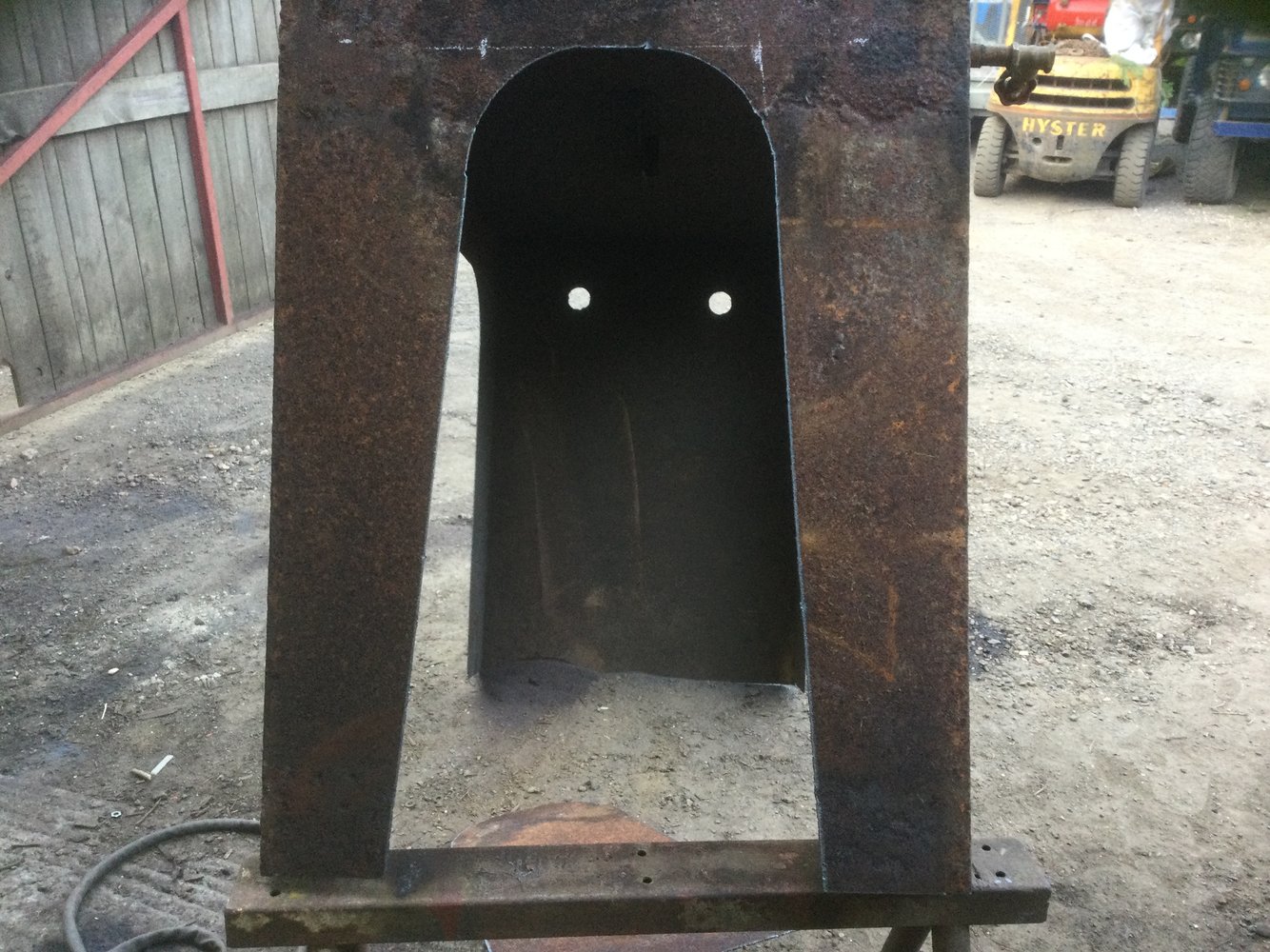

Bob, I just looked - did you ever mention what design of burner you made?Had another play with the smelter today.
Trimmed down the legs to lose some height , scribed in and attached the top and cut the hole for the door.
View attachment 314815View attachment 314816
I'm assuming one of those, is it, delevan syphon nozzles? Did you follow some sort of plan or make it up as you went along?
Your burner looks a lot more controllable than my lashups.
