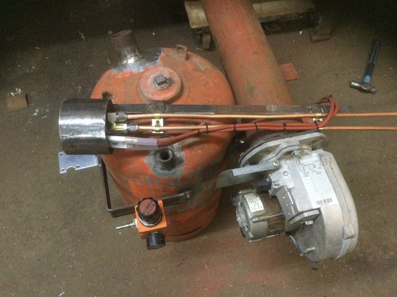

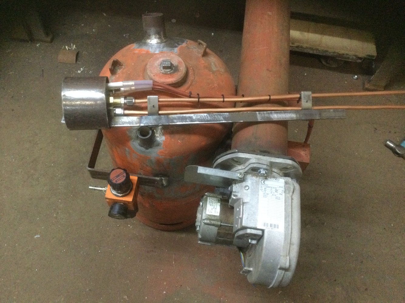

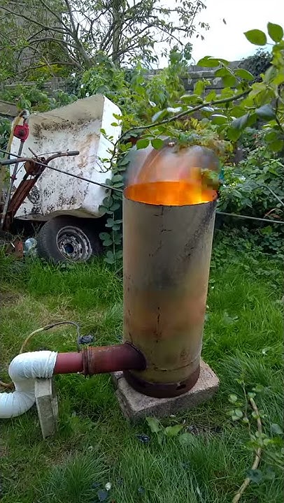

Yes, have since messed about with jets/air ratios and got a nice clean burn (blue), what I cant get is a restart with that particular setting without tinkering with it. What I really wanted was a thermostatic control and flameout function so I could turn my back on it while letting it do its own thing. .
Bob

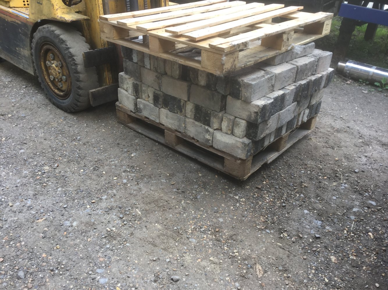

Is that a high stability brick? If not, that may be your problem...I can reduce the air flow simply by putting a brick on the pipe, but the setup is such that it performs better when flat out - ie becomes less stable when restricted with the current design.
A rethink is needed, not just less air.
