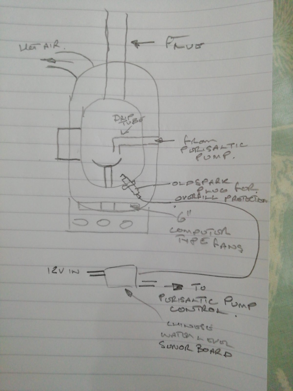

Another thread resurrection sheds cold atm so heater thoughts again here is a rough idea of my plan semi automating it to make it safer and whilst lighting when the kero has burnt out enough in the bottom the oil starts automatically while at the same time if it goes out then when the oil gets up to the level probe (old spark plug) it cuts off stopping oil pouring all over the place I apologise for the drawing
