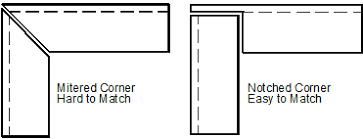

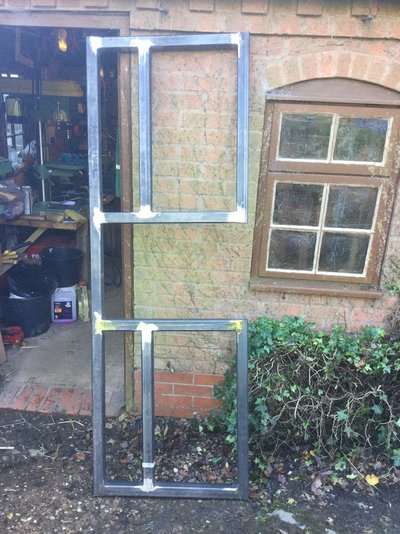

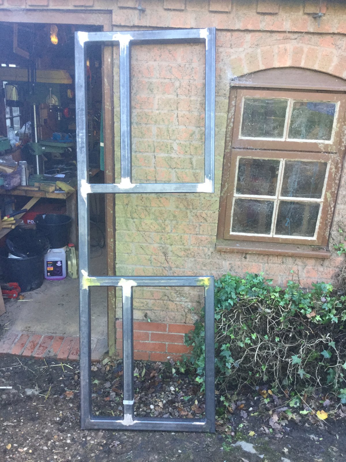

I don't think mitres have done you any favours, think about it, a rectangle with twist is essentially just one of the corners out of true. That's simplifying things, but if you just used straight butts the distortion would have tended to just tilt an edge.
