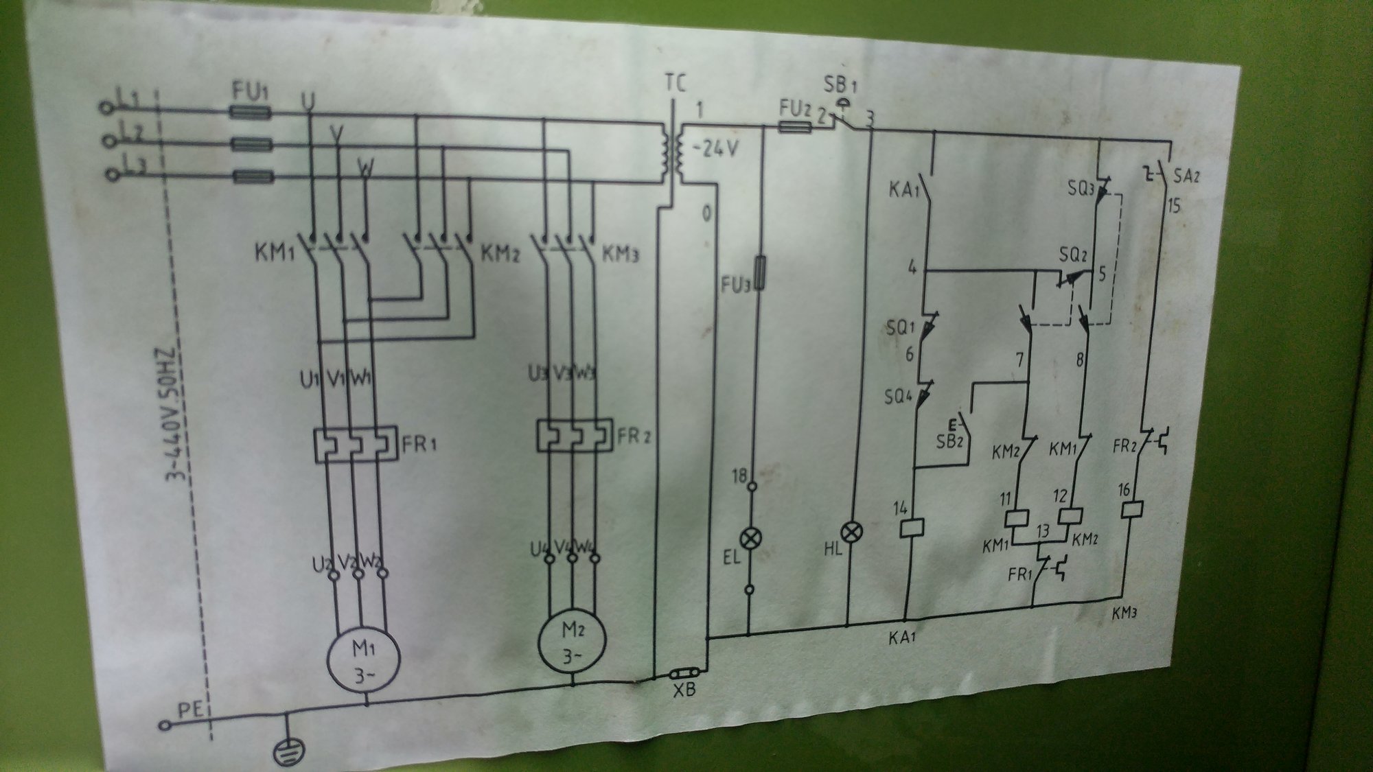

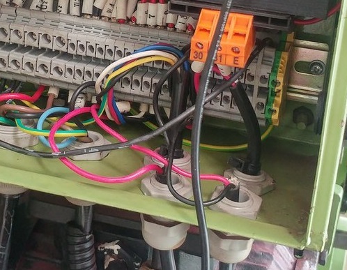

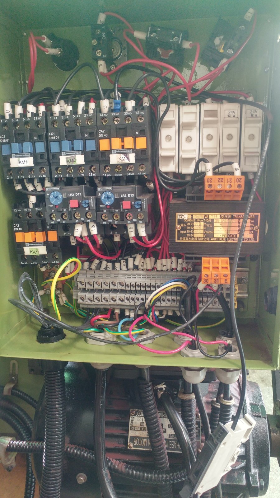

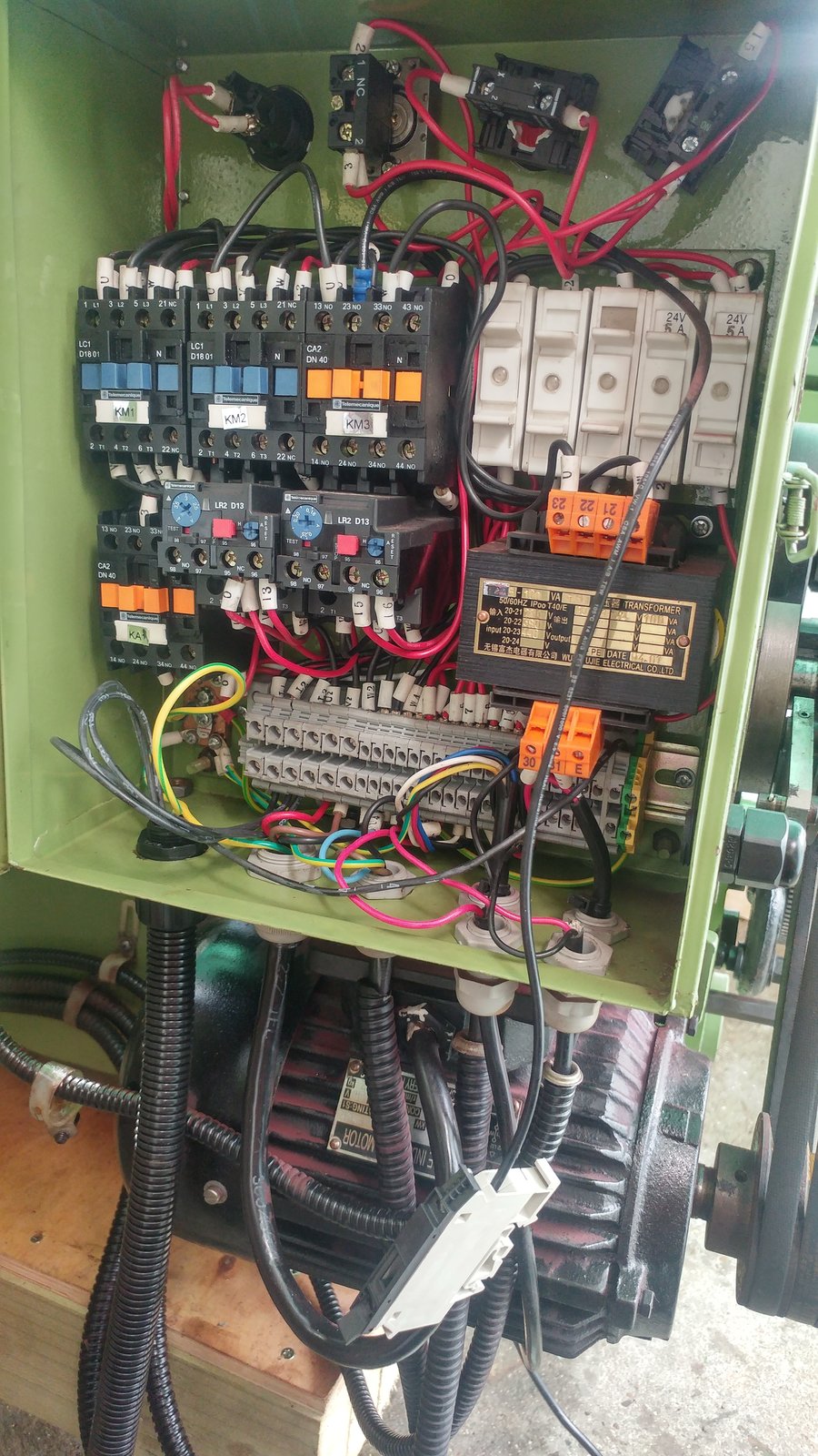

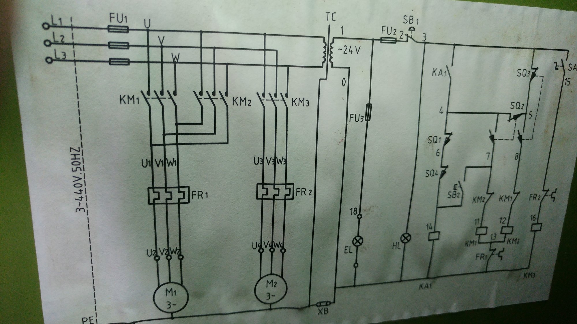

I have been in touch with warco and they said that they use transwave so i have contacted them and the converter i need is £493.00, i have been and got the cable but before i order one of those converters this is what the inside of the electric box looks like and i have noticed there is a black cable running to a case with a fuse inside but the cable does not run to anything, do you know what this could be?
you can also see marked l1 l2 l3 the earth and i assume the other black is the neutral but the neutral doesn't appear to run to anything?
