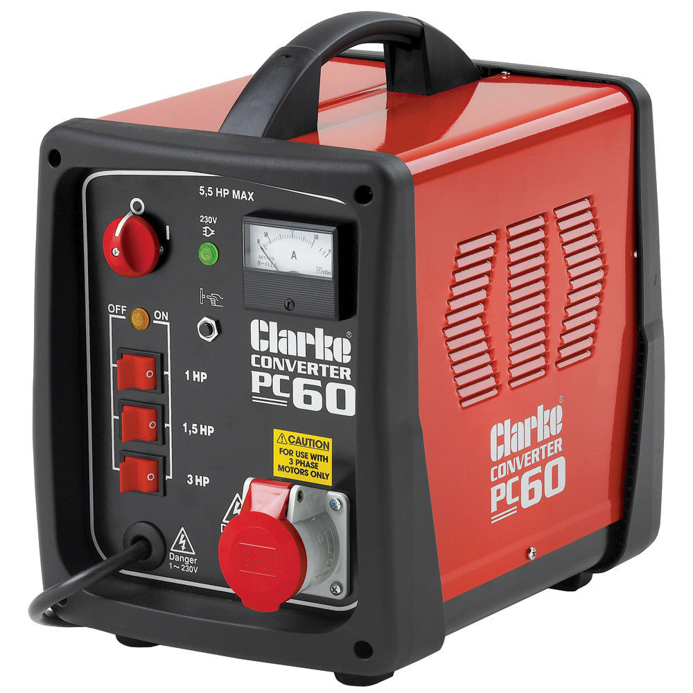

Id aslo suggest a static phase convertor, but if its the two speed motor youll get the lower speeds running fine but higher speeds will be a pain switching the capacitance about for each speed. In which case use an extra motor and go rotary.
Transwave are very helpful with phase convertors. An oversized convertor is best, to allow for the starting current
