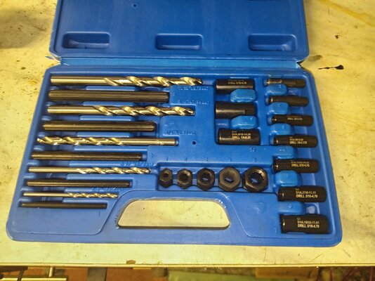

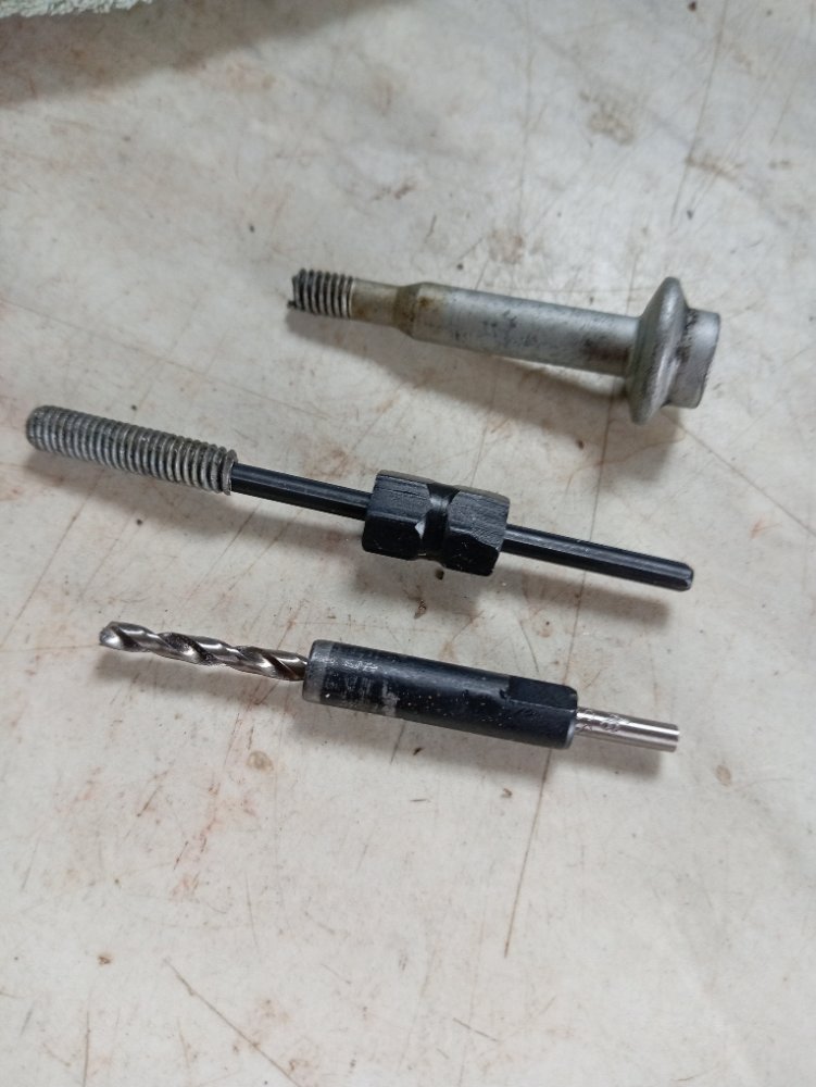

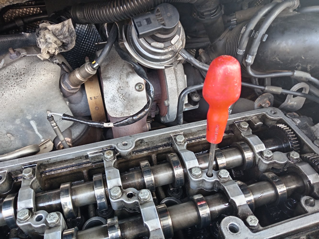

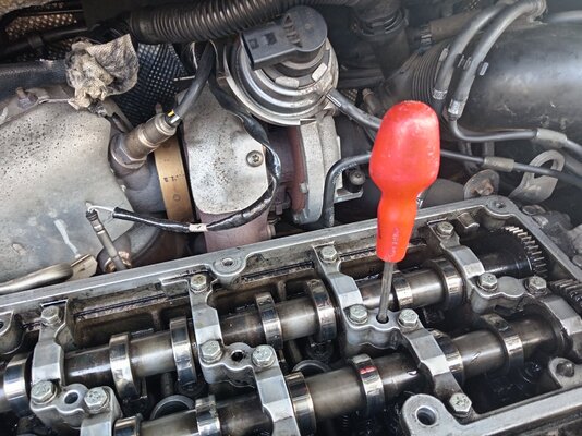

This kit is great for extracting snapped bolts in side parts...hi guys thread revisited ..
i had a snapped injector bolt,
i've drilled and got it out...
rebuilt every thing new washers seals etc,
not expensive,
now I'm at the point of tightening the stretch bolts ..
and need advice
there are various settings out there ,
8nm and 180 deg
8nm and 270 deg...
these bolts are 6mm and look delicate ...

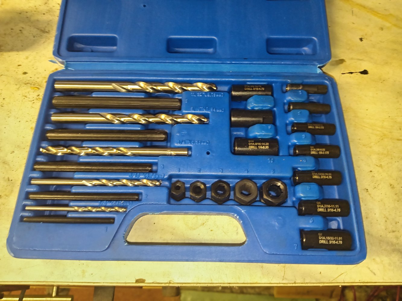

Link to a supplier please.This kit is great for extracting snapped bolts in side parts...
Sounds good...Not the same kit, but has the same function.
Facom part 885
I did 8nm and 180 ish on mine, did not dare any more.
No problems with leaking or such things for 60k miles

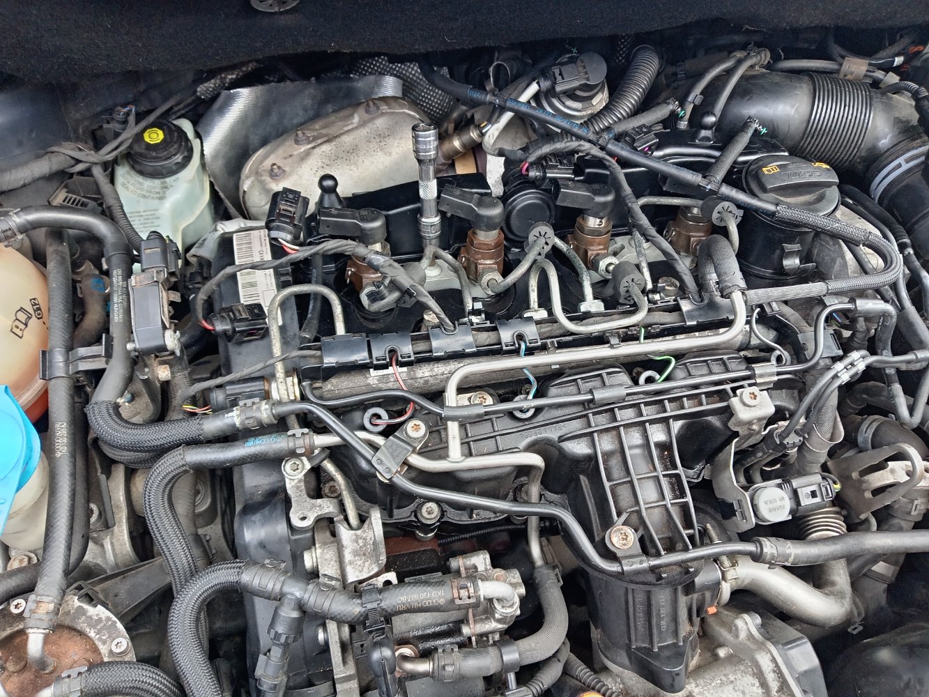

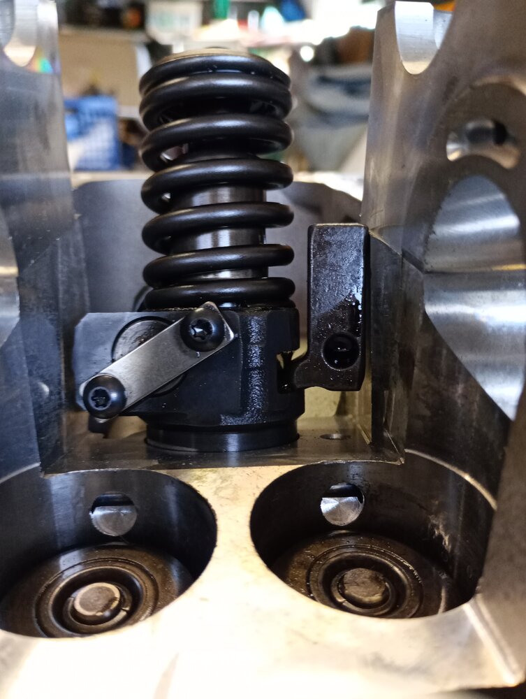

That's on a different engine.I fitted a new head to my 2.5 PD van (AXE engine code) a few months ago and the injector clamping bolt in the VW manual was listed as -
5 - Clamping block 6 - Bolt ❑ Renew after removal ❑ 12 Nm + 270°

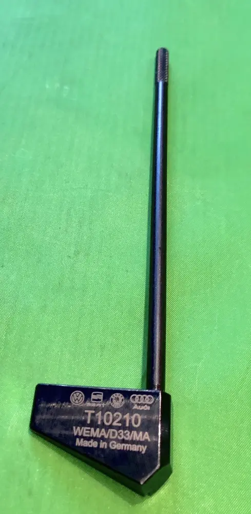

I never got it to 270° in fact I stopped at 180°. The size of bolt and application made every one of my 'don't do it' senses jangle all the way down to my right arm which refused the instruction to turn the already creaking bolt further! Have you aligned the injectors on yours? I didn't have VW tool T10210 so I made a similar but crude tool taken from the original positions of the injectors. I see that on some vehicles a measurement from the edge of the head is used for this using a giant pair of calliper's. I found that two of my (original) injectors had turned quite a bit in the old (original) head and it had been running fine and VCDS was showing no differences in the live data for the injectors. Mine is the fun but notorious gear driven 2.5 174ps engine so I couldn't vouch for the spec's on another PD.
Yea that's mine..That's on a different engine.
The 1.6 tdi uses 1 clamp to hold 2 injectors (something to do with the upwards momentum of the injectors cancelling out each other) and I do not think you can rotate the injectors at all, maybe 1 or 2 degrees, the slot in the clamp is a tight fit over the 2 flat sides on each injector. (You can probably fit the injectors 180 degrees off, but that way the diesel return pipe will never fit, as the hard pipes are bent in a certain way to reach the run off fitting on the injector) and as one would usually fit new copper burn rings on an injector I don't think mounting them in exactly the same position is adamant.
Just to correct my earlier 'from memory' tightening sequence, the VW 1.6 TDI is:-
8Nm + 270 degrees
VW 2.0 TDI is:-
8Nm + 180 degrees
These are from the WIS on ELSA Pro this time, not memory!
Yes, mine only has a single bolt. it can move about 30 degrees in the slot. Just in case anyone comes across this, it has this tool to align it. The fuel goes through a gallery in the head direcly into the injectors.That's on a different engine.

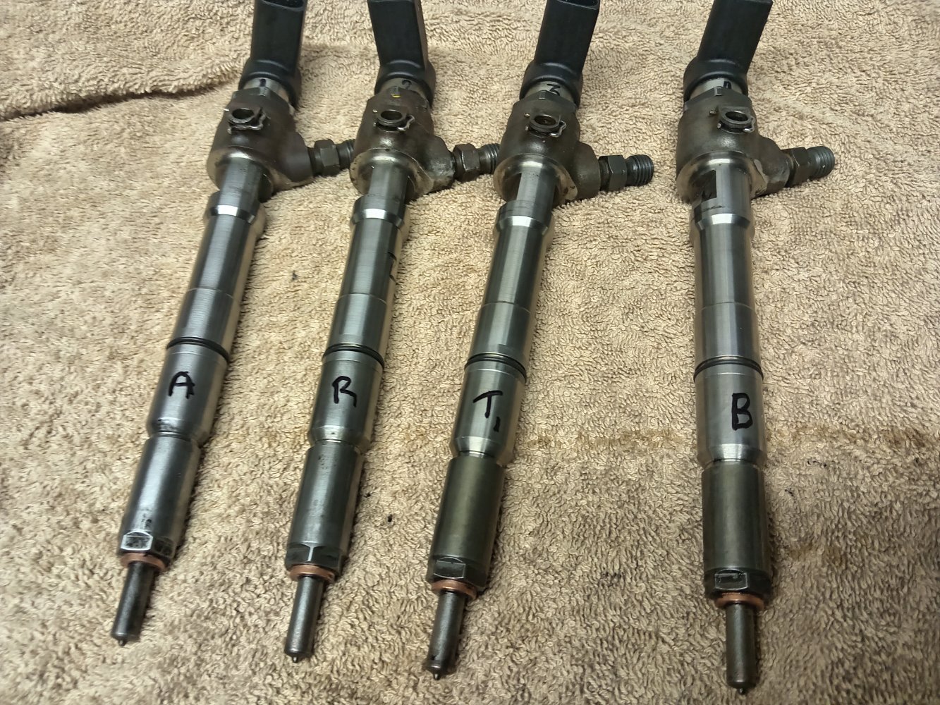

I've done mine.. TodayNot the same kit, but has the same function.
Facom part 885

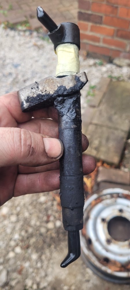

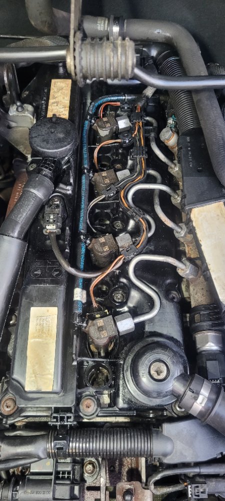

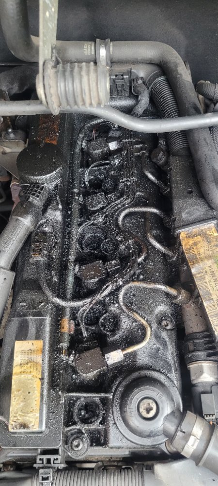

A messy one..Just done my om651 sprinter ones,
Noticed some black death on a service so cleaned it all up and recut seats , installed new seals and clamp bolts and it's as good as new up to now.
