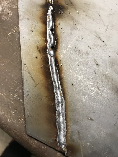

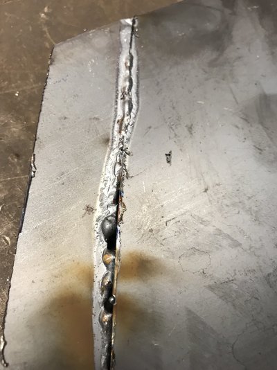

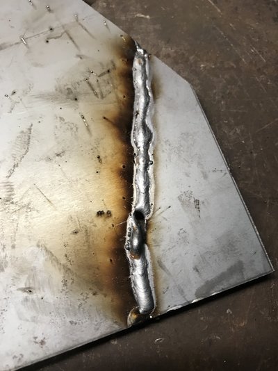

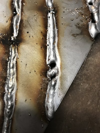

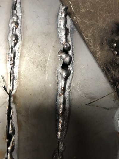

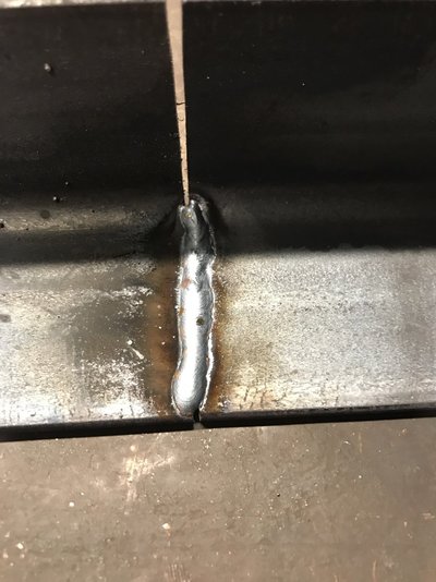

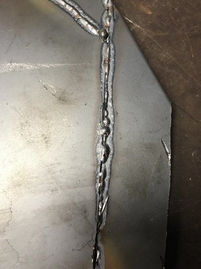

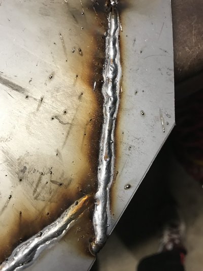

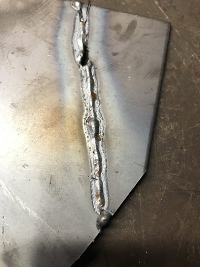

With thin stuff, dont try to do it all in one run, stop, allow to cool a bit, then restart. Also aids stability when welding as you can reposition your self, so you can see what is happening all the time.
With your angle champher where your going to weld at the joint.
