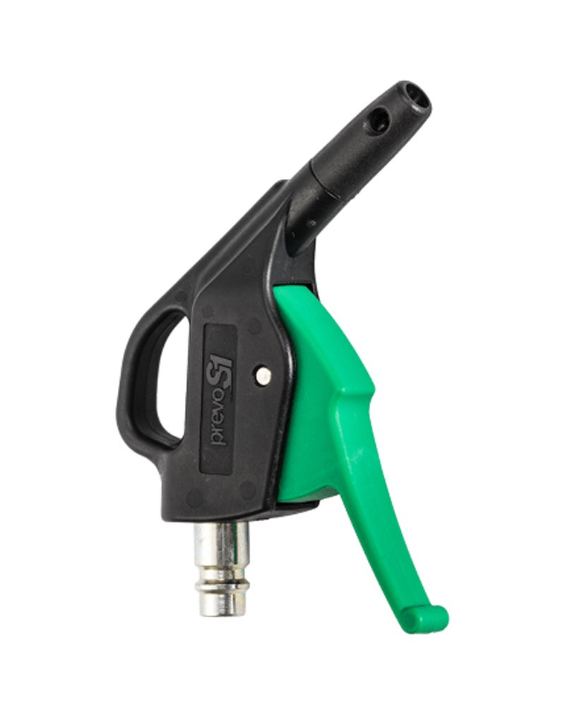

The Prevost couplings you mention are really nice, they are expensive but from a safety point of view they are the best.
