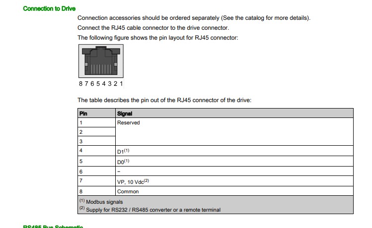

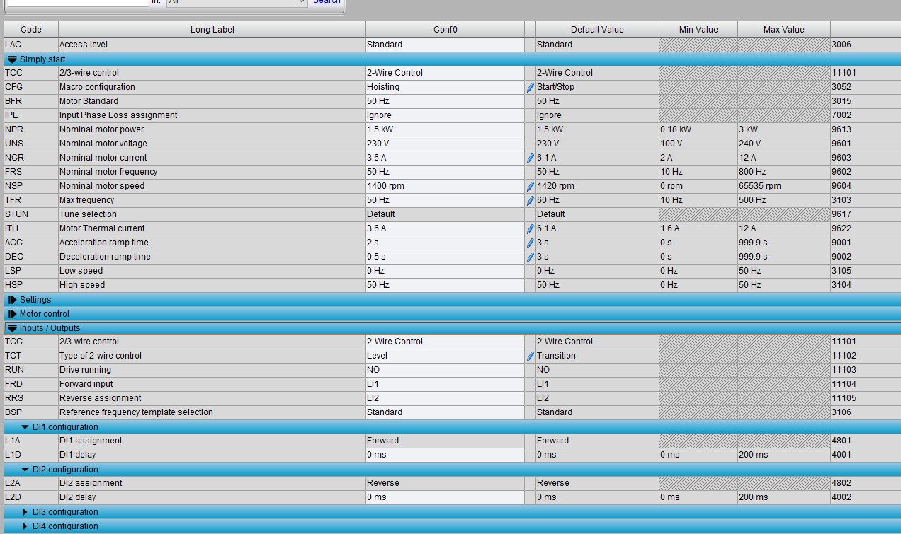

The Schneider drive looks good, seem to have managed to set all relevant parameters in the software and just looked at the serial connection, seems it is the same as my Lexium drives so if I am seeing it right I won't have to go hunting for the adapters, well that is assuming it will fit in the space available and that they go for the Schneider if it does. Over double the price of the Delta and just under double of the Optidrive so we will see.

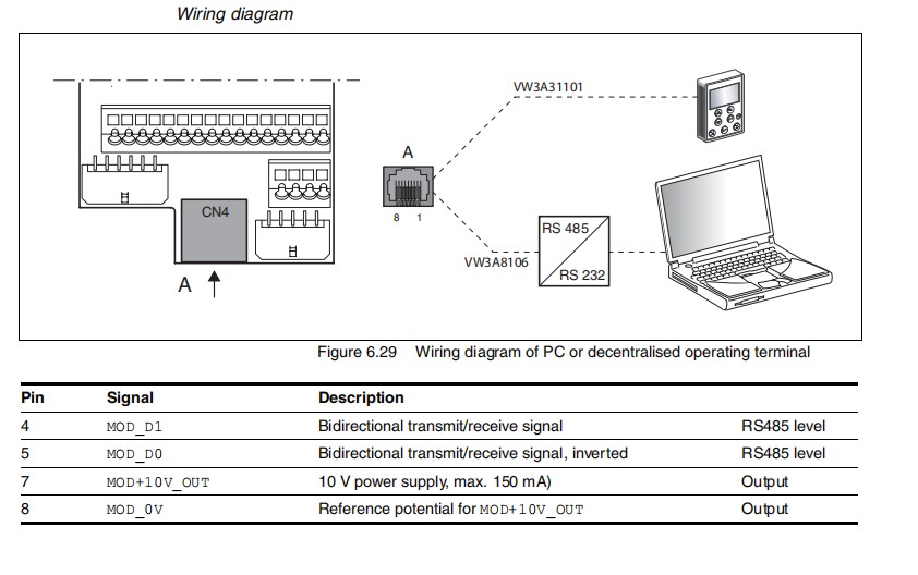

Anyway Lexium drives connection.
And Altivar 320
