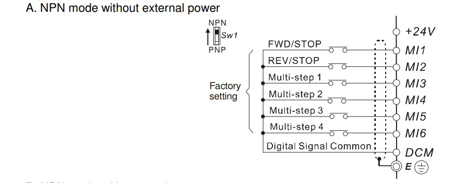

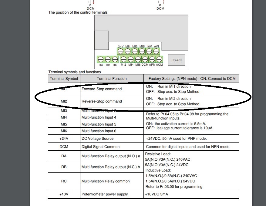

I am wondering what is normal for a VFD controlled by momentary buttons on the digital inputs.
For example if I have input 1 on a VFD connected to a momentary normally open button and I set it up for Run Forward will it run when pressed and stop when released?
