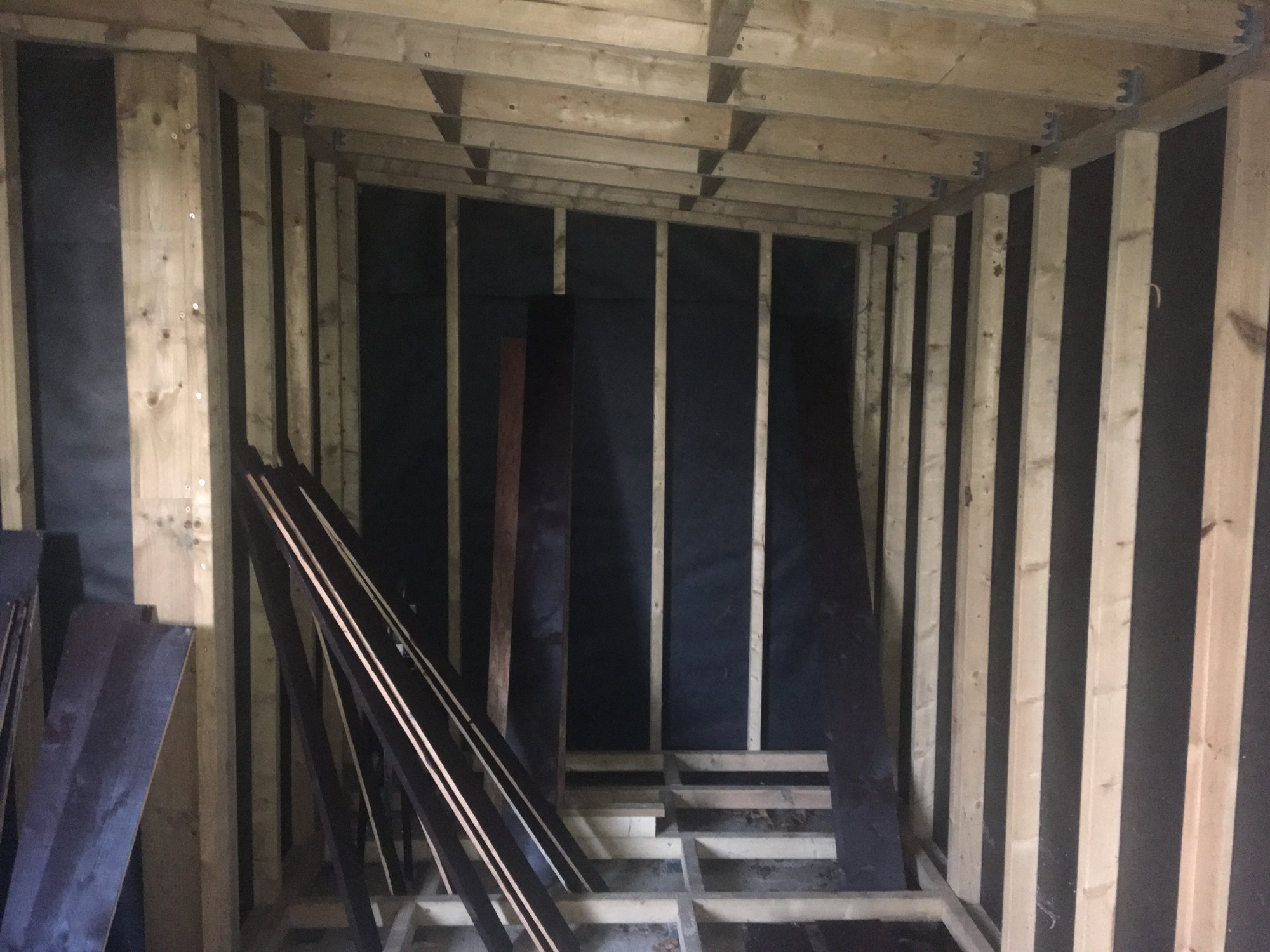

A couple of pictures hope this clears things up a bit
View attachment 196205 View attachment 196206 View attachment 196207

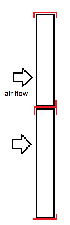

Not sure if this will help

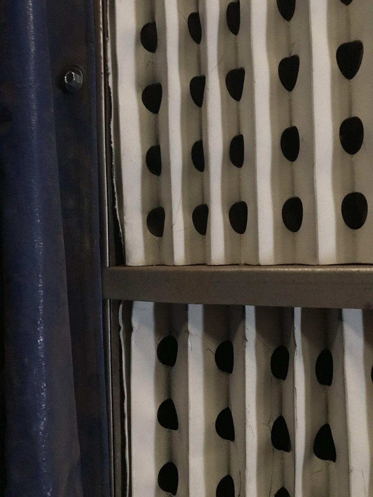

For the exhaust pleated filter, if the filter is going to be mounted vertically then its possible to have a channel covering the top of the filter and a support at the bottom if you then mount one above the other it just the same process.
Filter in black and frame in red
I'm toying with the idea of this ready made item for G3 type filters which might offer a better sealing https://www.justfans.co.uk/duct-mou...MI59nH1-ul5QIVi7TtCh2HoQt3EAQYBSABEgKyffD_BwEi see ...what are planning to paint in this shed?
