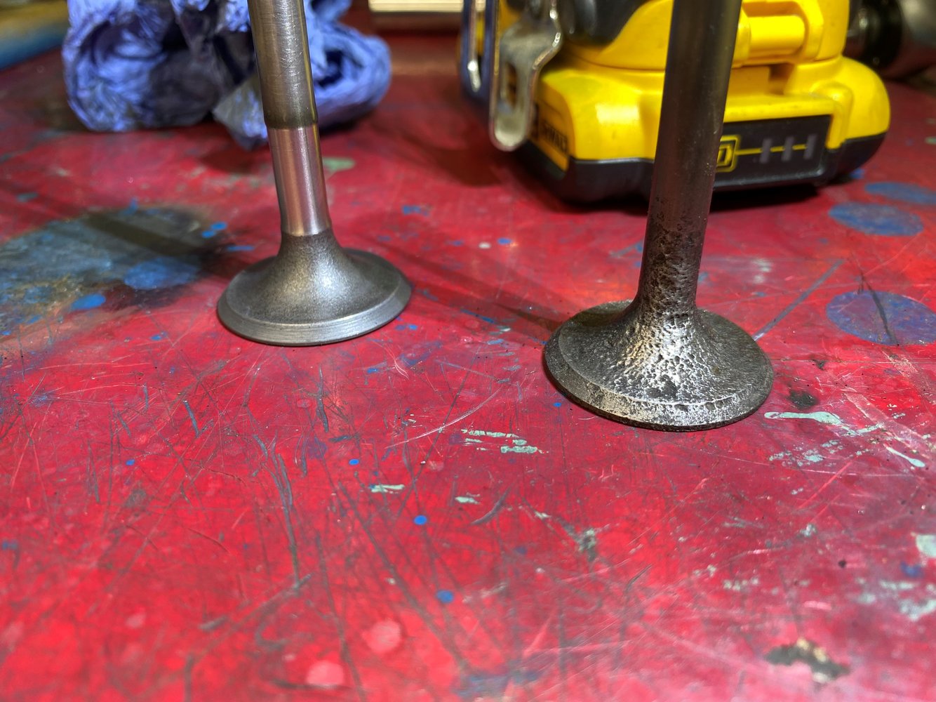

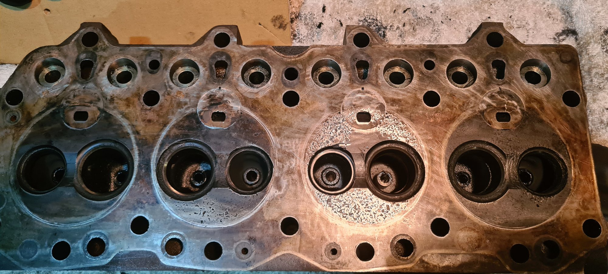

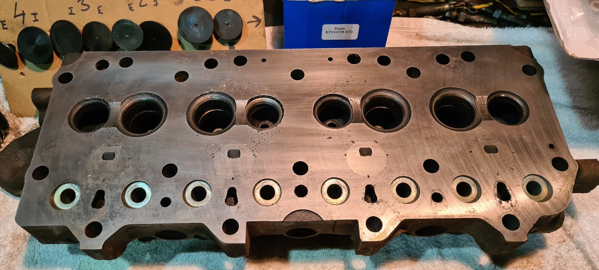

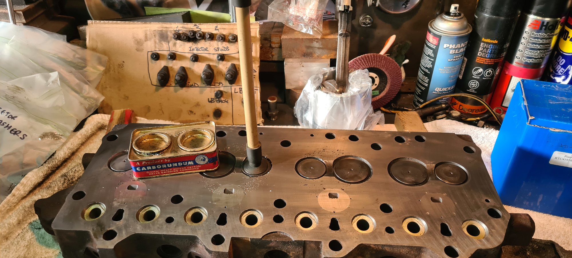

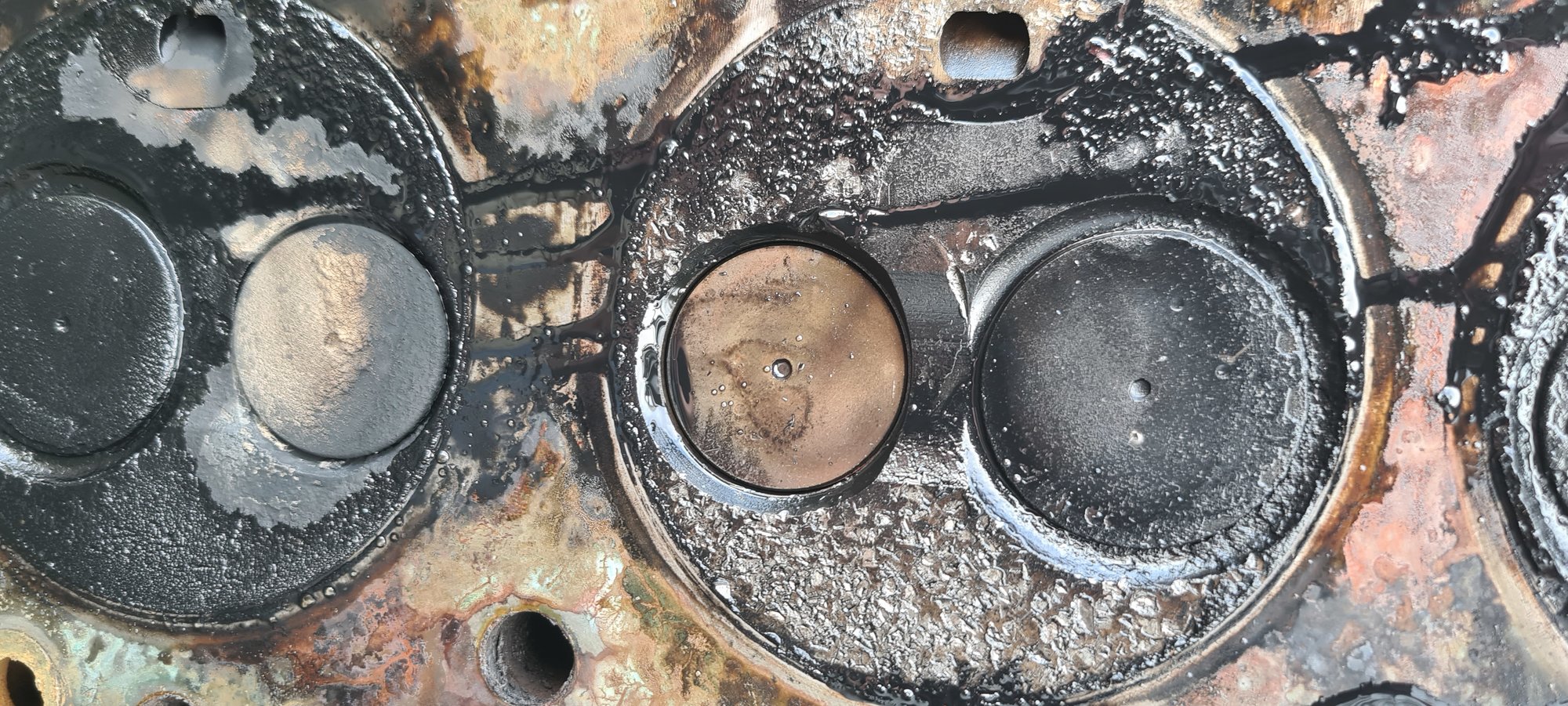

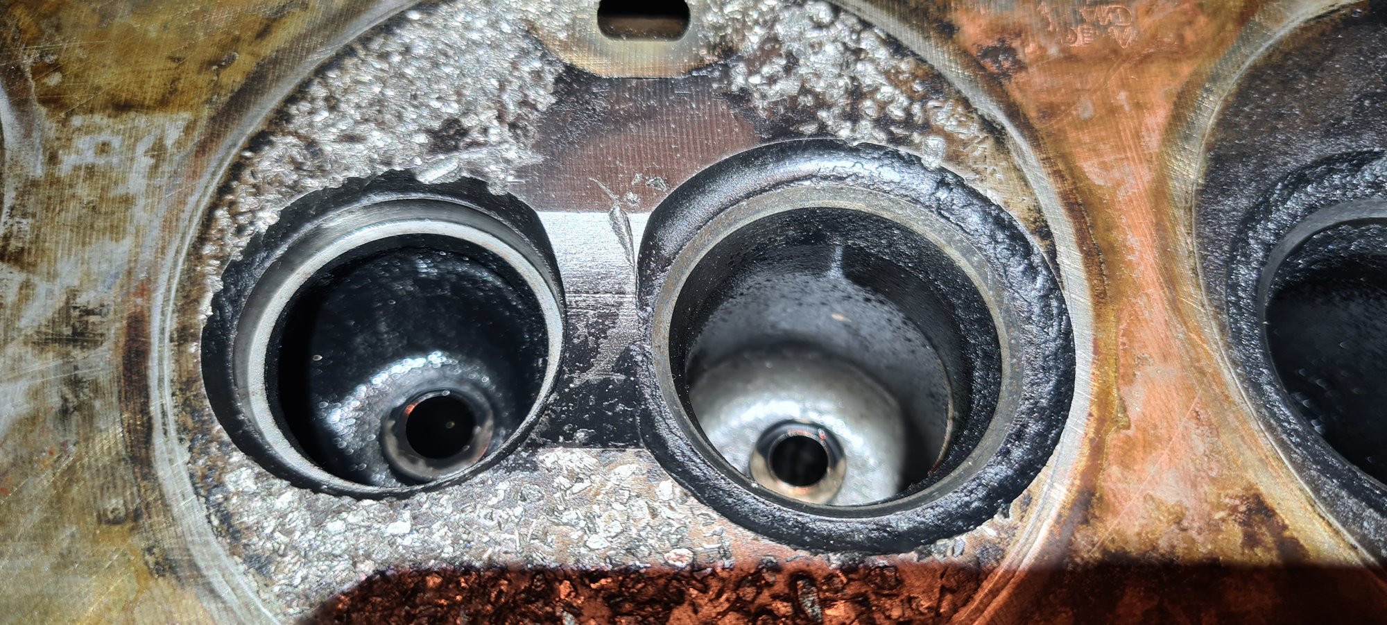

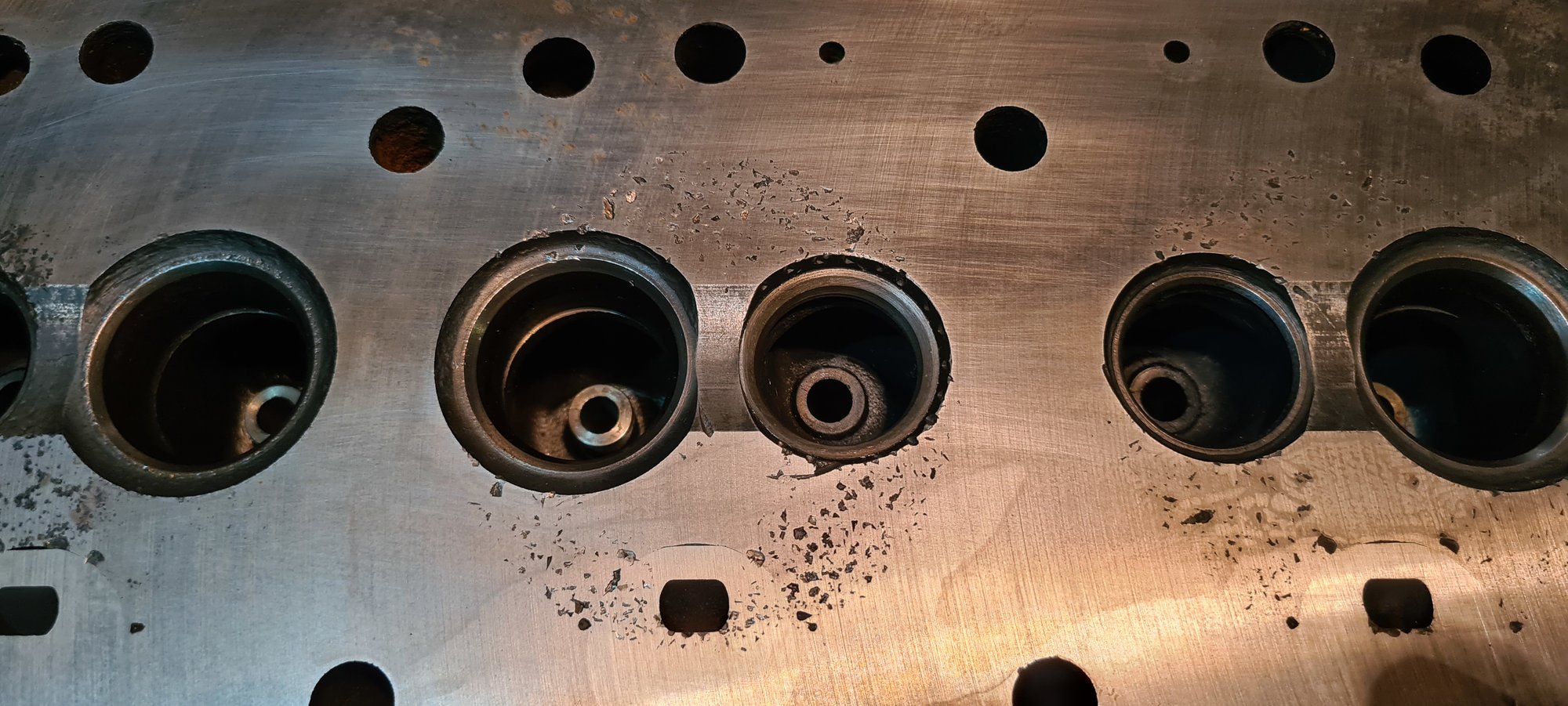

The valves in this little Perkins 3 cylinder, especially the exhaust valves, were very pitted so I have changed all the valves and lapped them in.
The condition of the valves was much worse than the seats.

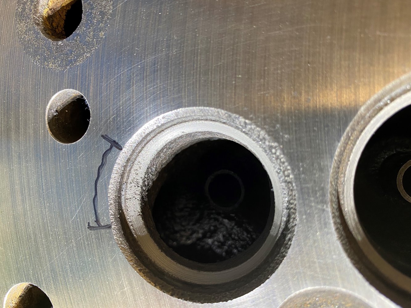

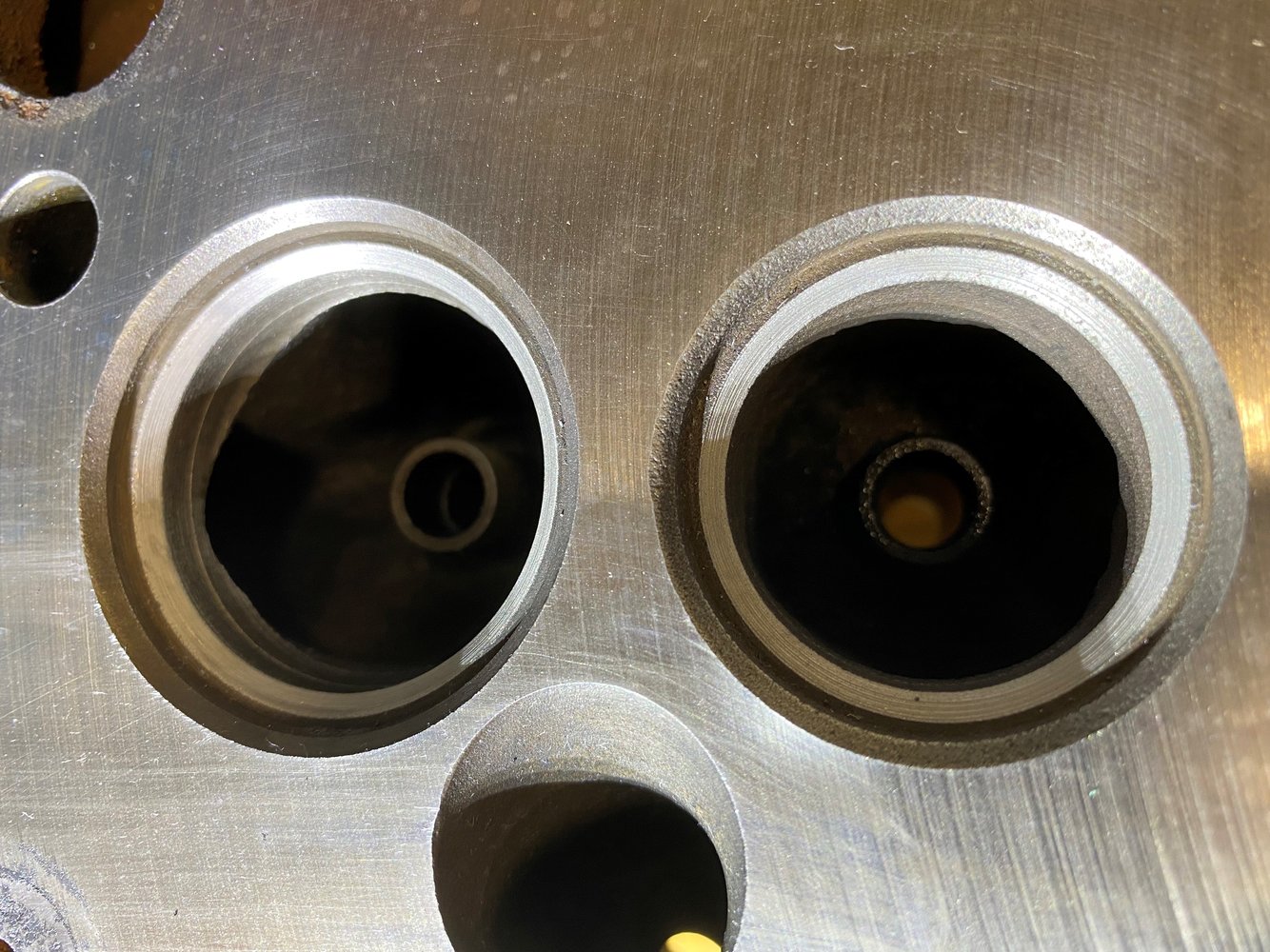

All but one are perfect after lapping an honing except one. I have marked where the pitting remains but it is quite deep, if i continue to lap until its gone the valve will end up too deep.
As it is now when I put the valve in, it seals and holds water.
Does it matter?
Does it matter?
