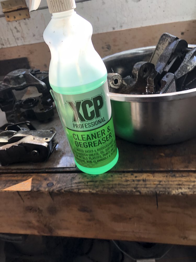

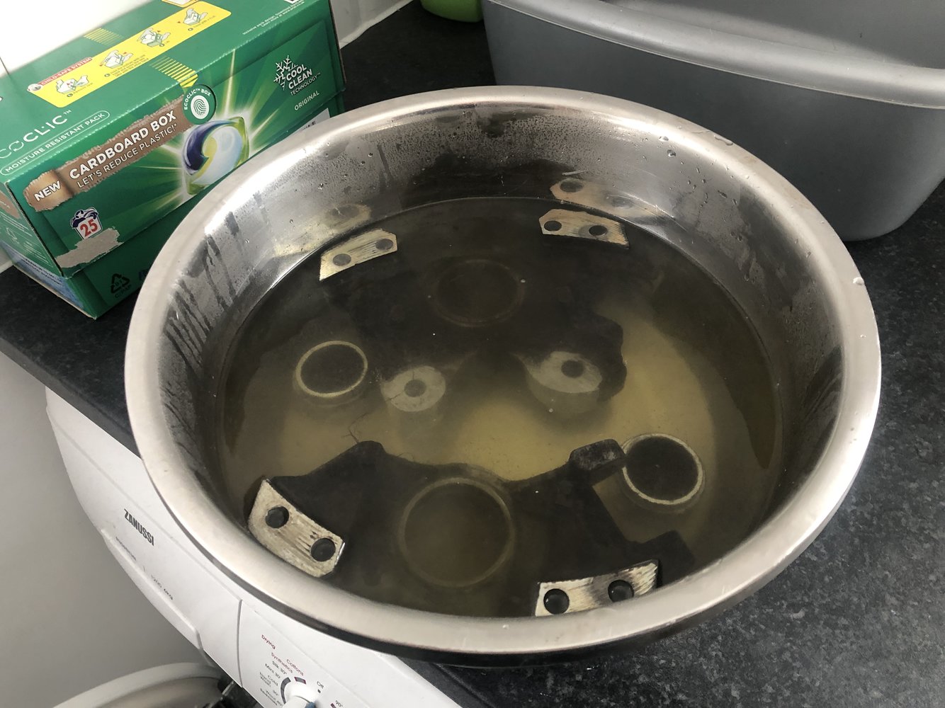

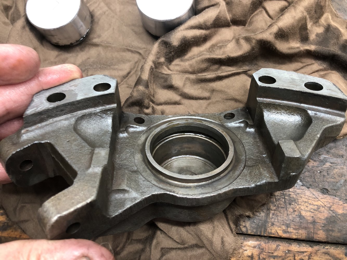

That's what I use it in, along with the steam cleaner and neat as a brush on before a rinse.Another vote for the Screwfix degreaser. I use it in my heated ultrasonic bath, works great.

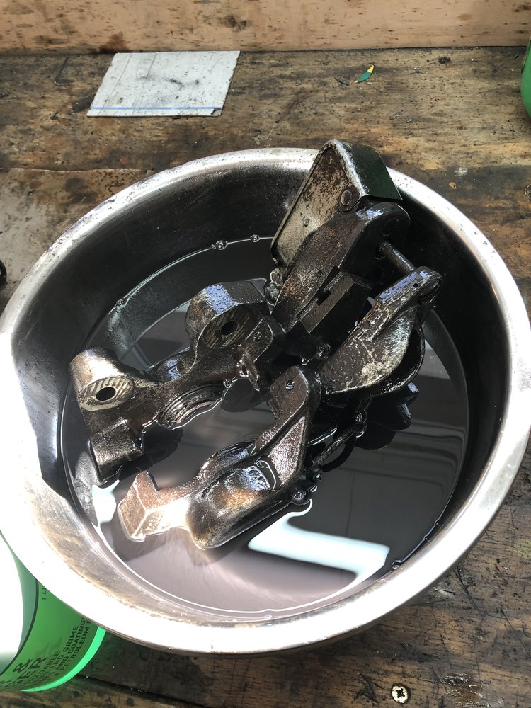

I might put the stainless bowl on the cooker tomorrow, if it's not shifted the grease and goop as much as hoped.The screwfix 'no nonsense' degreaser does work well and you can dilute it a fair bit without it having any noticeable effect on its cleaning capabilities. Worth noting that it works even faster if the liquid is heated, and don't leave any aluminium/alloy in it overnight as it tarnishes.
It doesn't need to be hot, I find as long as it's ten degrees or thereabouts above room temp it makes a noticeable difference in the time it takes.I might put the stainless bowl on the cooker tomorrow, if it's not shifted the grease and goop as much as hoped.
Just been out for a look, after 3 hours soaking, gunge has literally dropped off in many places and the plated parts are looking pretty clean and tidy now. Looks very promising.It doesn't need to be hot, I find as long as it's ten degrees or thereabouts above room temp it makes a noticeable difference in the time it takes.

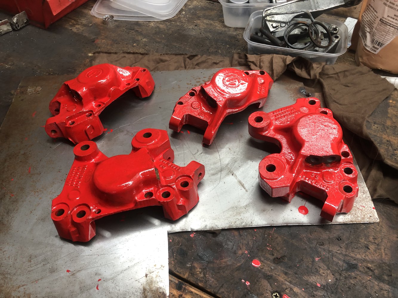

Yes, they're £47 each, but mine seem in perfect condition. It's tempting to get the reman calipers but I've put a days graft into these so far and they seem in perfect condition once the grease and surface rust are gone. They'll need painting though.That doesn't include the brake mechanism it's separate for them
Ref The holed bucket. The guy to help you has just died but you could always try "Liza"I thought i'd have a go at cleaning up the old Jag brake calipers I achieved last year. They're caked with grime, so I drug out a bottle of super duper Halfrauds degreaser and started spraying and brushing with my toothbrush.....then I left it all overnight with a good spray of the stuff
Result: Worthless! It hasn't touched any of the grease, not even softened it up. Water would work just as good.
I found of gallon of diesel in the shed and put it in a bucket, to soak my caliper parts.
Then I noticed the bench was wet, well, soaked, with diesel, and the floor... There's a hole in my bucket... ..... so I rushed into the kitchen and found two stainless cake mixing bowls.
Excellent.

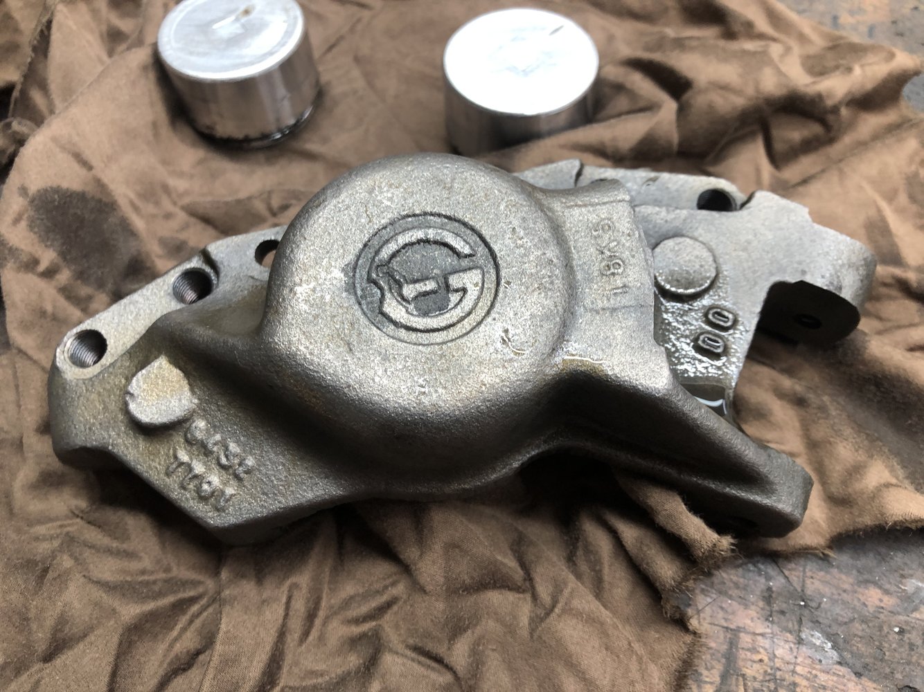

Once cleaned I'll pop the pistons out and check the bores, see about a rebuild set. Or ,
maybe see how much reconditioned ones are.
Eta: I was just about to go buy another gallon of diesel, to soak them in, but saw Screwfix degreaser recommended on another thread, so I've order a gallon of that, to collect today, £11. Hardly much more than diesel would be.....
I was too impatient to order online so I hit up Halfords yesterday.I was recommended this from somewhere ? other colours are available and even after 2 coats on the front jag caliper,s i had enough 3/4 of a tin left !
