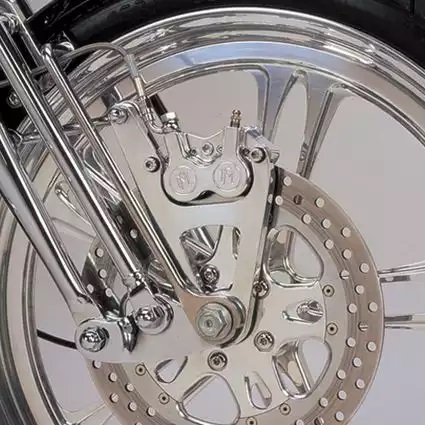

That's the plan, caliper bracket that floats round the spindle, with a tie rod to the rear fork leg. I just need to sort out the disc itself so I can make the rest to match. I don't think a Harley disc would be man enough for this, I'll get one made the biggest diameter I can squeeze in.Hello, are you looking at Harley Springer forks
there you can see how the brake should be mounted. Harley brake discs are available in 10 and 11.5 inches
