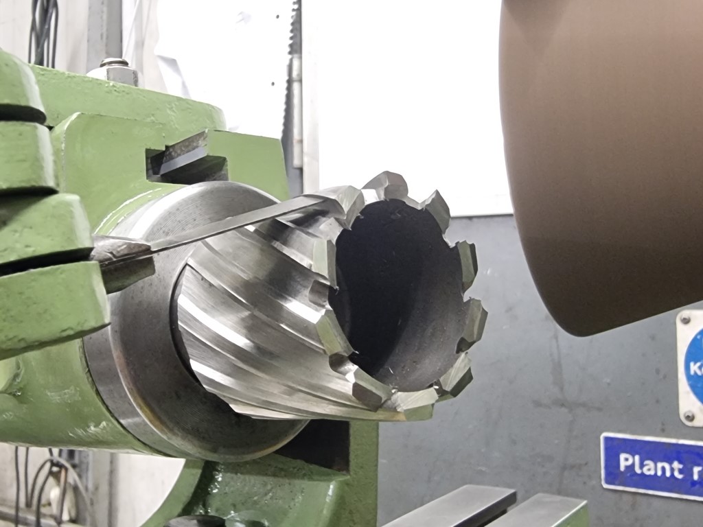

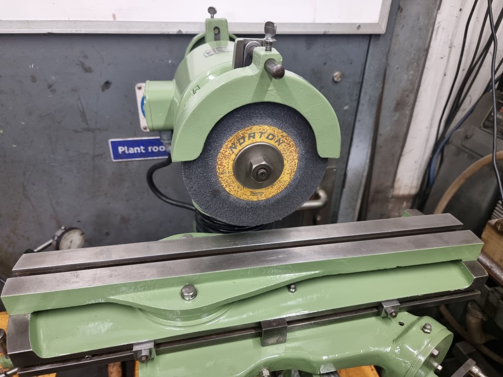

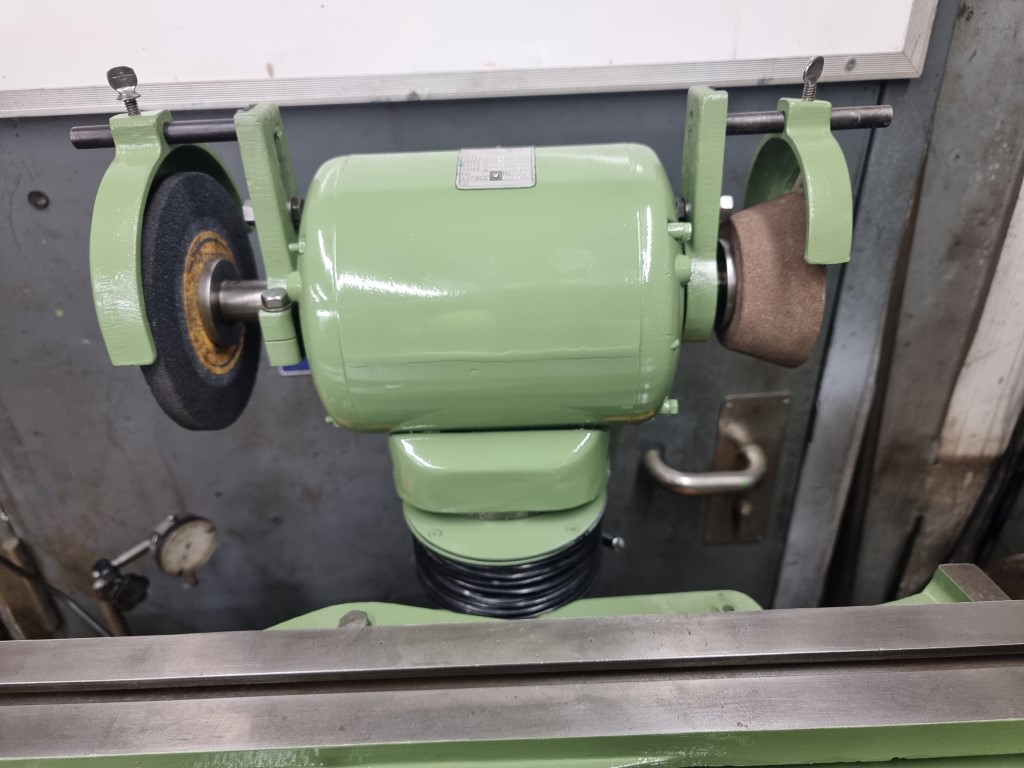

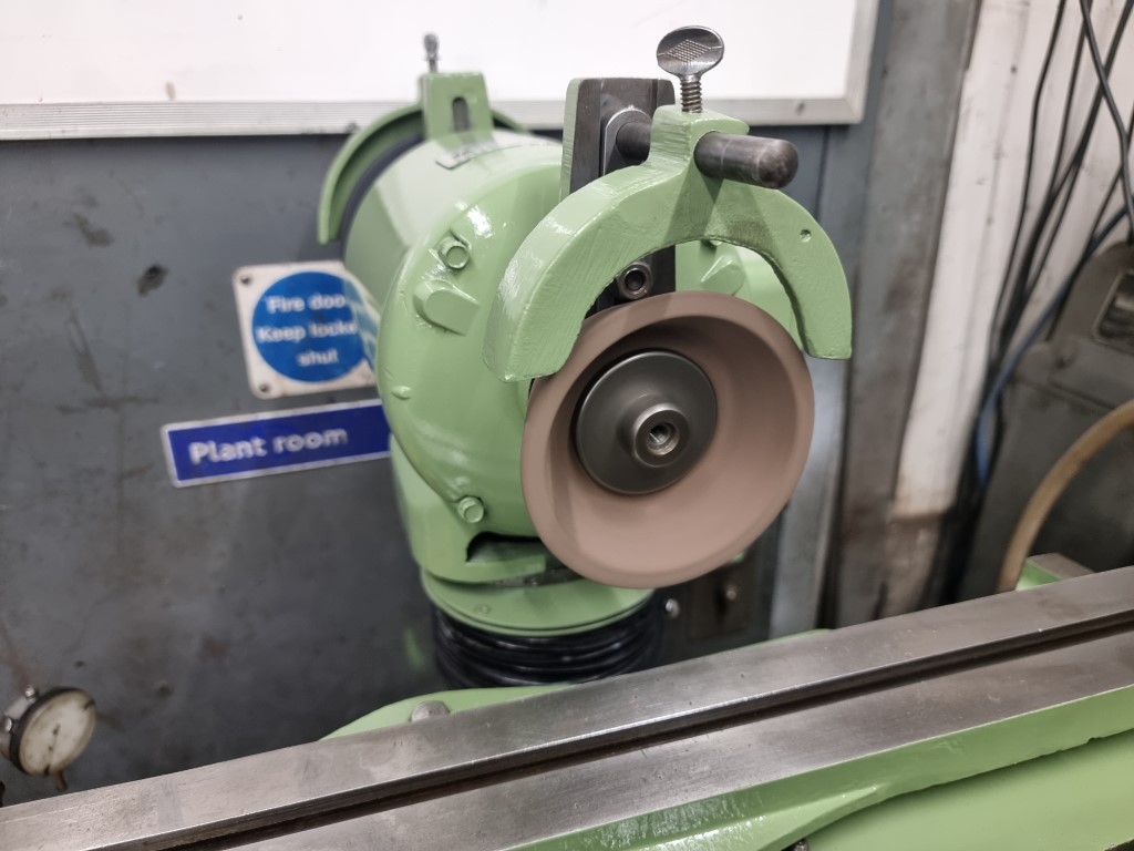

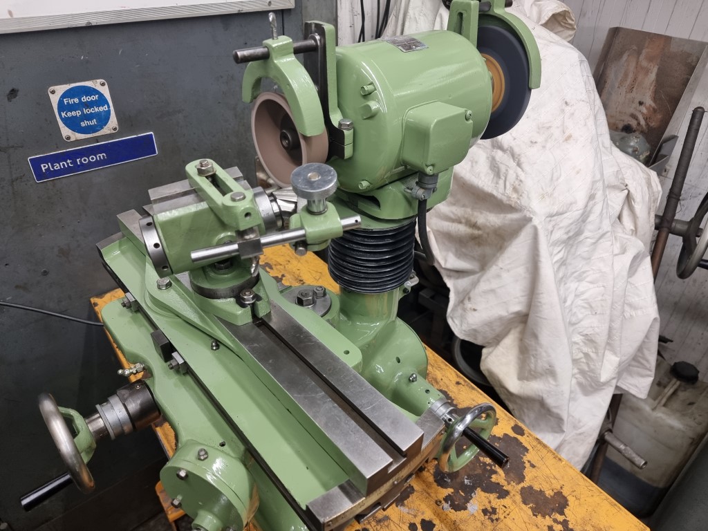

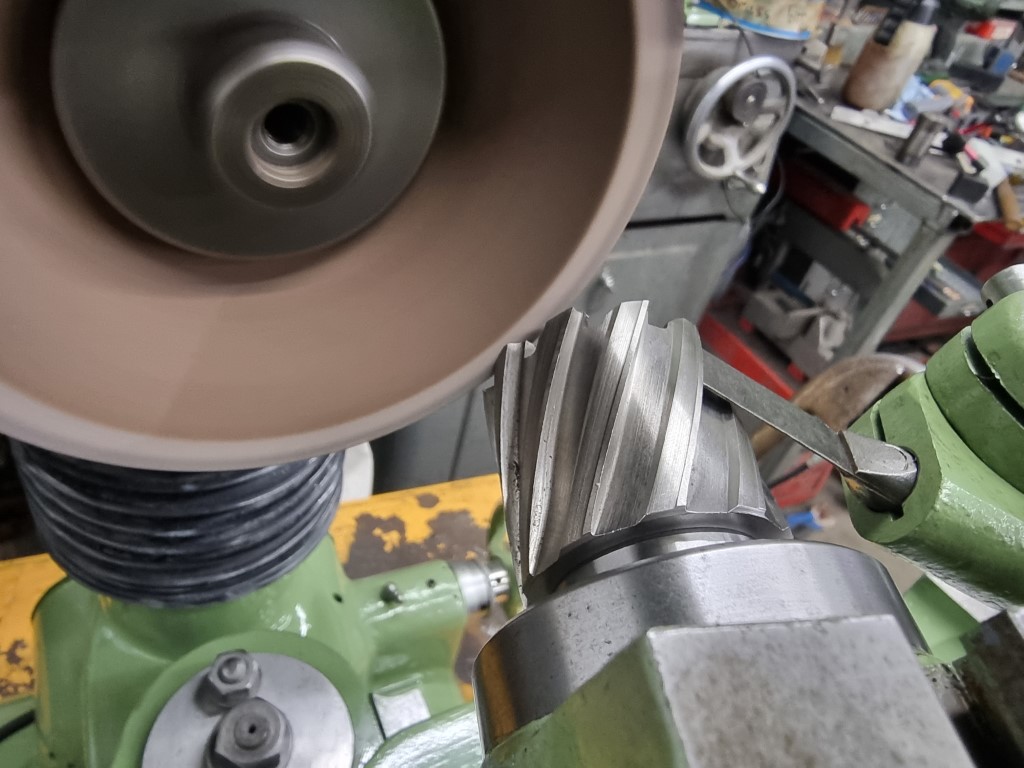

It'll be a nice little T&C grinder. I have one myself that I bought primarily to sharpen horizontal milling cutters. Mine came with the base cabinet.

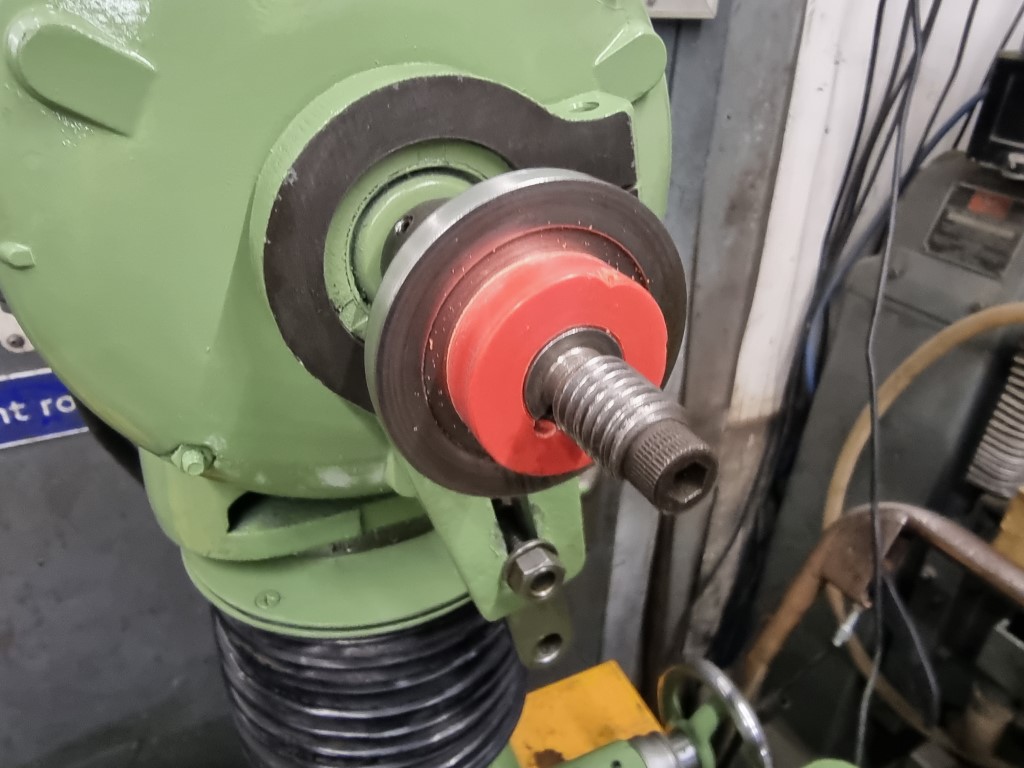

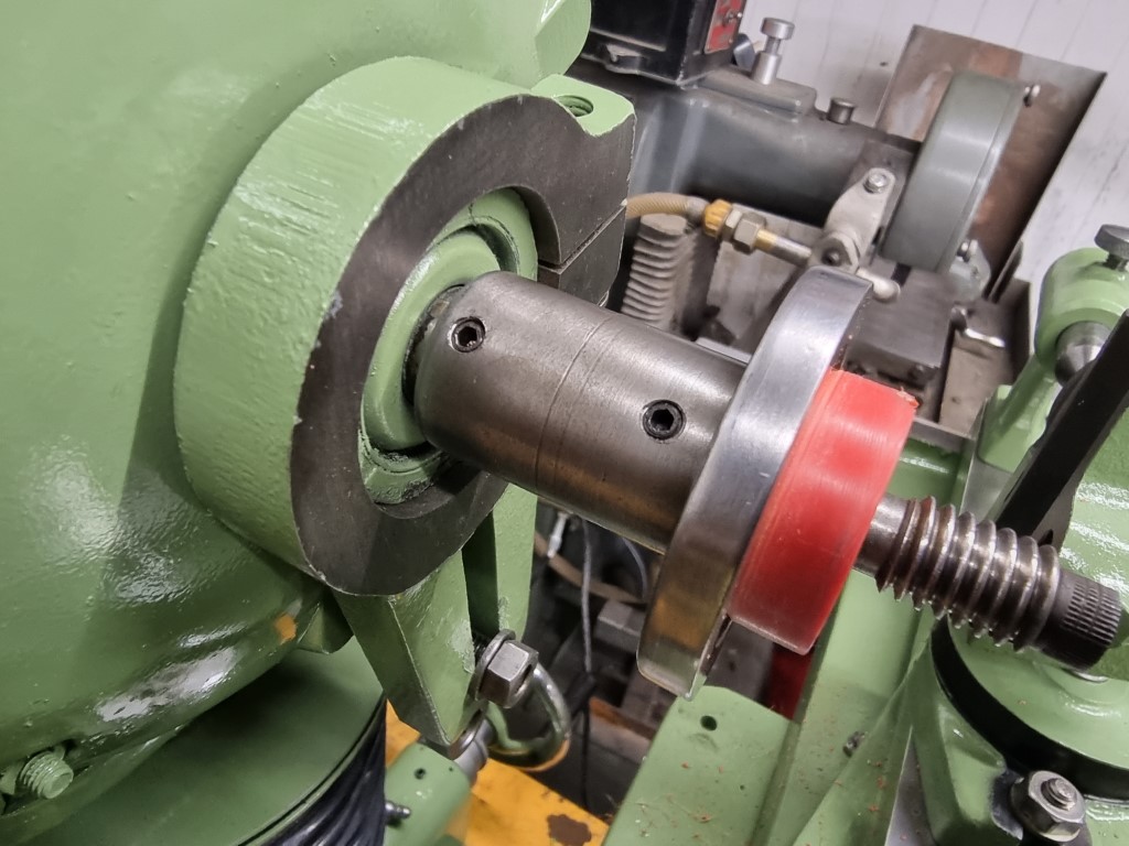

The one thing I'm not so keen on is the motor spindle being used to hold the grinding wheel. Despite changing the motor bearings it appears mine has a slight bend in the shaft which can result in unwanted vibration.

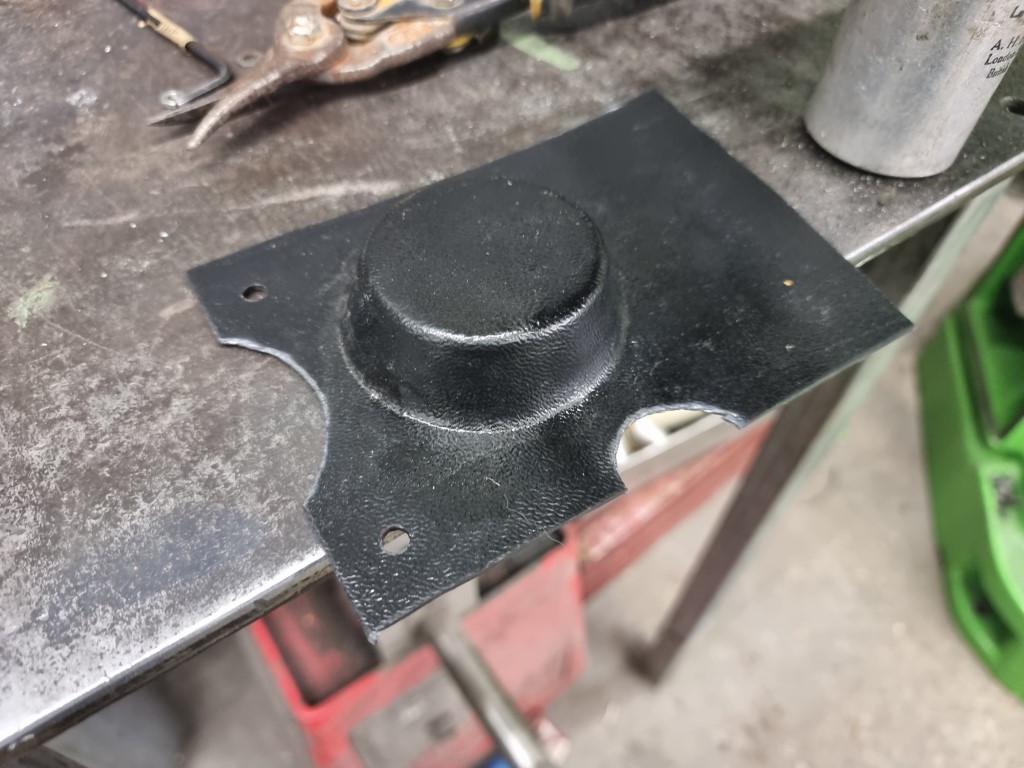

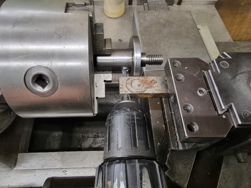

how did you form it. that looks well handy, especially if it's electrically insulate.

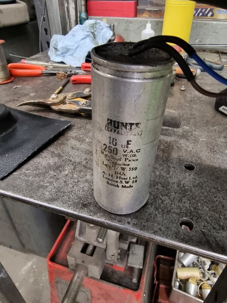

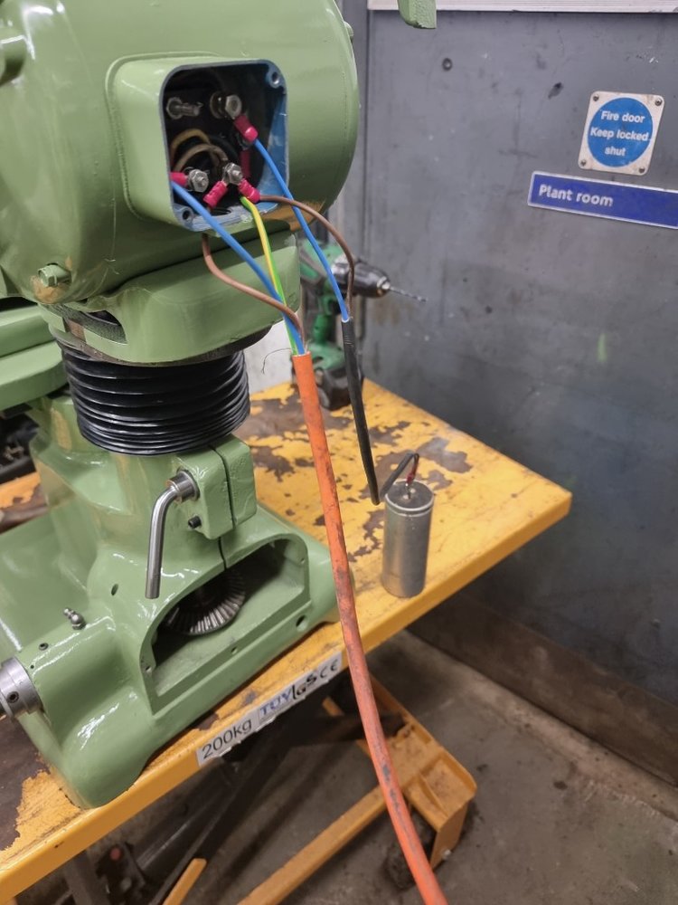

Hunt's? Blimey, that's an antique.The cap would only fit up inside the body standing vertically and that would leave the terminals exposed under the base as it stuck out
