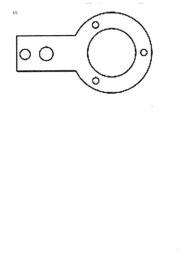

That's great - thanks!Something like this bolted to the bench/solid item and then the outer sleeve, allows bars/tubes stillsons as required and heating while mounted...The ali or bronze will expand faster than the steel, plus once it's hot you could lift a bucket of water/oil/diesel up to cover the lower threaded part causing it a contract slightly it all helps breaking free the threaded part, heat cycling and soaking is the key here, patience is an absolute must....

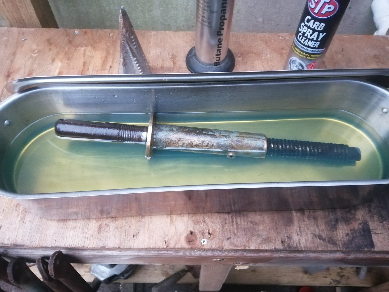

Meanwhile - about 30 years ago, we bought mum and dad a fish kettle for Christmas. They died and it found its way into my house. Today, we unwrapped it (completely unused) and finally found a use for it. :-) Soaking in diesel, til we get a mount made...

Very relevant.Thanks both. Not sure if my correction from ally to bronze (post 9) is relevant, but we'll keep working at it today trying all the above. Then it's into a bath of some for a good while sort to see where that leads!

@awemawson had exactly this problem with his 60 tonne press. He soaked the screw thread and bronze nuts in citric acid for several weeks and they just came loose. His was in much worse condition than yours.OK, thanks all. We'll have a go at immersing it in diesel for a couple of days; if that doesn't help, we'll try the heat cycle with diesel and oil.

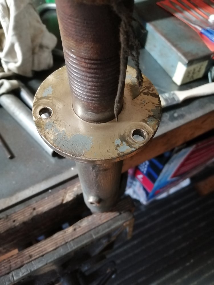

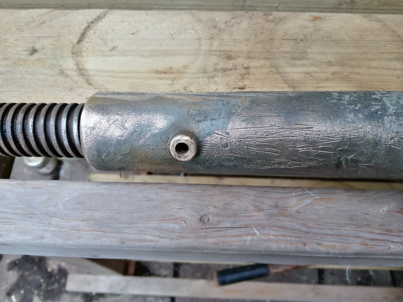

I started cleaning the exposed threads as per yours, @zzr1200 , and rather than ally, the whole sleeve looks to be bronze. Does that change anything? (Not sure the colour will show properly in the pics.)
