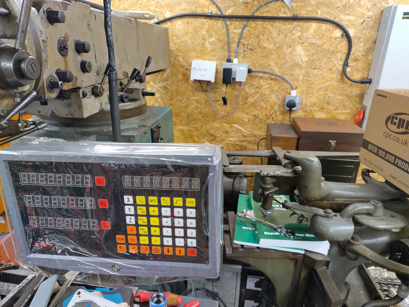

No, even one is too much.Most likely the extra demand of the 3 Heidenhain EXE 610's is to much
Will it work with just one input plugged in?
Yeah, my assumption is that there's the potential to damage diodes and transistors that have been designed to deal with just enough current to do their job.The first option would be the best. Generally best not to add multiple power supplies in parallel, particularly when you don't know what the internal circuitry is.
The counter and third sino scale works just fine together, plug the Heidenhain ones in and it dies temporarily.Heidenhain bulbs are said to be run at half voltage so they last years (40) I assume that's done in the read head due the 5v listed on the pin outs, but .............
Devils advocate bit - I take it the display still works with the proper 3rd scale?
It's difficult to say without seeing the circuit board but something people forget is that electrical power can't be "pushed" into something. It's pulled by whatever needs it.Yeah, my assumption is that there's the potential to damage diodes and transistors that have been designed to deal with just enough current to do their job.
My concern was that if some components of the Heidenhain system needs that additional current to function, everything else in circuit with them is subjected to the same current.It's difficult to say without seeing the circuit board but something people forget is that electrical power can't be "pushed" into something. It's pulled by whatever needs it.
I will try to clear bench space so I can have a suitable working surface to disassemble the counter and take a look.You'll just have to open it up and take some photos to show us and we can help narrow it down.
That's what I meant - impossible to tell without opening it up. If you do open it up and find the 5V source you could buzz it through to the outputs to the scales. If it buzzes through with no resistance then you'll be safe to add a wire in parallel to take the current.My concern was that if some components of the Heidenhain system needs that additional current to function, everything else in circuit with them is subjected to the same current.
