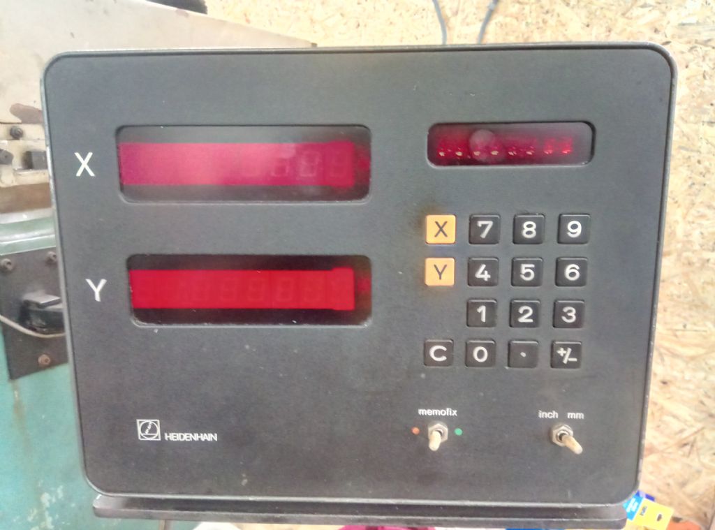

My big mill has an ancient Heidenhain DRO, which is better than nothing, but not by a lot.
I have been meaning to swap it for the "Sino" type DRO for ages, so it's standardised with everything else.
But put it off as I didn't want to spend money on new scales, to replace the old Heidenhain Sine-Wave type with modern TTL ones.
However, I managed to pick up two Heidenhain EXE 610 signal interpolators for a song the other day, which will take the old school 11μAcc sine wave signal, and convert to TTL, which makes things easier.

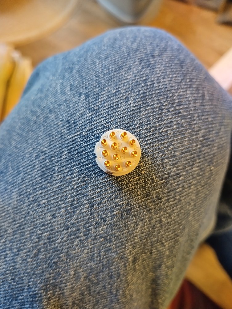

The EXE 610's TTL output goes to a GX20-12 pin round connector, according to this Pinout:

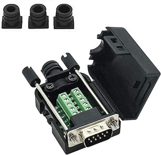

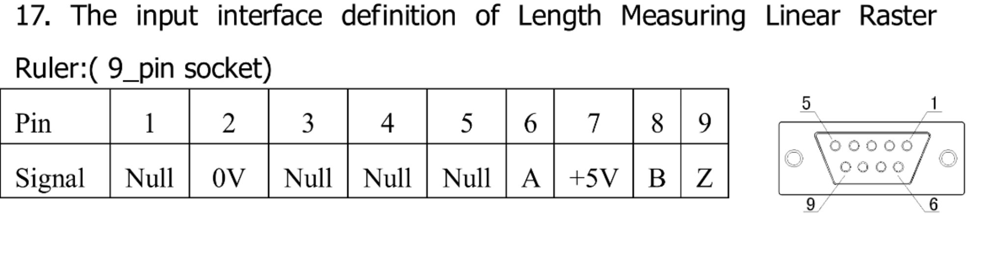

Meanwhile the Sino counter takes its input via a DB9 connector, according to this Pinout:

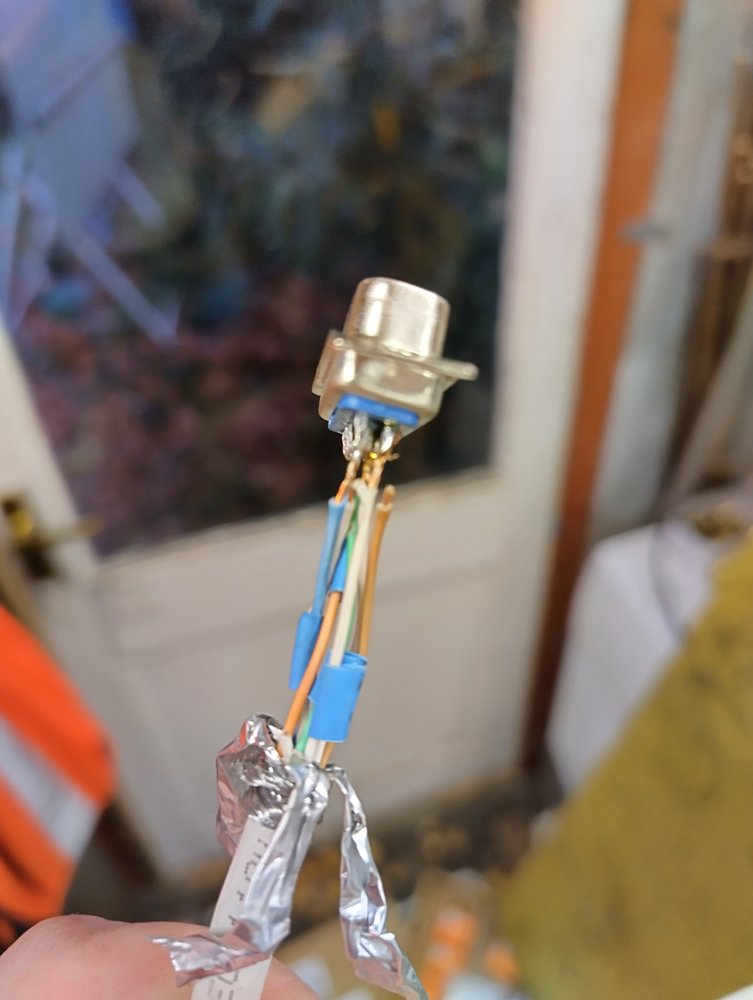

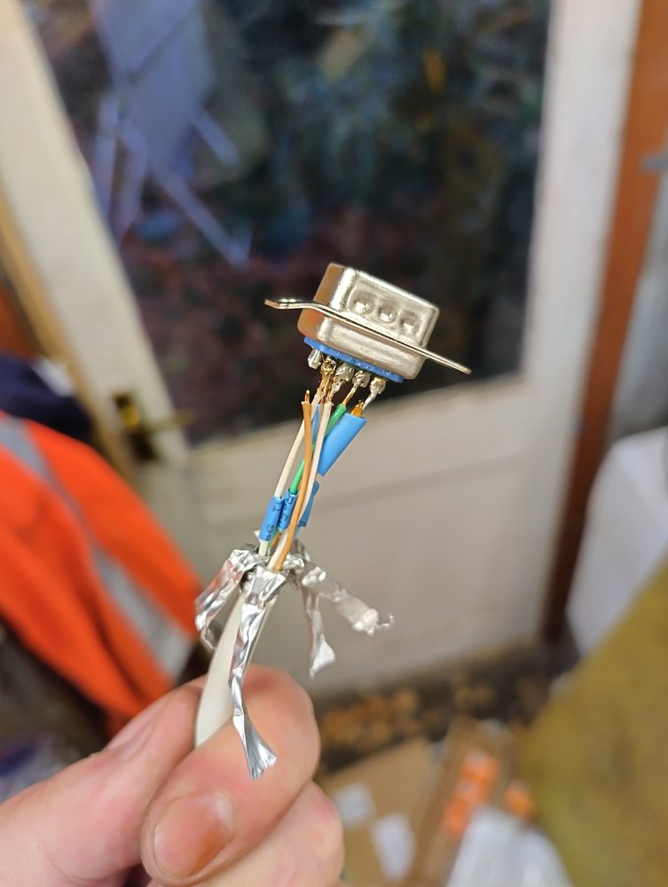

I have both the GX20 and DB9 connectors, and a reel of shielded Cat-6 cable that I can use to make up a connector lead, but can't work out how to connect them up.
Can anyone advise which pins on the Heideinhain pinout, would correspond to the A, B and Z signals for the counter?
