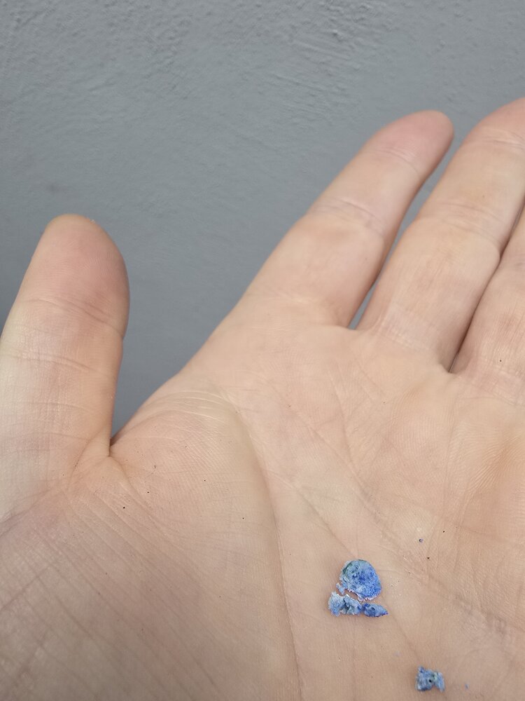

The stuff blocking it is a chalky, blue stuff. The coolant is blue. Some quite hard, some powdery, some that's wet is more of a paste.
