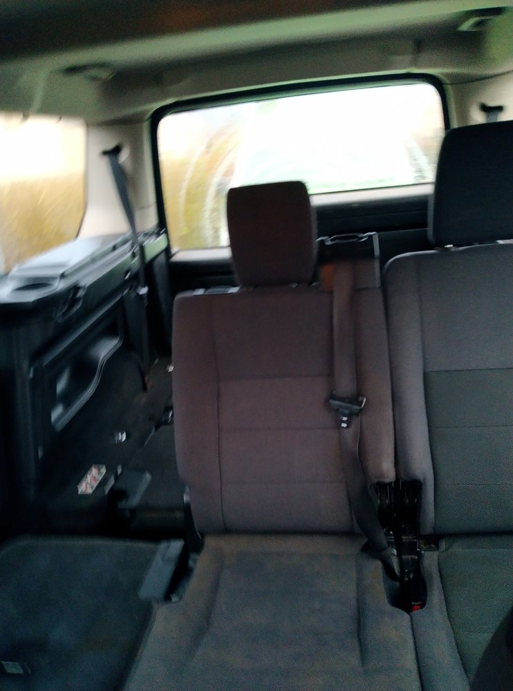

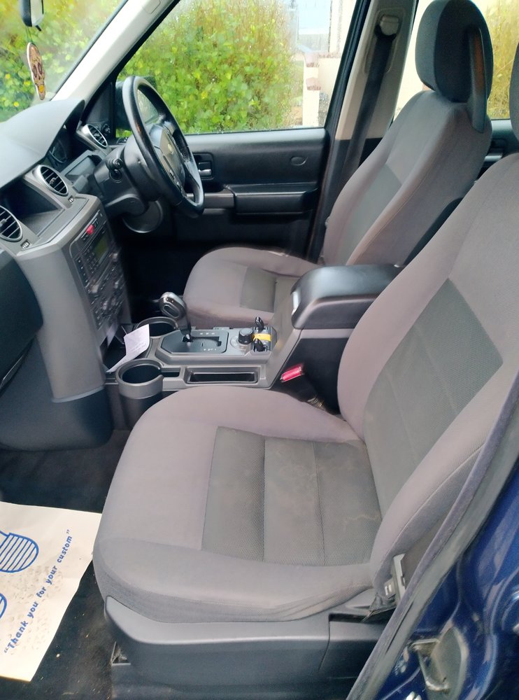

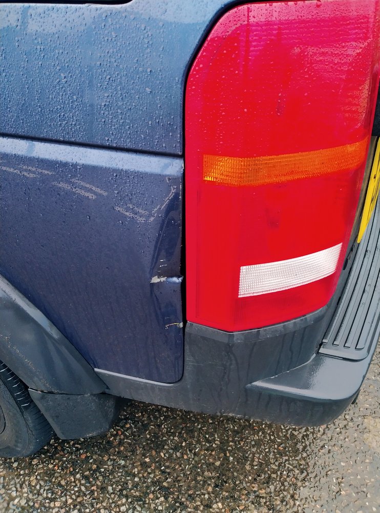

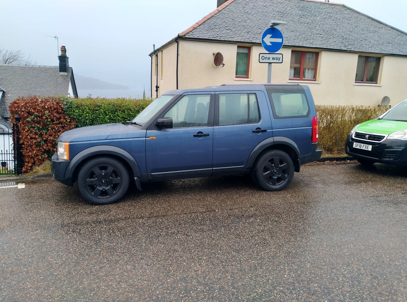

View attachment 327719View attachment 327720View attachment 327721View attachment 327722View attachment 327723View attachment 327724View attachment 327725View attachment 327726View attachment 327727

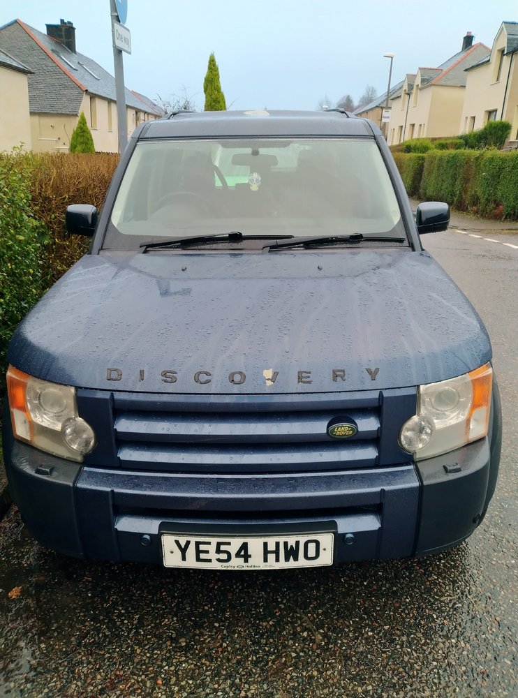

It has a few faults, permanently says the bonnet is open when it's shut on the dash, in typical land rover fashion the passenger side front air bag or one of the air lines failed on the way home in Glencoe accompanied by a burning smell in the cabin though the compressor seems ok so think that just might have been the heating fan not being on a high enough setting. More than a few body issues but seems very mechanically sound. Total cost £3300 with 203330 miles on the clock.
