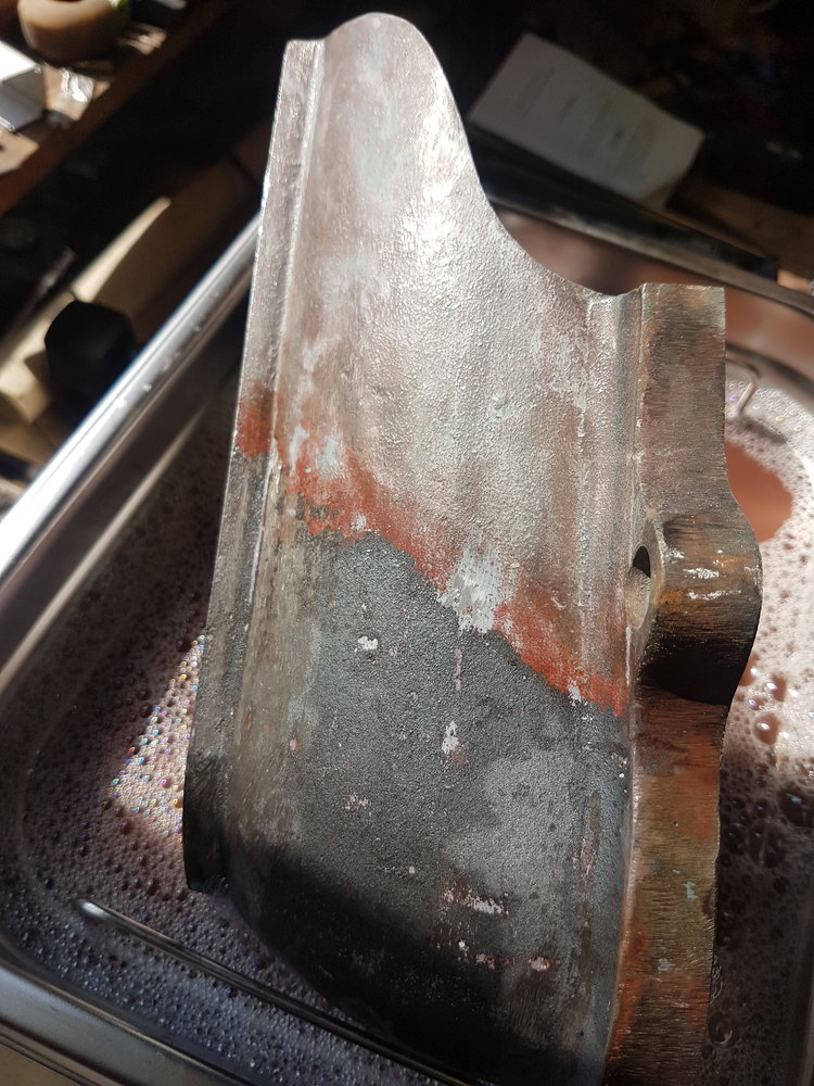

I use allendale, chainsaw carbs and lawn mower carbs come out very cleanLook up "cavitation" - it's at the core of ultrasonic cleaning.
I was involved in doing lots of ultrasonic cleaning professionally and I tend to think the additives specifically formulated for the purpose are worth having. Check out Allendale.
Washing up liquid is something I would never used; it's full of salt and the nothing better for initiating corrosion.
