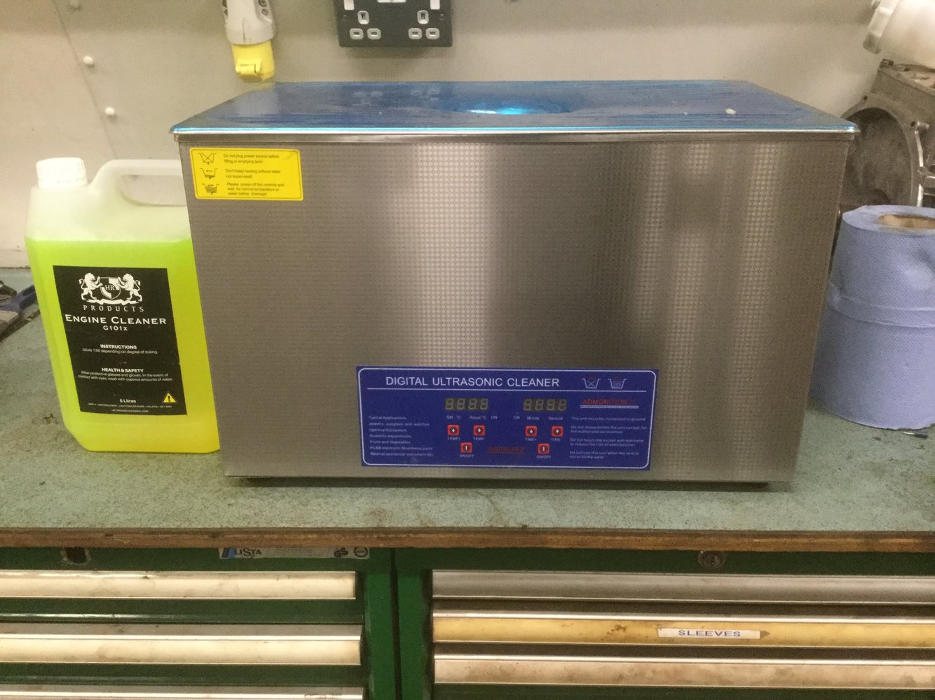

What did that cost?Bought this a while back, not used it yet but its big enough to drop things like a 4 barrel holley into.
