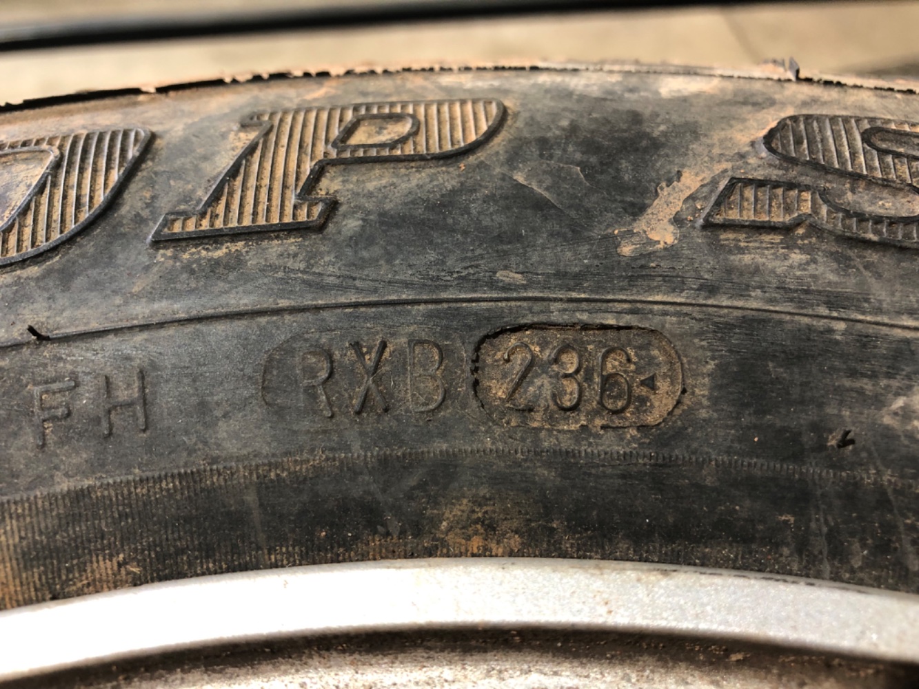

I’m trying to put a late 90s Nissan back on the road after it’s been laid up for at least 10 years.
I took the wheels to the local tyre shop today for advice.
They pointed out the date code on the first tyre I asked them to look at … it was one of the original tyres that has been in the car from new nearly 30 years ago! They are ordering me a set of 5 new …
*236 (3 digits) = week 23, year 19?6 (1996 on this car)

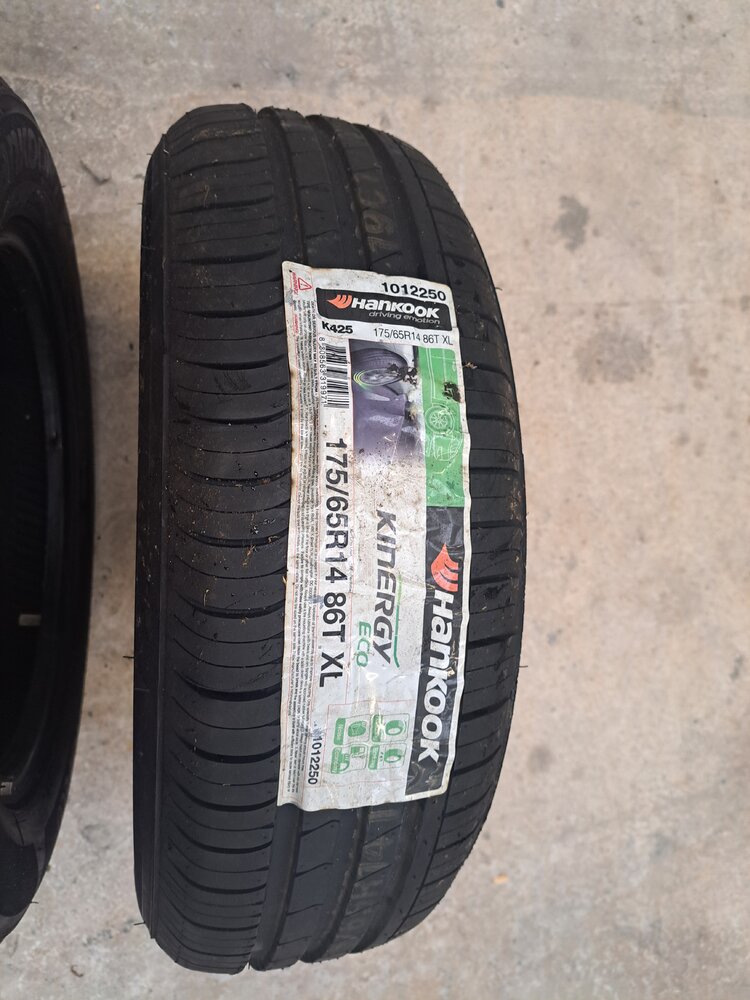

Whereabouts are you?I currently have 2 new Hankook tyres in the garage, never fitted, with stickers on still. Trouble is they are 14 years old. I have them advertised on Gumtree as suitable for a trailer only. View attachment 488950
