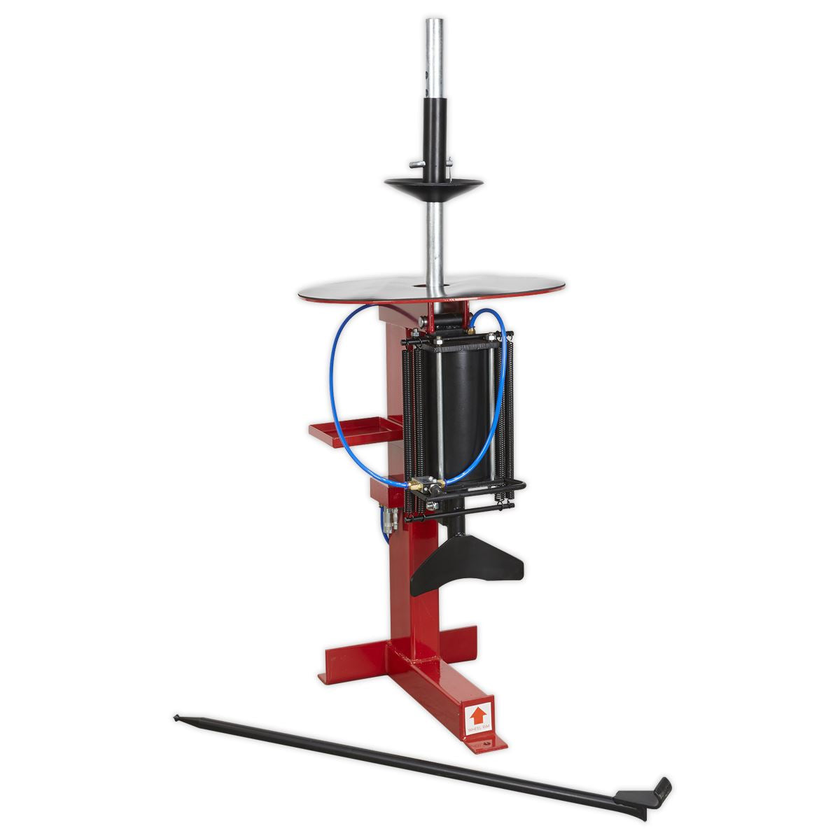

Bought something similar for well under 3 figures not that long ago. Hadn't been used much and the bead breaker ram was siezed. Squirted plenty air line oil up the hose and it eventually came back to life. As good as new now Labour intensive if your a tyre fitting business but fine for me.I you have a compressor (I currently used a small V2 Aldi unit), I purchased this style of tyre changer years ago second hand off Ebay, the only thing that can really go wrong is a piston seal or control valve or if it's not bolted down correctly chemical fixings for mine...
Also buy the extra optional bar for alloy wheels.
A brilliant bit of kit. Cheap even when new.
Sealey TC962 Tyre Changer Pneumatic/Manual Operation - McCormickTools
Heavy steel construction. Pneumatic bead breaker. Suitable for use on most automotive/light commercial open centred wheels. Features additional air line coupling for tyre inflator. Supplied with standard tyre bar and PCL couplings. To prevent damage to the rims of the alloy wheel, use optional...www.mccormicktools.co.uk

I use one of these, not high tech but does the job.Bought something similar for well under 3 figures not that long ago. Hadn't been used much and the bead breaker ram was siezed. Squirted plenty air line oil up the hose and it eventually came back to life. As good as new now Labour intensive if your a tyre fitting business but fine for me.
