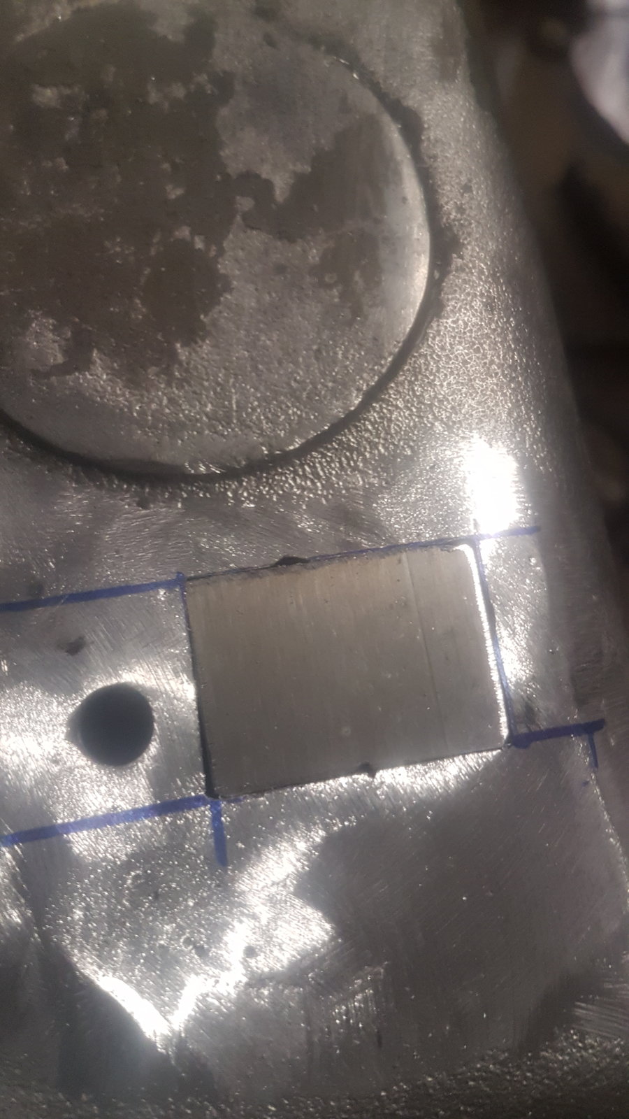

Thought I'd put up this thread for some of the general stuff I do.

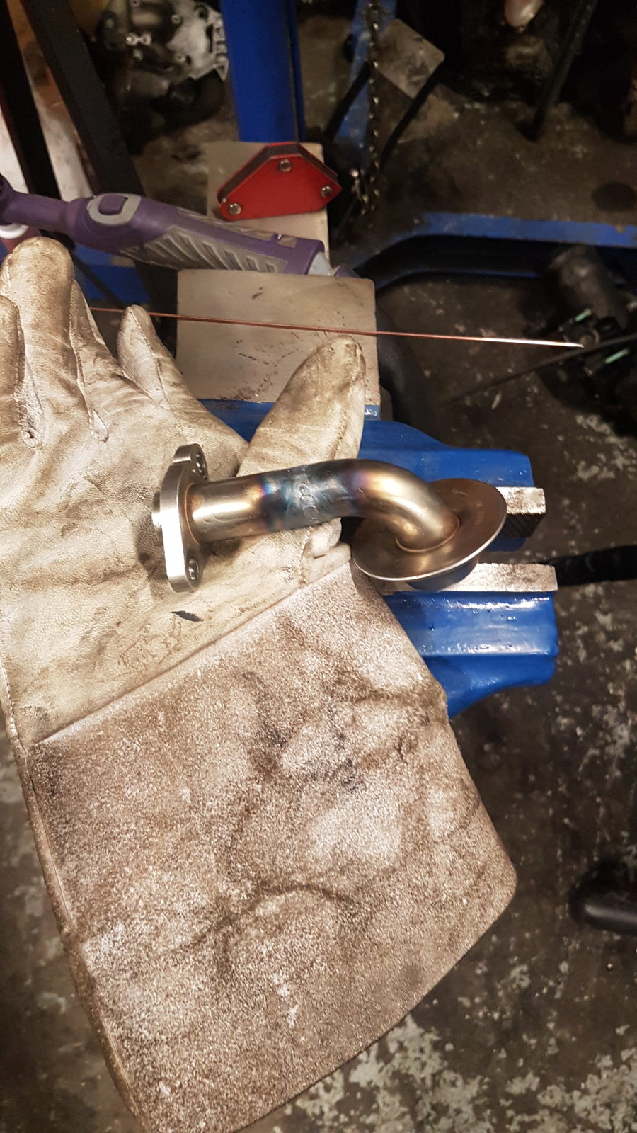

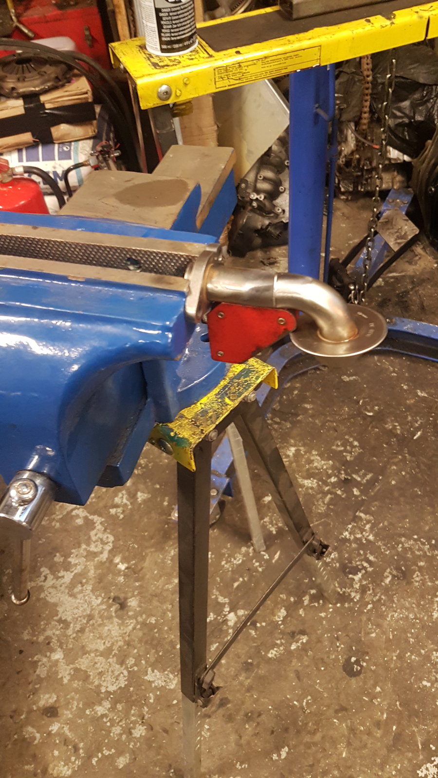

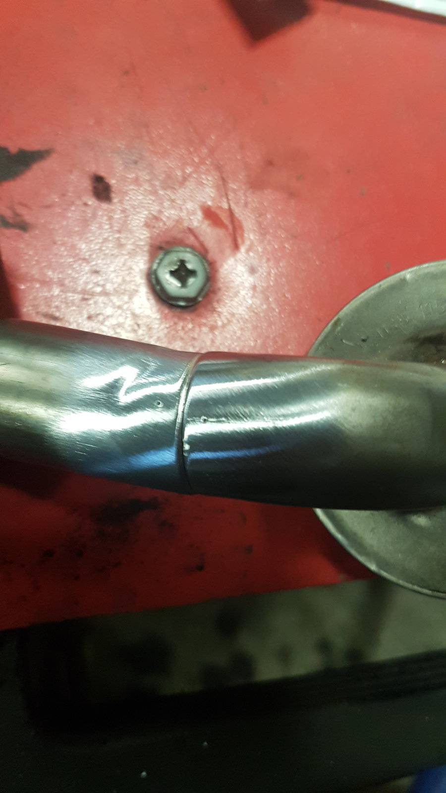

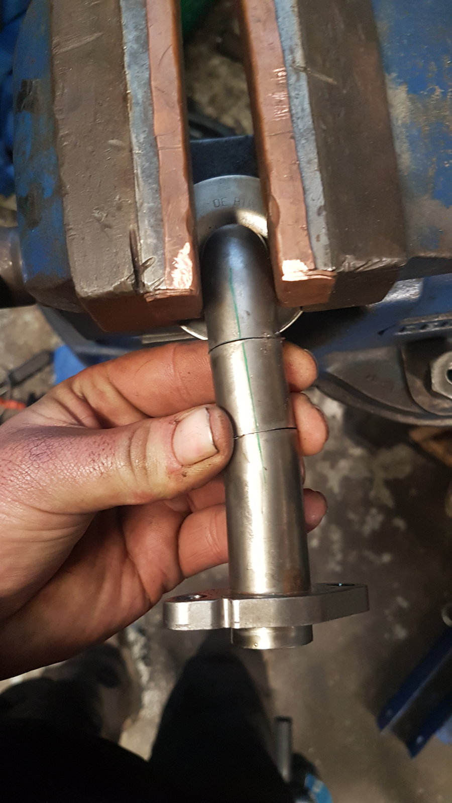

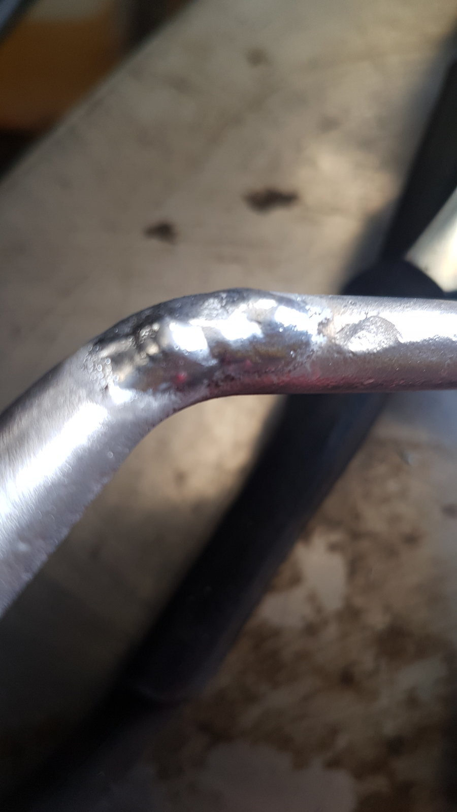

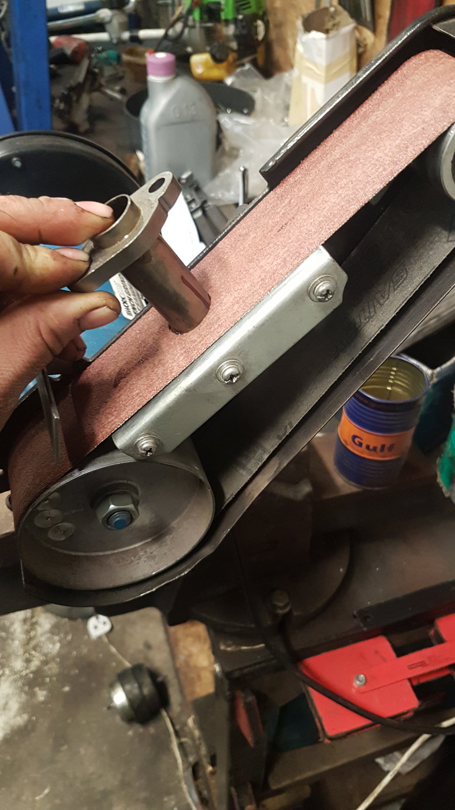

Todays job was to modify an oil pick up pipe for an Audi.

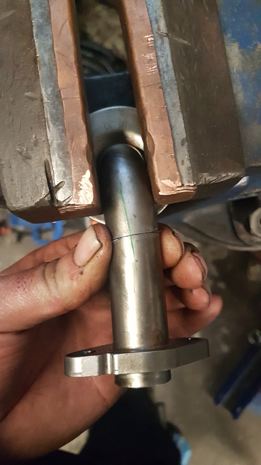

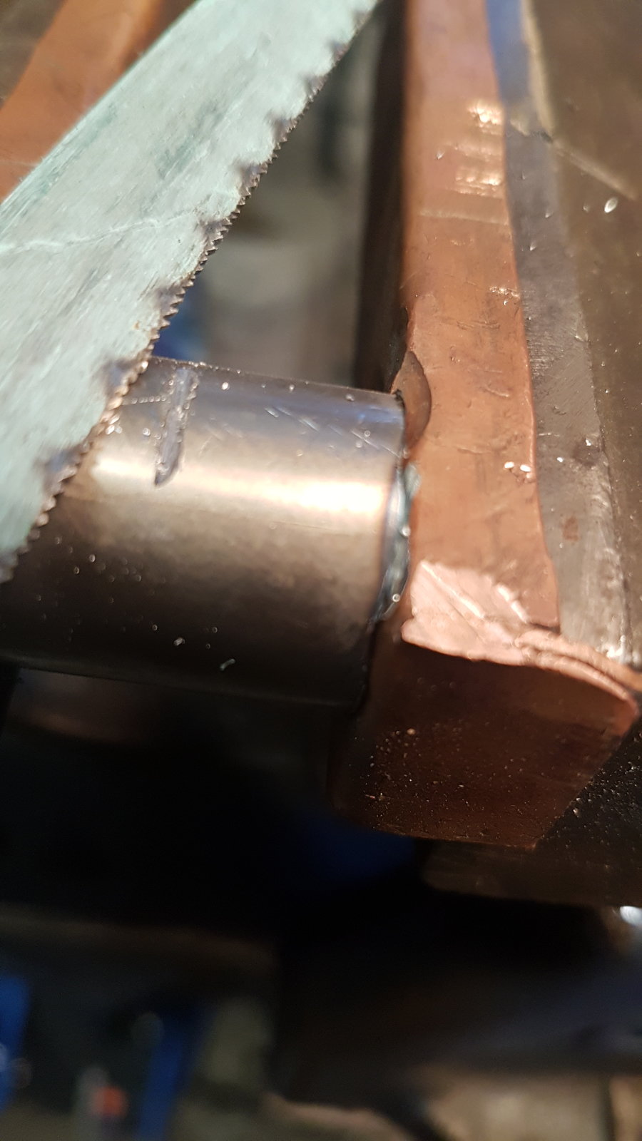

I cut about 1 inch out of it

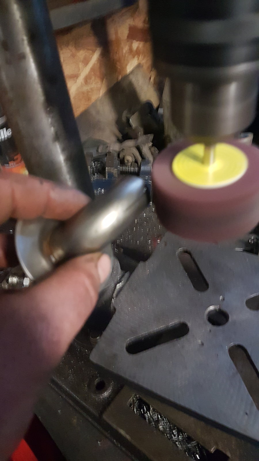

Cleaned the ends off on the belt grinder so the fit up was nice and tight with no gaps and deburred the inside with a carbide bit.

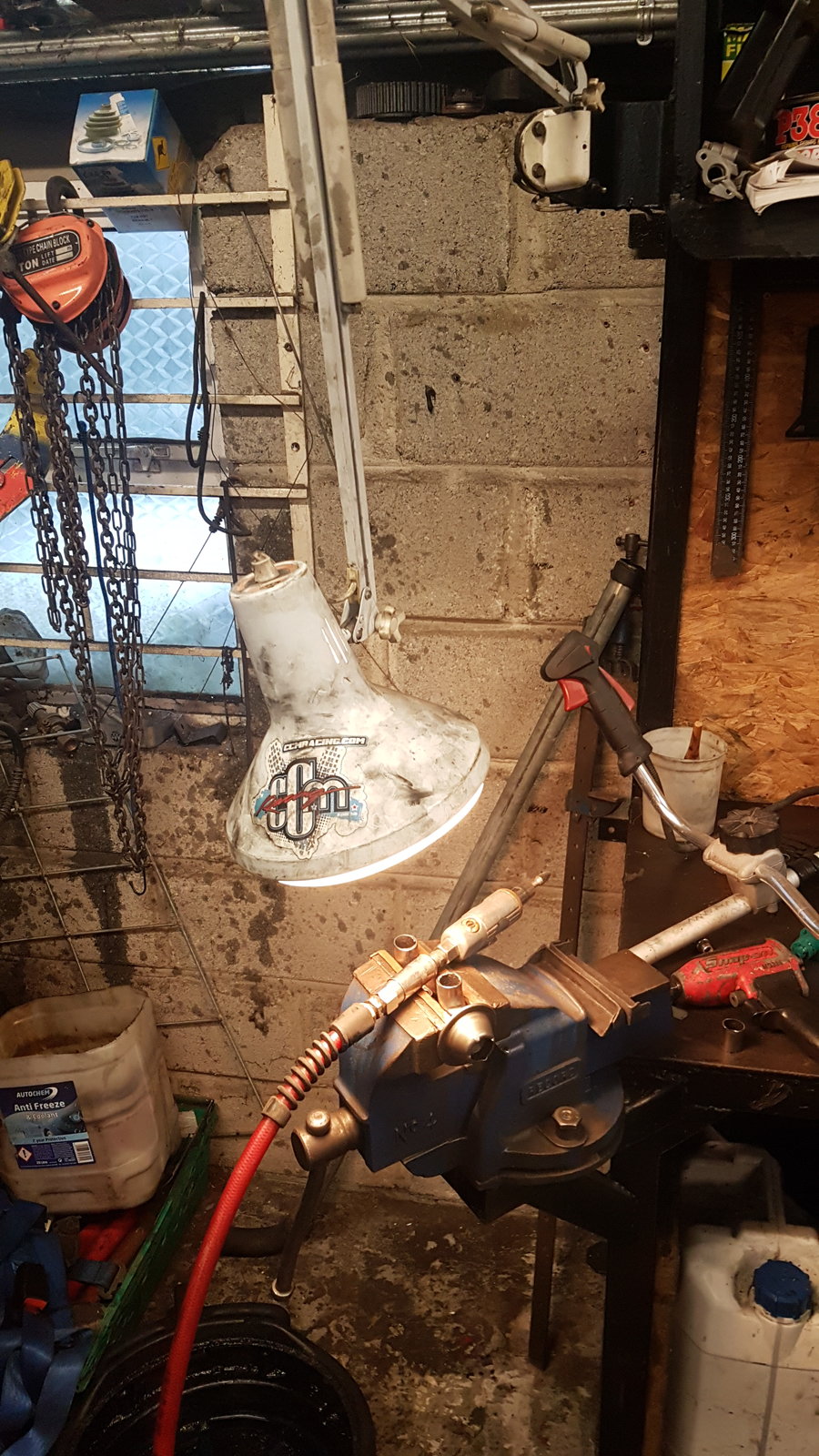

That light over the bench is one of the best things I've gotten. Saves straining the eyes trying to see scribe lines etc.
