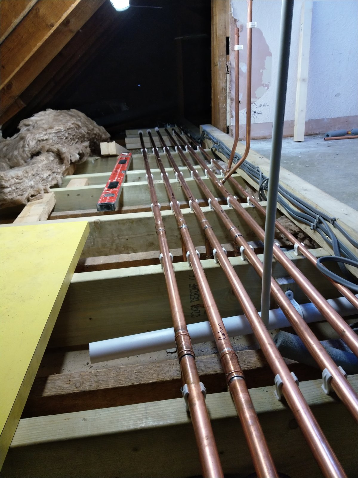

I had to have an engineer round to do the calcs and get everything in writing as we might need to make a claim against the surveyors for missing all the chopped out struts etc.C24 Rob... Not C16...
He spec'ed C16 as as you know it doesn't really have much weight on it.
I've got the roofer coming back Thursday with the right timber this time!
He seems to think the treated fence posts are stronger than then C16, to be honest it would never have gone anywhere but I paid for a proper job and that' what I want.
