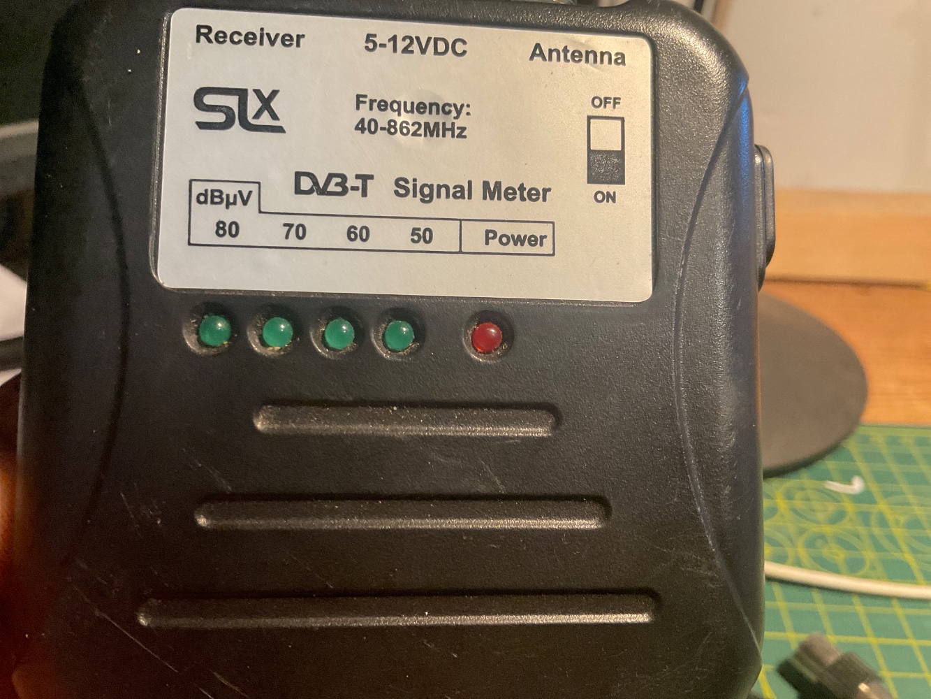

Will this help??
I’ve only just got around to putting up the cheapie log periodic aerial, using a compass to point it in the right direction.
Before that, I hooked up this crappy signal strength meter:
But, swinging the aerial back and forth over 180deg, it didn’t waver from one green light, or 50 dBuV. So, I went back to the compass bearing and tested the TV - all channels booming in nicely, although it was at night we were getting the problem.
Do I conclude that the signal strength meter is useless? The signal must be strong here to power through the corroded, balun-less contractor one that was there before.
Cheers - yes, the quoted range is 40-862 MHz. Probably more of a useful device for old analogue signals.It's a Philex, 'nuff said. Wide as a barn door, so you can't pick out a single multiplex.
Assuming it is not just unfit for the purpose...
What you can do is to provide some sort of attenuation, either a proper resistive one, or arrange a small disconnection gap to limit the signal so that you can see any change.
However, maximum signal rarely coincides with minimum BER which is the important reading, but modern modulation methods are generally robust enough to be useable even when the BER is not ideal.
It’s up and installed now, and seems to work. Any more problems and I’ll be forced to buy a decent aerial and coax (already recommended above!).
I did use it to verify that a car key fob was transmitting. In fact, the only time it has been useful!The meter is not looking for modulation, so the analogue / digital business is irrelevant as it is purely reading the field strength of any RF signal over the entire band and maybe well outside it too.
