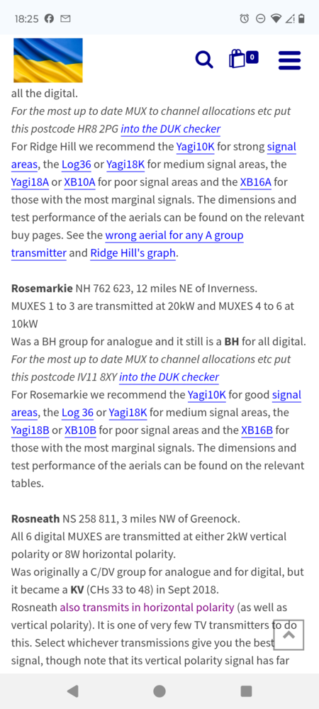

Before you get all spendy, check which antenna band you need, looking at your screenshot, probably group B - I wouldn't recommend a wideband unless you really need one, also try and match the antenna to the predicted signal strength at your location.Out of interest, (you might remember I had a brief foray into antenna physics), surely there must be some kind of balun, even on a cheap aerial, to convert the balanced dipole signal to unbalanced coax, and match its 300 ohm to the coax’s 75 ohm? I’d look it up in the ARRL antenna book, but I can’t find it and it’s impenetrable anyway.
I assume it’s like others I’ve seen on cheapie antennas, a wiggly PCB track.
I’ll look into upgrading, thanks.
