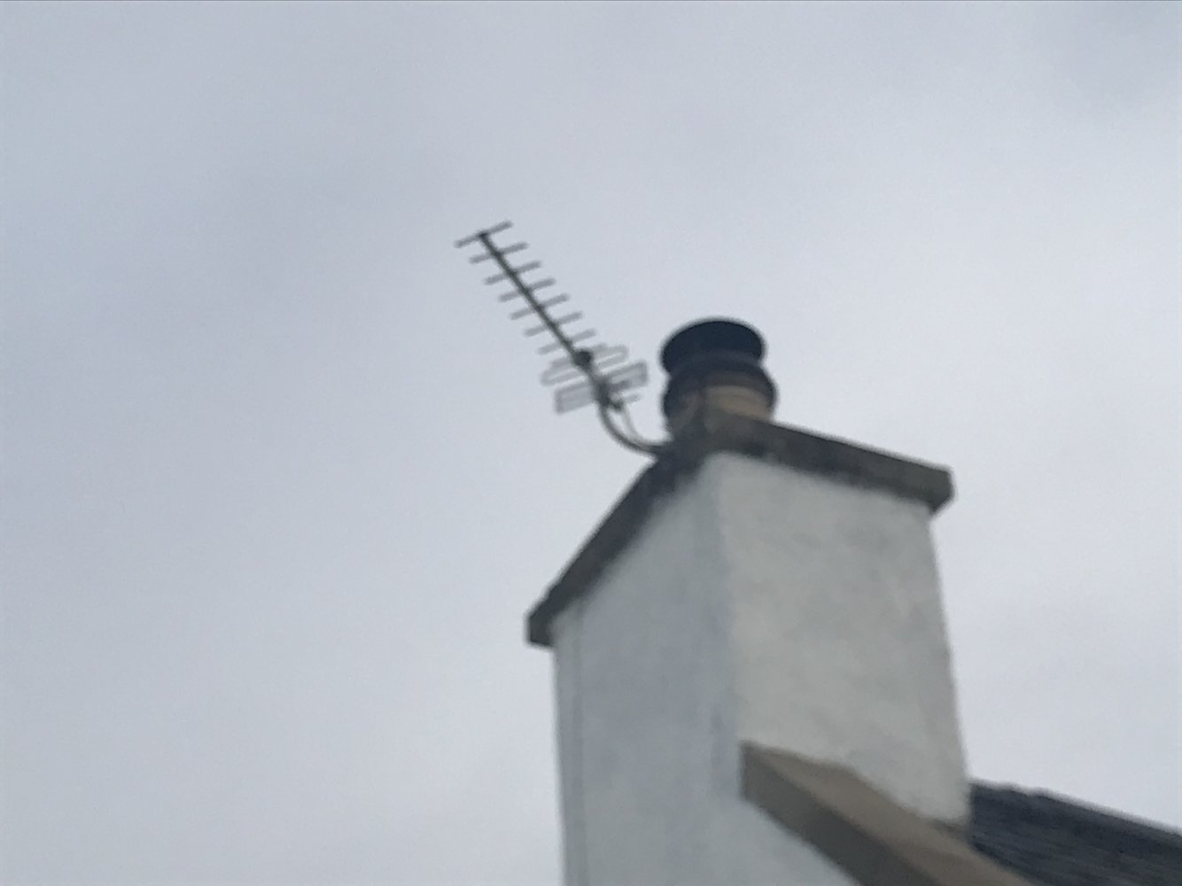

If the existing route proves a no-go it may be worth checking the wall thickness below the window as sometimes croft houses have thin walls under windows even if the original inset has been framed flush with the walls to provide a deep cill. If there is a socket or other access it's worth a look, failing that you could make a very small hole in the plasterboard/ insulation and poke around with a coat hanger type wire to see if there is a significant void. Our croft house has about 600mm of stone in the main walls but only about 200 - 250mm below the windows.No, I think the coax was built in when the window was installed. It doesn’t follow a straight path.

I know what you mean. Our last croft-type house was as you describe, but I filled them in with studding, to make a decent-sized windowsill, anticipating it would used for storage of lots of crap, which it was, and a cat lookout point , which it also was.If the existing route proves a no-go it may be worth checking the wall thickness below the window as sometimes croft houses have thin walls under windows even if the original inset has been framed flush with the walls to provide a deep cill. If there is a socket or other access it's worth a look, failing that you could make a very small hole in the plasterboard/ insulation and poke around with a coat hanger type wire to see if there is a significant void. Our croft house has about 600mm of stone in the main walls but only about 200 - 250mm below the windows.
Nah, they just shifted it down a bit.but I had it in mind that the modern aerials were designed to reject mobile signals.
Unfortunately, it’s an old stone croft house, and the wall is 700mm thick. I’d rather not drill it if I don’t have to.

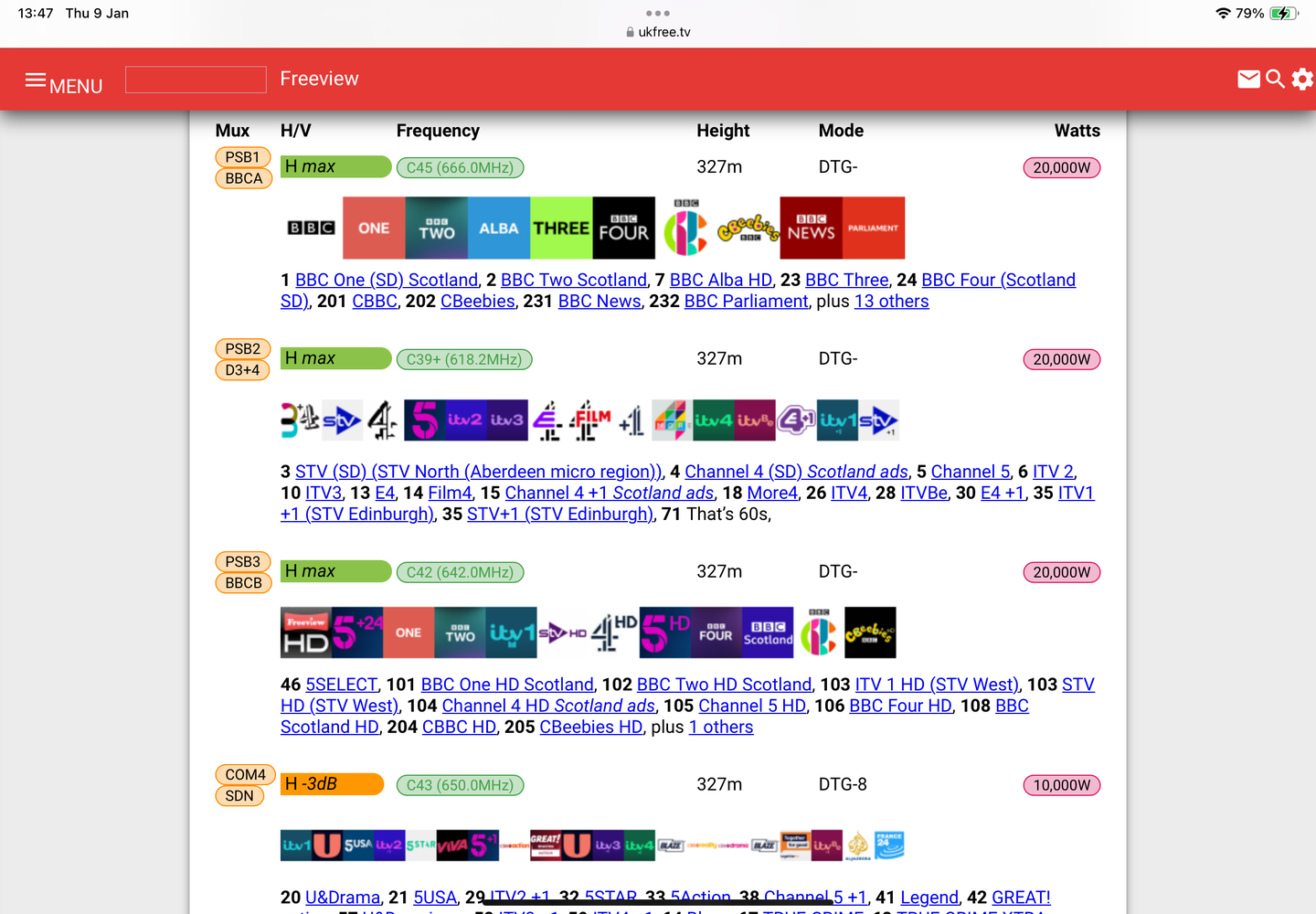

A Group B antenna would seem to be the one best suited to Rosemarkie's transmissions. Group K would be a 2nd choice.

Will this help??
