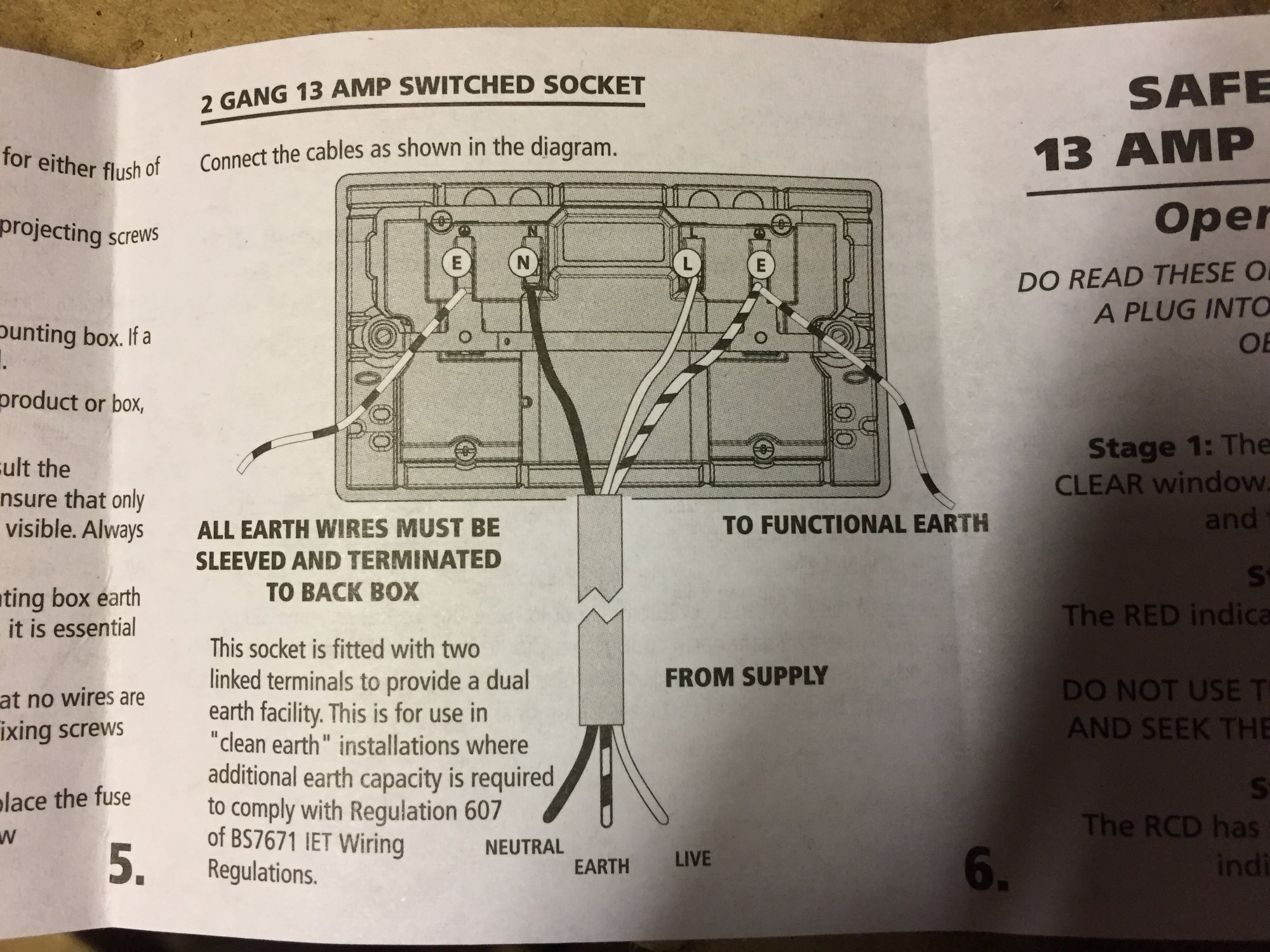

You don't need to worry about that one, its something occasionally used in IT installations.Functional earth?![]()

take 2 long to reply heres your answer https://www2.theiet.org/forums/forum/messageview.cfm?catid=205&threadid=12390
EDIT < as above.
they changed the rules one earth each side. that's why the modern ones have 2 earth conections
