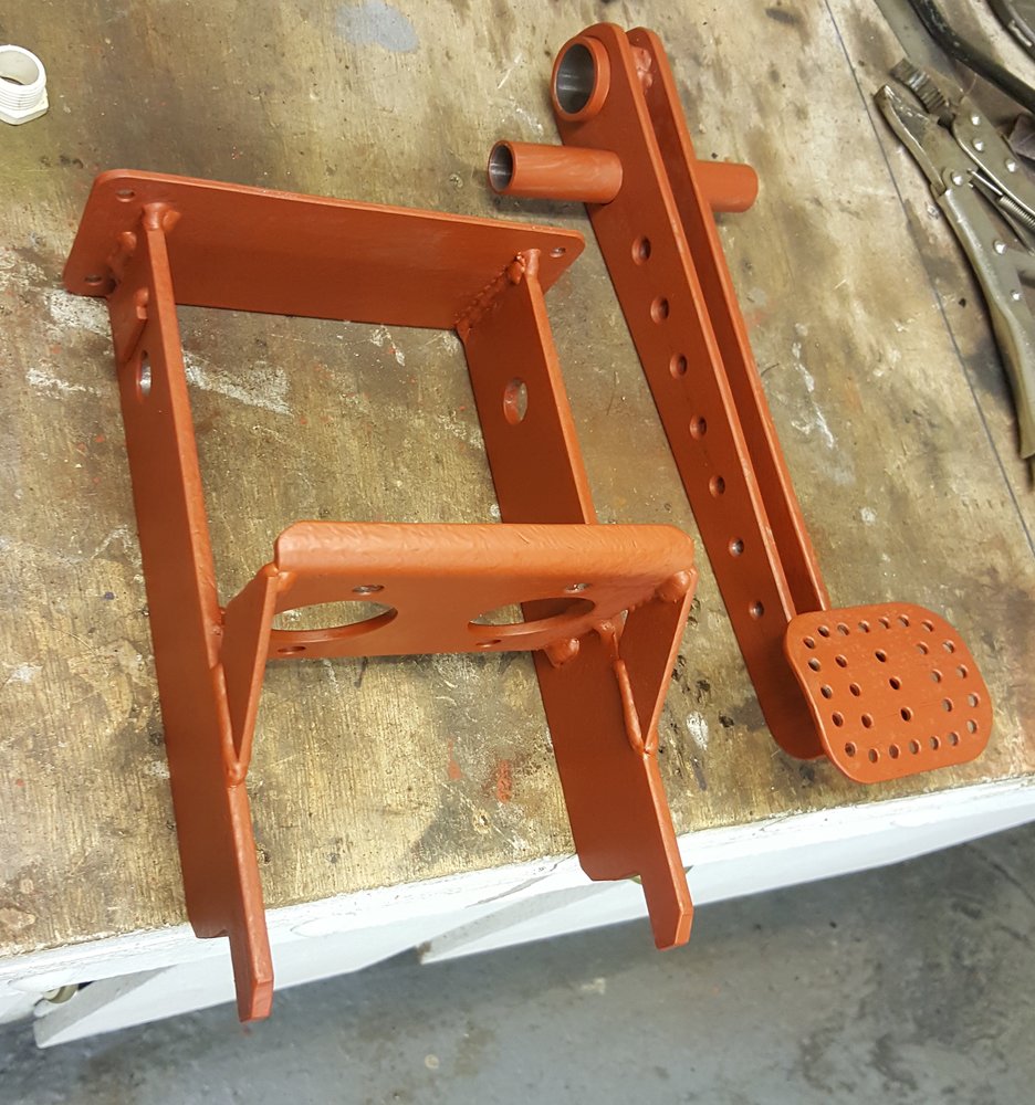

I would have thought going up in size on the master cylinder would move more fluid and give increased braking by moving the slaves further or is that not how it works?Steering is a bit less ‘loose’ now, doesn’t wander around any more.
Brakes aren’t very good, I can’t lock a wheel up no matter how hard I press, but MOT passed them happily.
I might go down a size on master cylinders, I think they are both 3/4”. Then I can probably tweak my balance bar system to get the best all round braking.
I’ll pull them out, order some smaller ones.It moves more fluid but the pressure is lower.
3/4" is large for twin master cylinders, I would try 5/8".
The pedal feels okay, fairly firm, ratio is 6:1 if I remember right. I made the pedal and frame myself but bought the actual balance adjuster spindle part.Whats the pedal movement like ? any idea of the pedal ratio ?
Just had a look, they are both .750“. I shall order a pair of .625”It moves more fluid but the pressure is lower.
