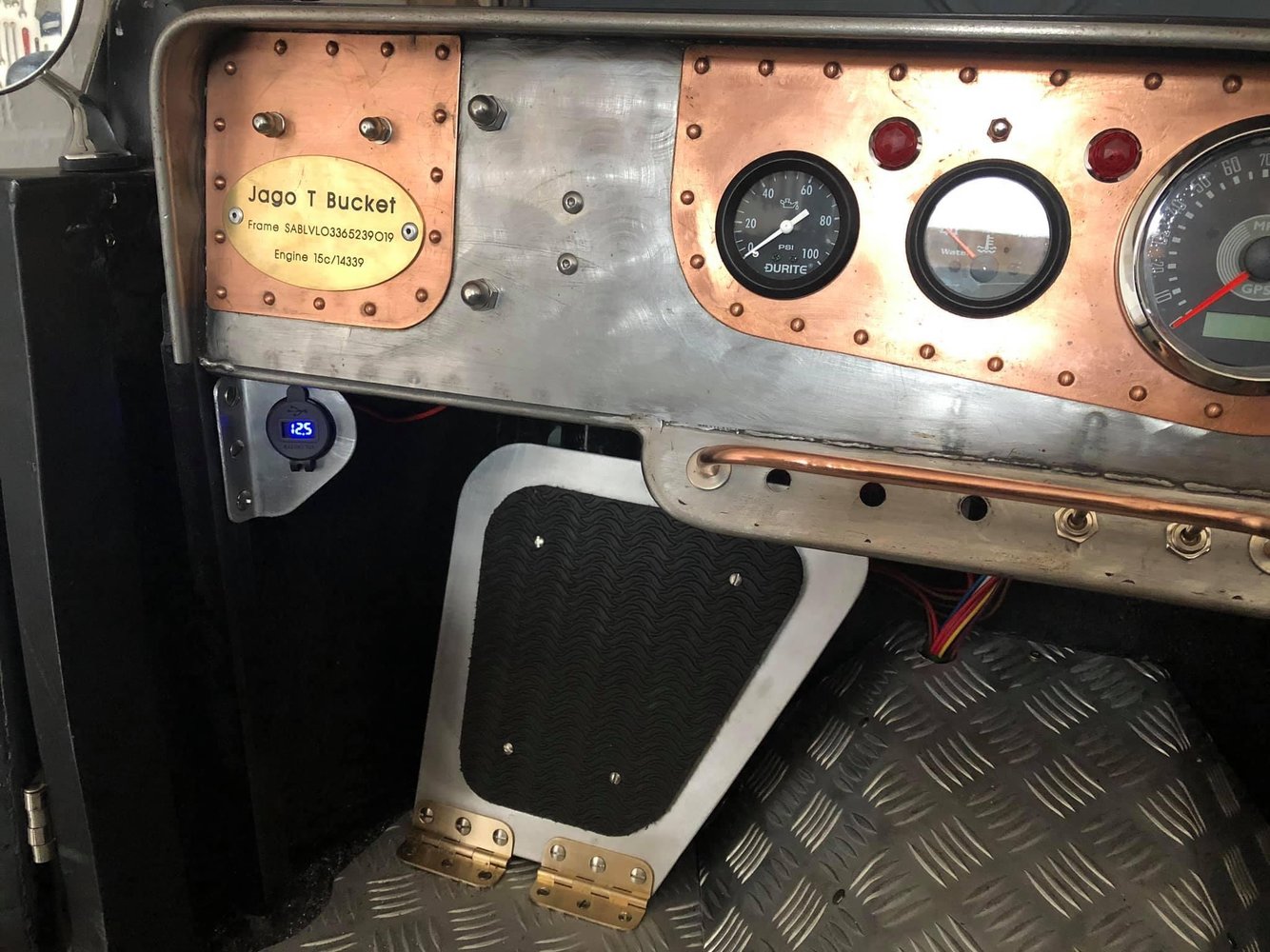

I have some split sheathing to go round there, but there's still some tidying and cable tying of wires to do.I would put a nicer sleeve on the cable coming out of the chequer plate though![]()

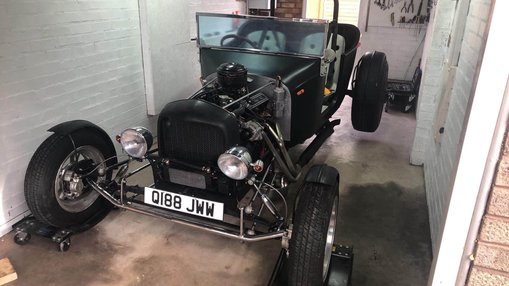

If its been modified that much from sva you need to make sure its done properly and to sva standards, which won't be checked for mot. You said you changed steering box, for example the joint in the steering column has to be at a certain angle so it collapses in an accident and doesn't spear through you. Seat belt mount heights etc all important.It’s been on the road before, fully registered on a Q plate, but i’ve had it torn into a gazillion pieces and reworked so much... built my own brake system, fitted a different steering box... reworked suspension.... the worry is that something will fail or fall apart...... maybe I’ll die in a burning fireball......on the way to MOT.
I did all the copper bits, and stuff like that, inspired by @selectedgrub
View attachment 283925View attachment 283926View attachment 283927
It’s not been through SVA, it was built in 1985 long before SVA was invented.If its been modified that much from sva you need to make sure its done properly and to sva standards, which won't be checked for mot. You said you changed steering box, for example the joint in the steering column has to be at a certain angle so it collapses in an accident and doesn't spear through you. Seat belt mount heights etc all important.
To many people modify these vehicles after the sva and then someone is killed. I remember a case were both people in the kit car broke their necks due to seat and seat belt changes. At SVA test photos is usually taken for proof.

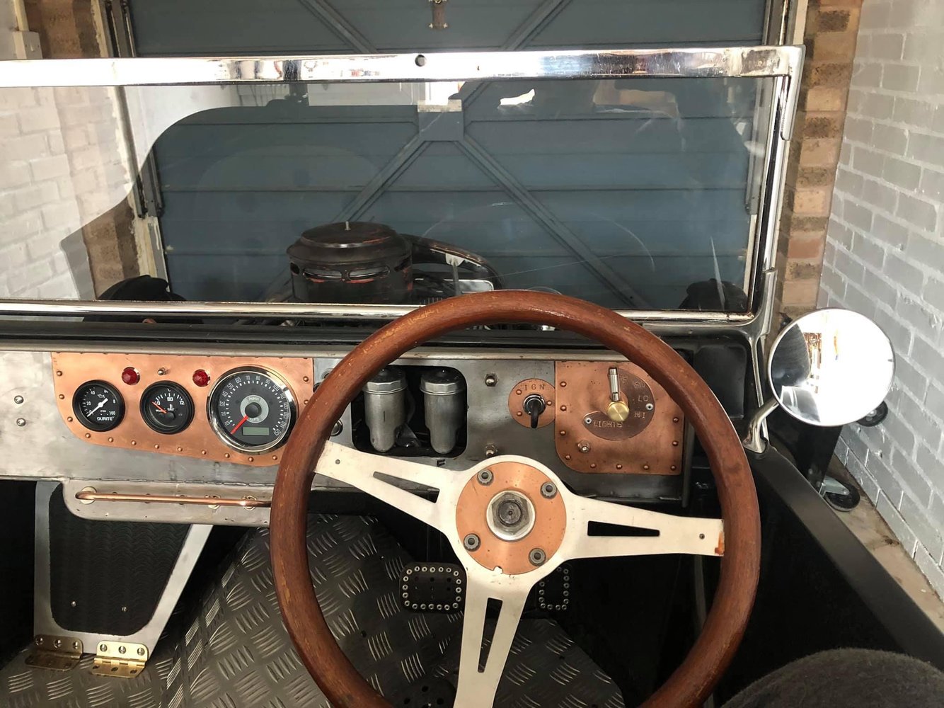

That big exposed nut in the centre of the steering wheel couldn't have passed. That's a sure way to kill yourself in an accident.
