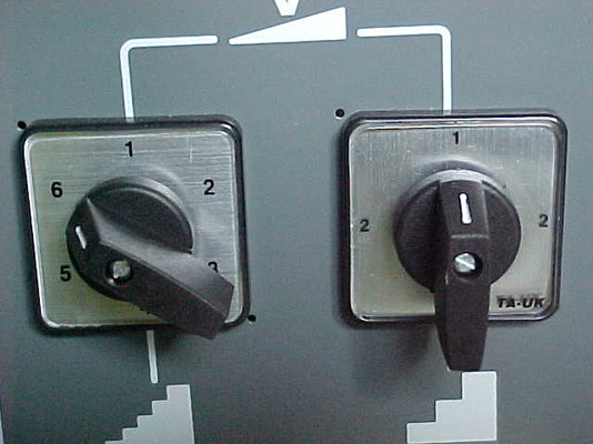

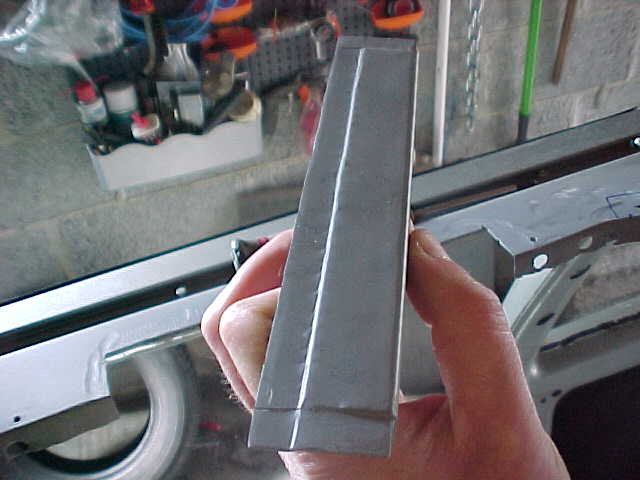

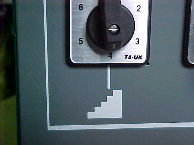

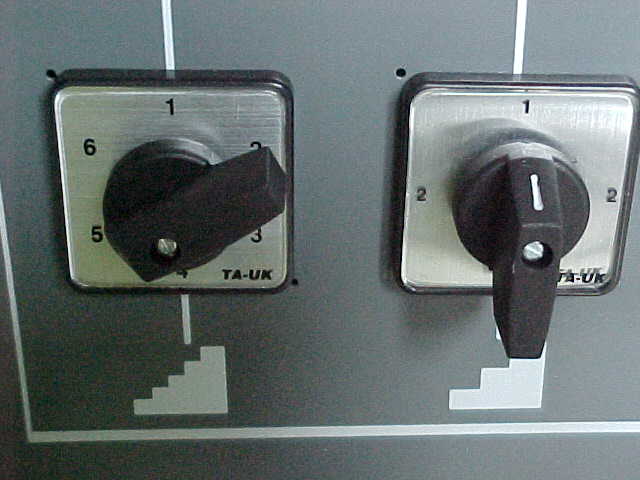

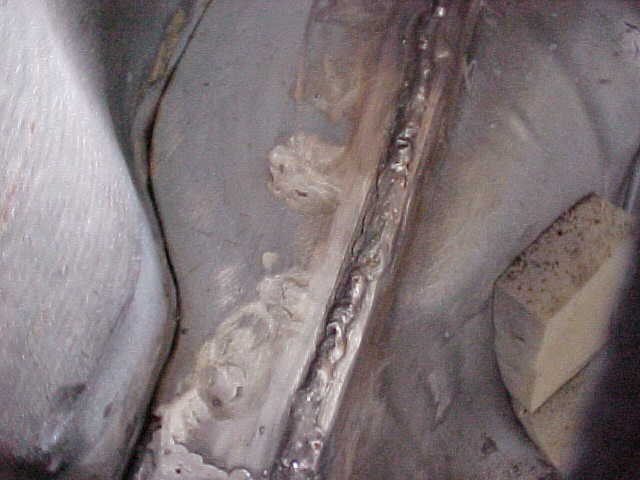

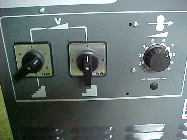

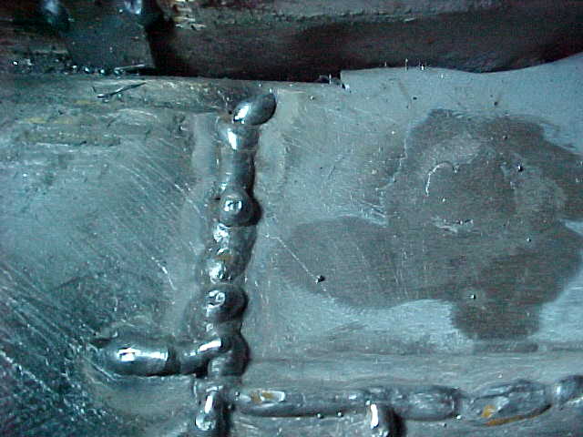

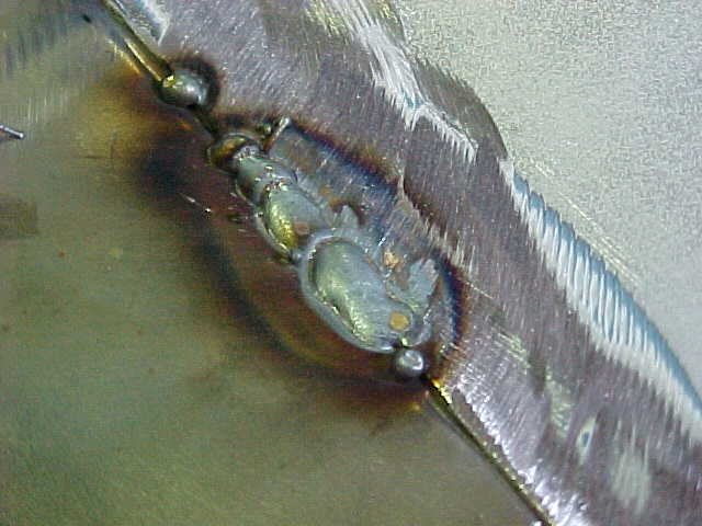

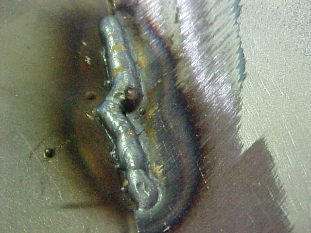

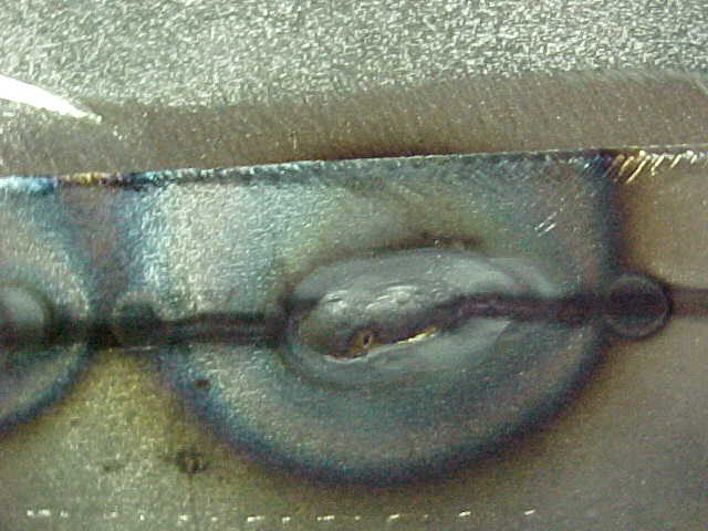

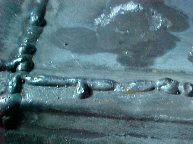

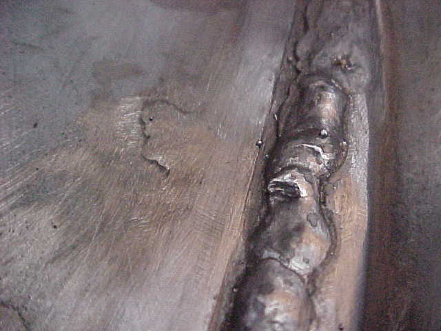

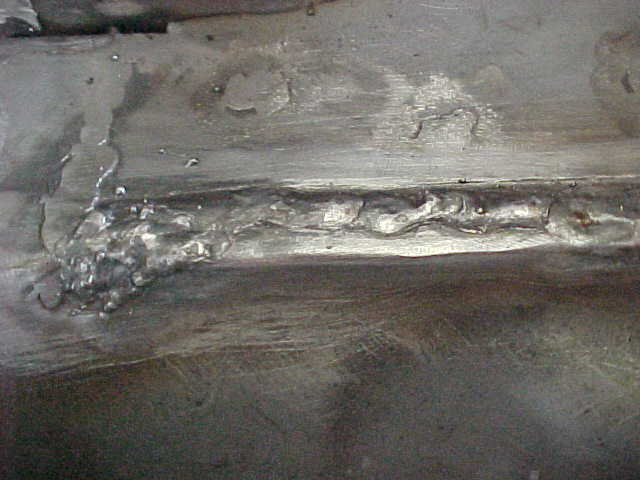

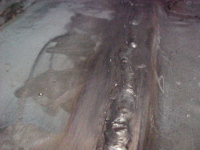

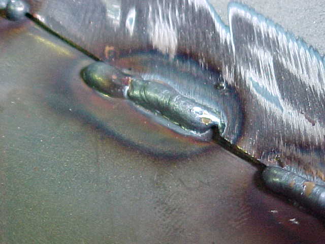

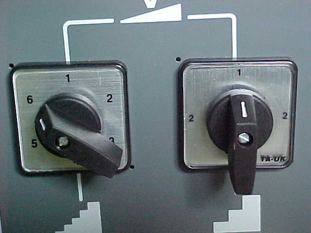

Posted a few weeks back with my first attempt to weld the boot area of my Fiat. From the first two pictures below hadn't the power up high enough. Got depressed and left it for a few weeks. Grinded the welds down today and turned up power setting to 2 Course and 5 fine on my Oxford 200-1. Think portamig uses the same controls. That's the second highest setting on the welder.
I know I did stop and start quite a bit and had some spitting near the end. The welds are a lot flatter than before. Pictures didn't come out a well as I hoped but hopefully you can get the idea.
Let me know what you think.
