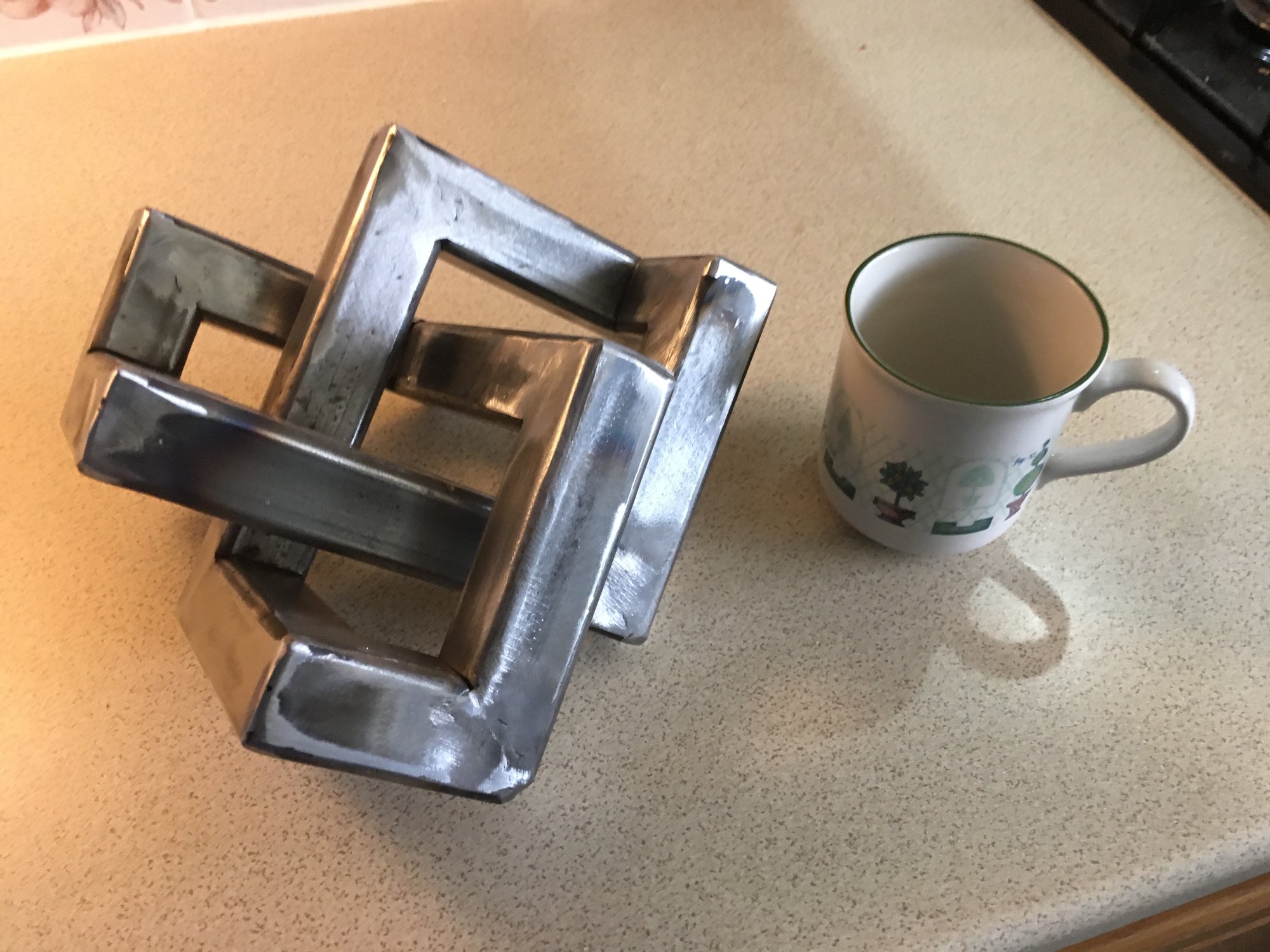

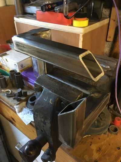

All done, now. Haven't done the internal fillets, and the jast joint had to be pulled into place by a couple of millimetres.
And the mug for scale, of course!

You did yourself a favour by leaving a larger gap between the 'foils' than I did
They look like they'd use a fair amount of material, size dependent of course.

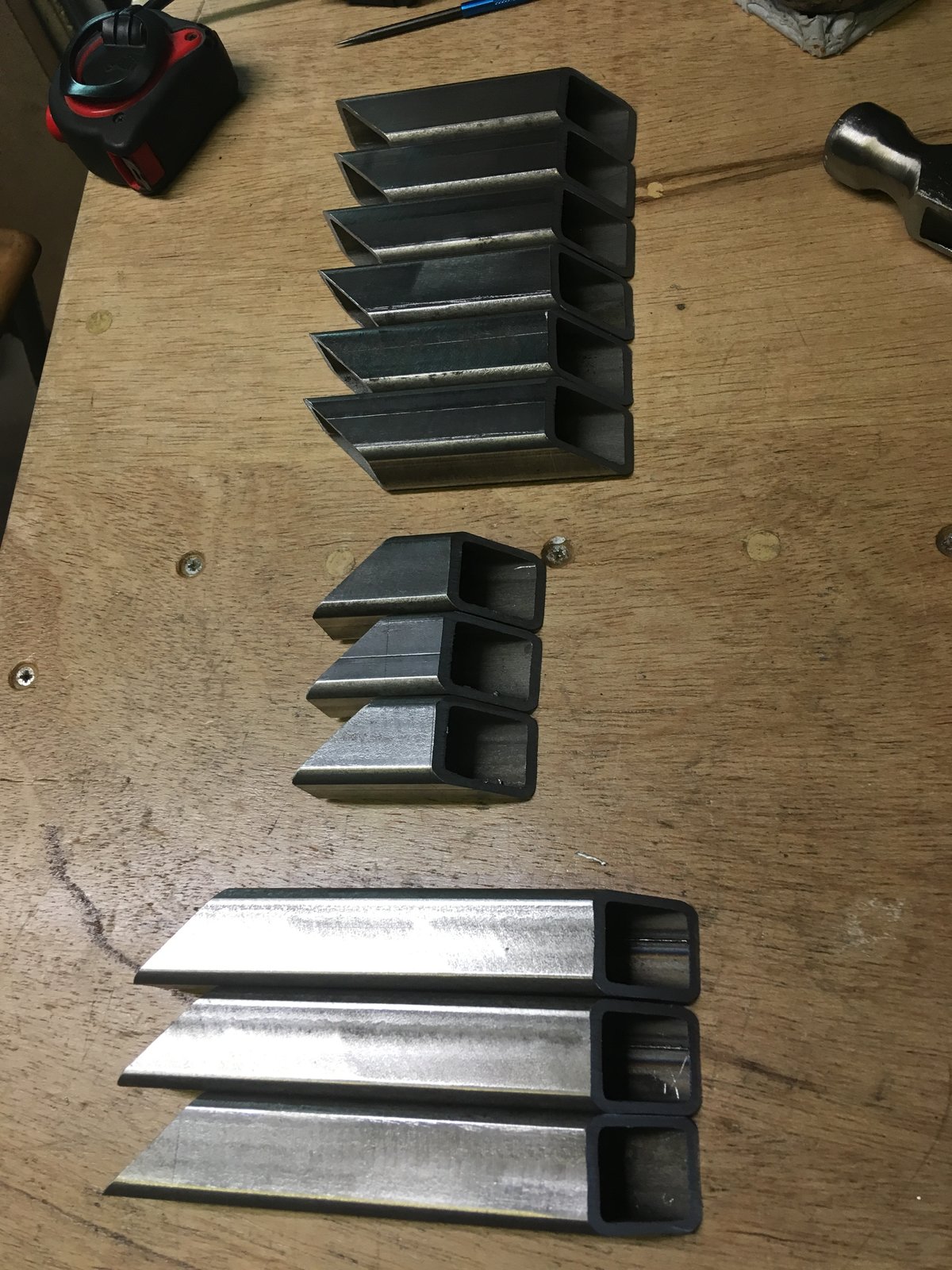

Also just downloaded the welder's knot from the last page of this post, and I'm sure it's made from fess (just 10, maybe?) pieces.
The PDF plans I'd done in this post? https://www.mig-welding.co.uk/forum/threads/trefoil-plans-wanted.89843/#post-1311485
Yup - nine pieces; three red, three orange and three yellow.
Put it this way, it was harder to visualise it than it was to weld it up
