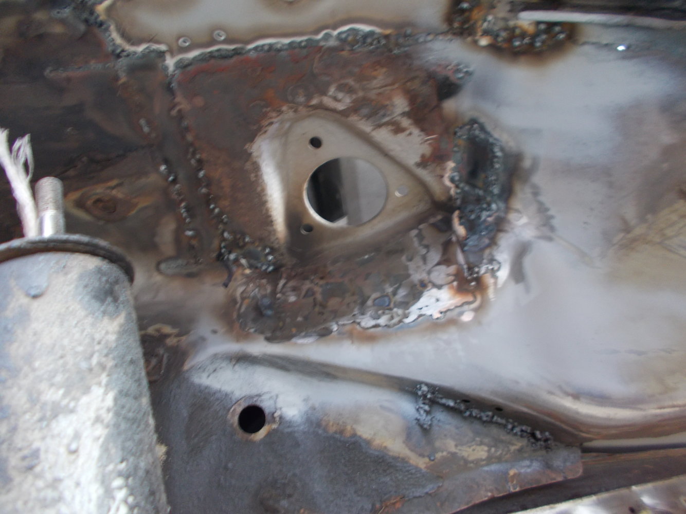

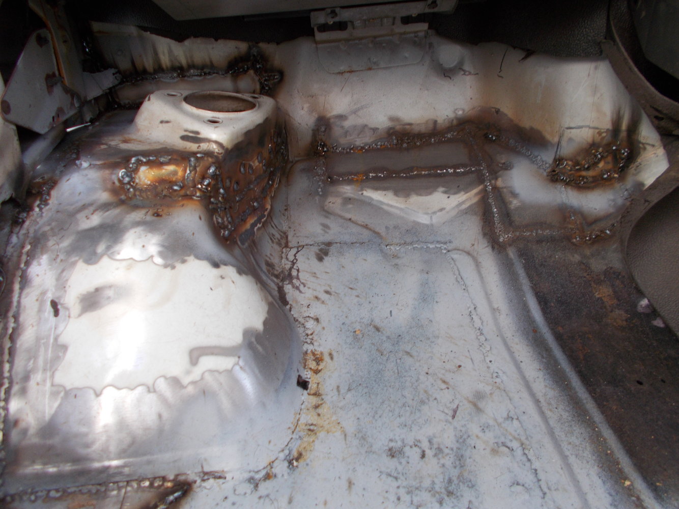

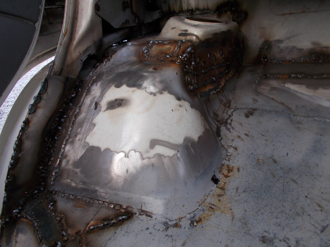

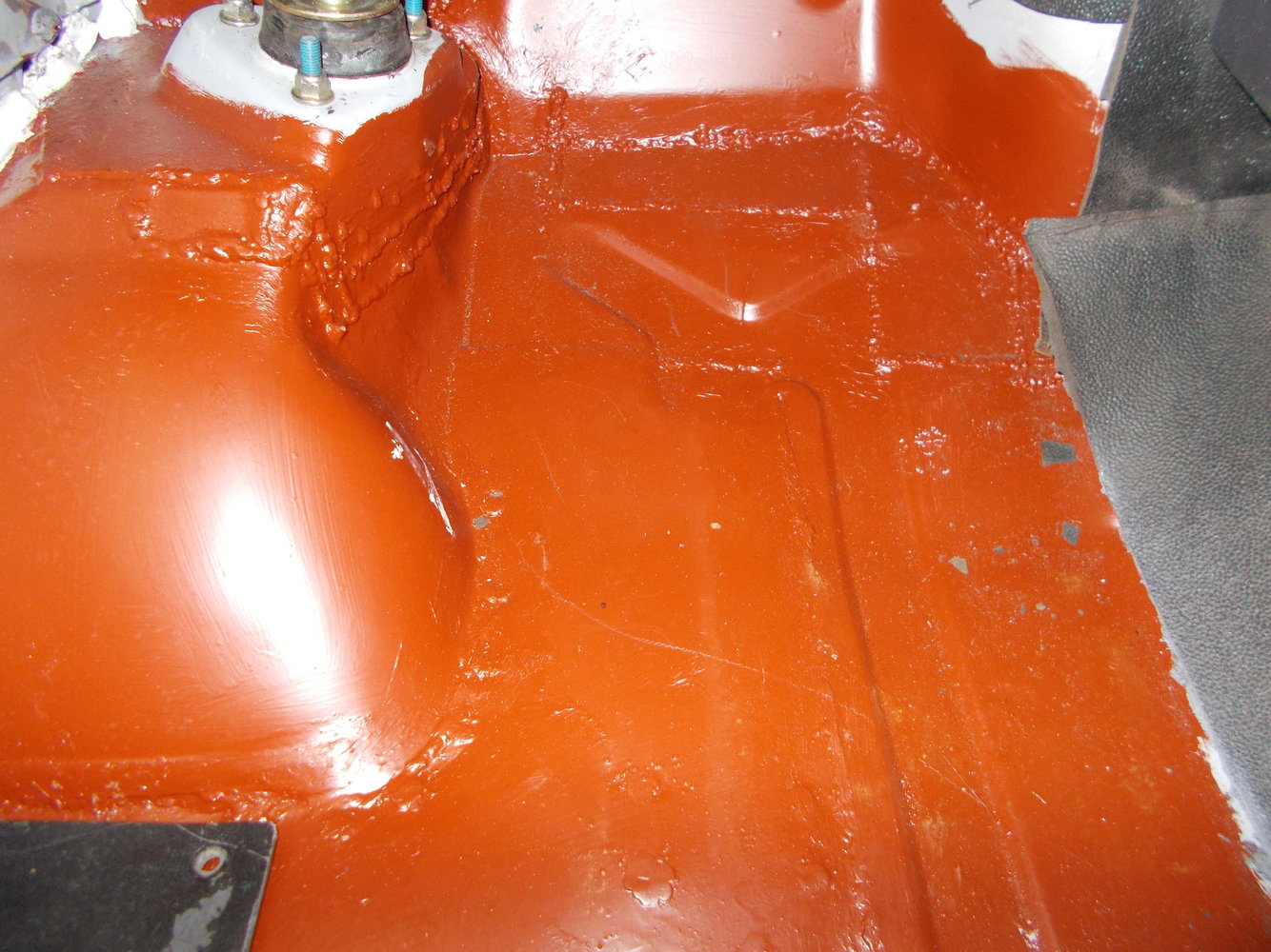

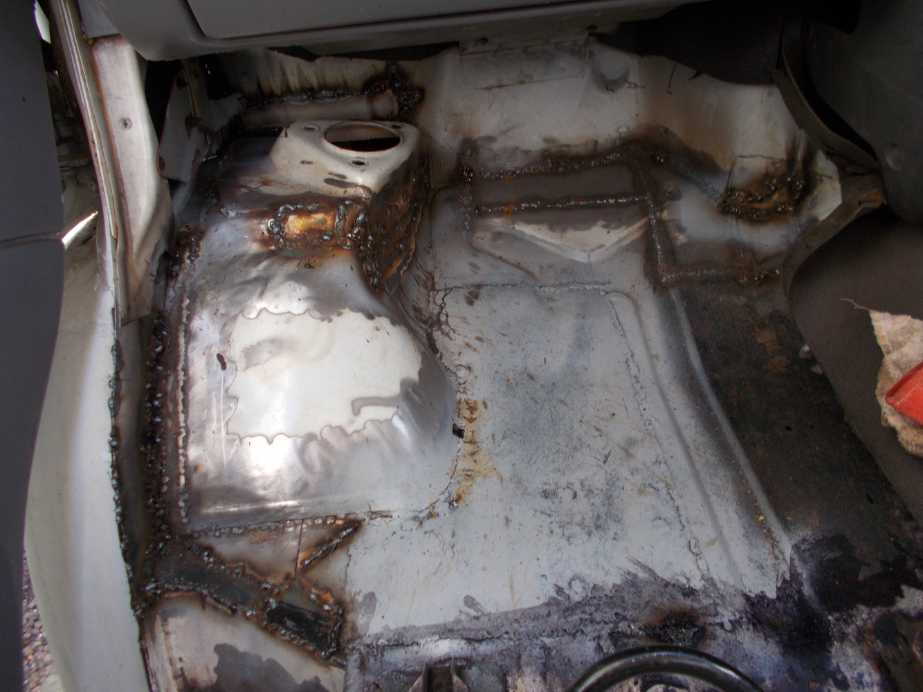

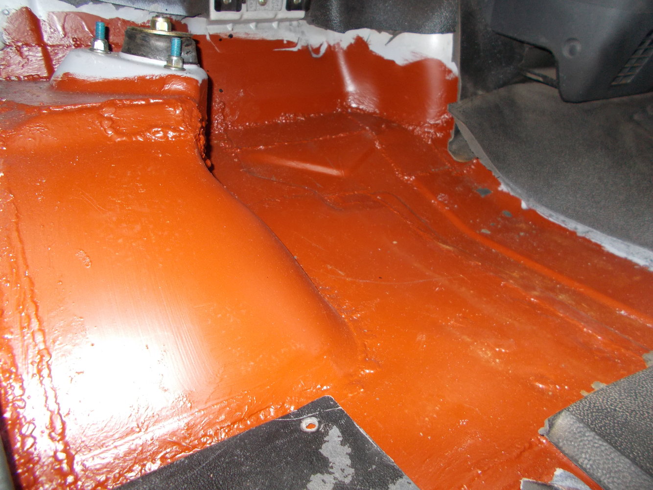

well things are moving on, have a look at how far i have come to date, i still have a few bits of welding to do here and there, once done i will treat it with hammerite kurust then spray undercoat then red led and finally underseal, i forgot to mention that seam sealer will be the first to do on my list once i have ran the grinder over all the welds and flatened thiem.View attachment 421078View attachment 421079View attachment 421082 View attachment 421080 View attachment 421081
Hoping we hadn't! Looks like you're making good progress, well done.just when you thought you had got rid of me.......

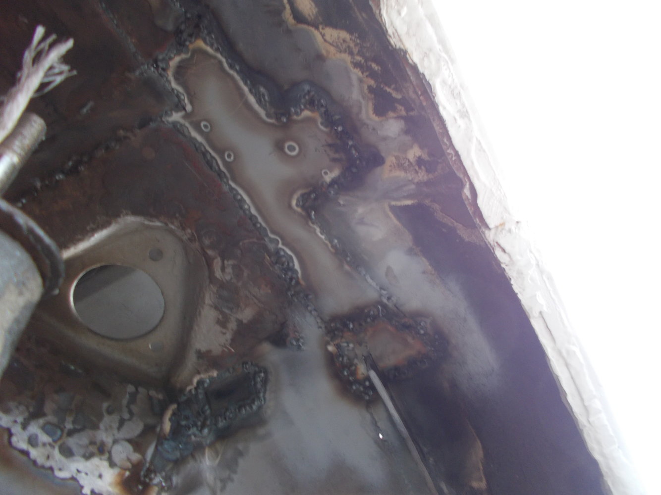

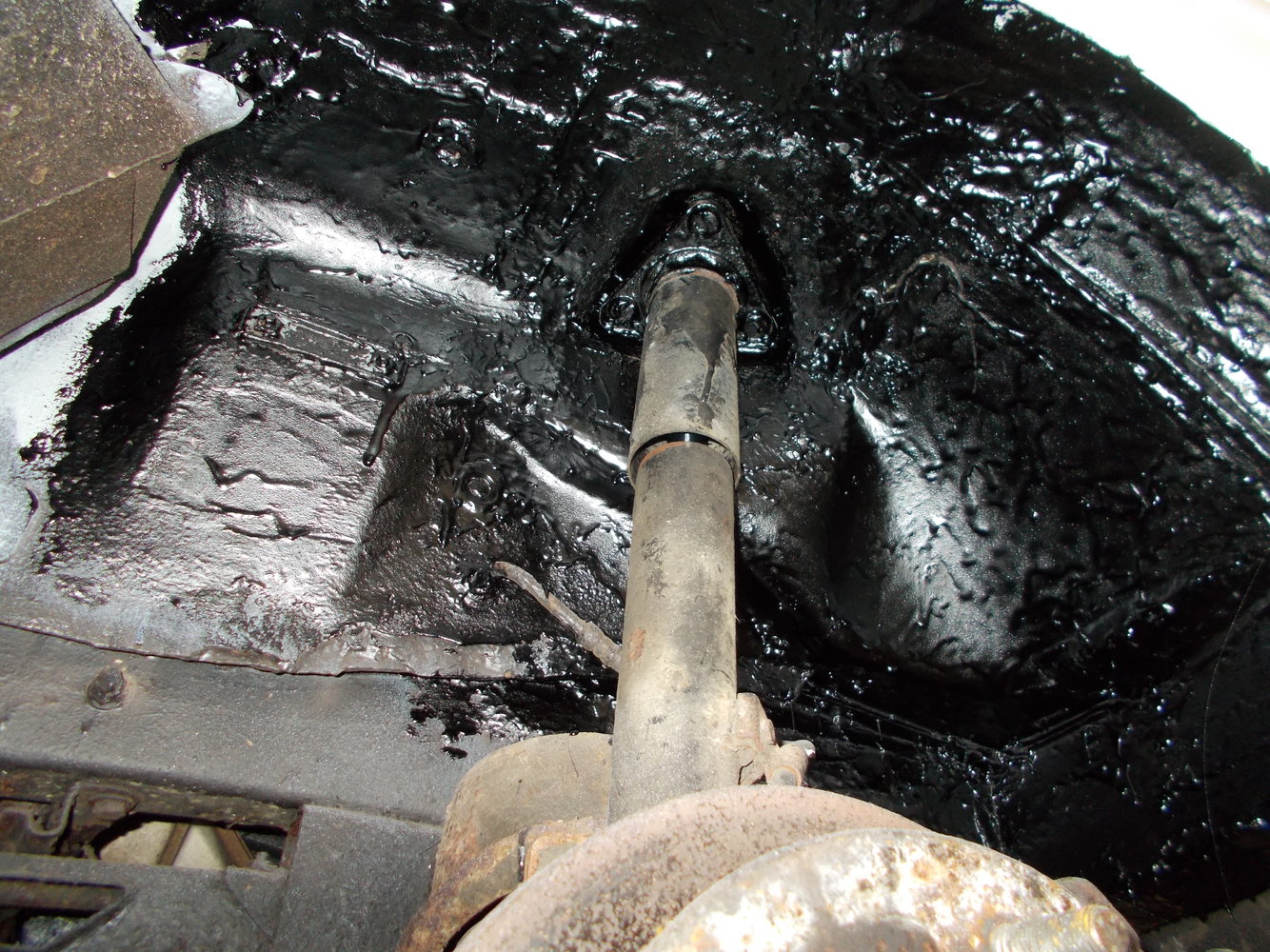

cheersView attachment 422604View attachment 422605View attachment 422606

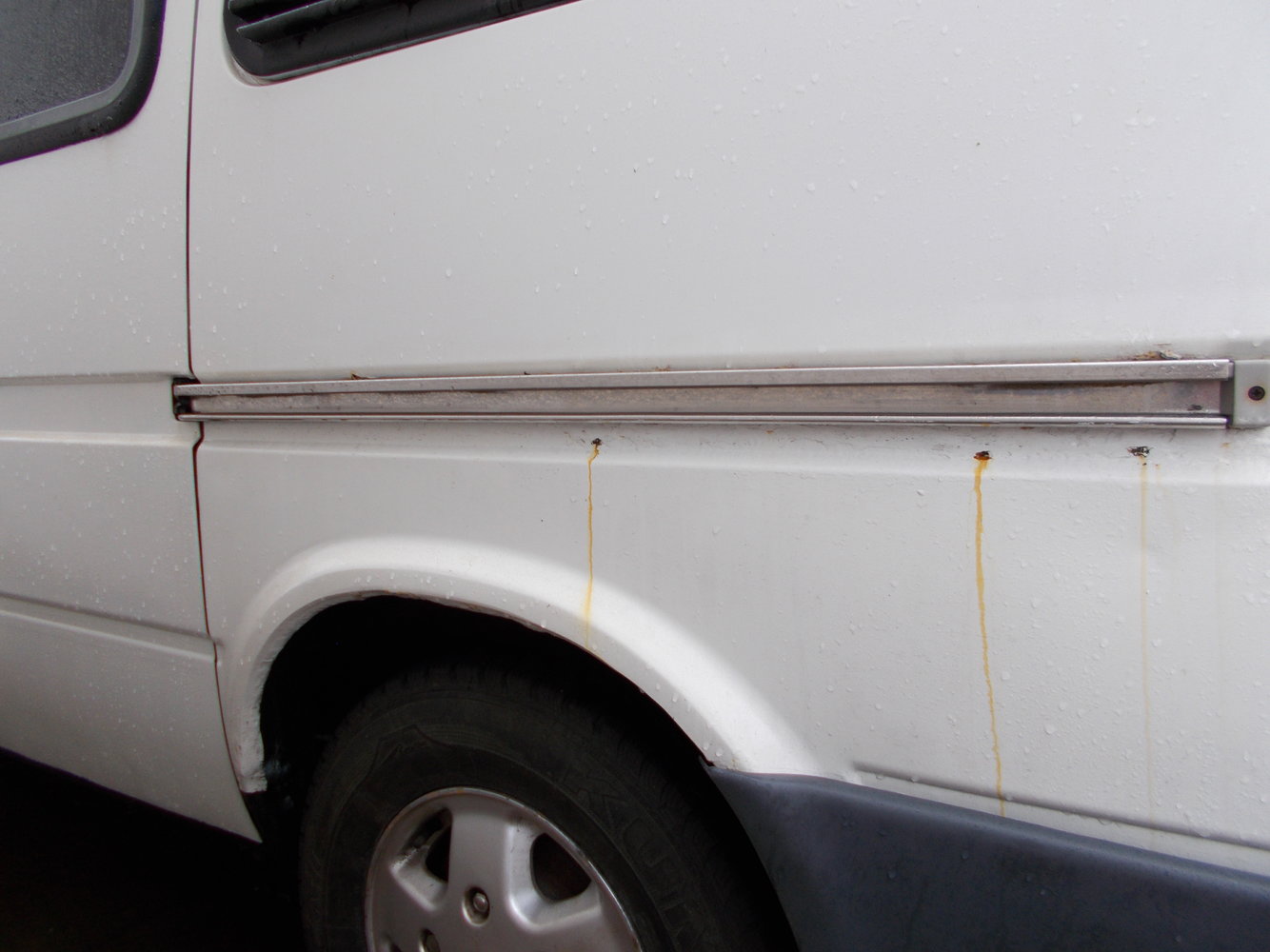

well its a long term project and this is our way of getting away, i bought it in august and stuck it in for a timing belt and water pump and even with a good mot i new work would be needed to keep it on the road so off i went with my eyes wide open, come spring i intend to start cleaning off the chassis and give it a good clean up, as of now i can see one small area thats needs a weld but nevertheless the rest will still get cleaned off and sorted.Hoping we hadn't! Looks like you're making good progress, well done.![]()

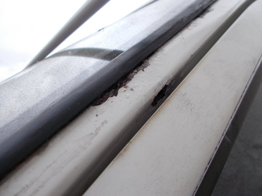

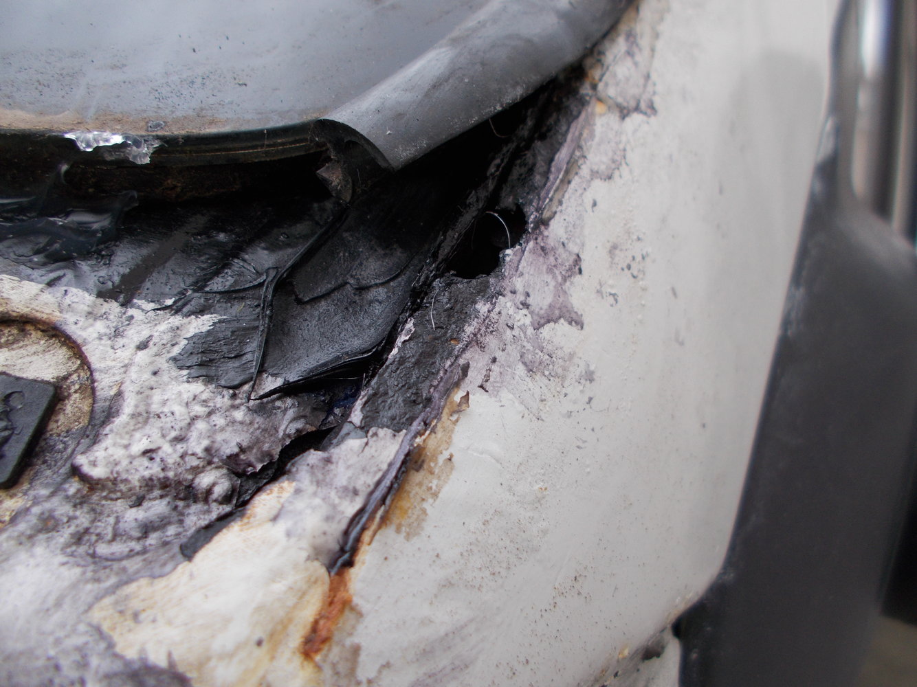

not sure what you mean by bonded in, i gather its like any other mk5 with the sealent placed around the inner lips of the windscreen then the windscreen placed into place and pressed against the sealent with the rubber edging being pushed into place around the edges, is there any other way it would be put in?.Hard to really see, but that looks like a lot of work. Is the screen bonded in?
