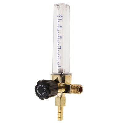

Yes I know it can, by measuring a pressure drop across a restriction, but I’ve never seen a reg do this. It might infer it, by inferring more pressure equals more flow
There's a restrictor / orifice built into this type of regulator assembly.
Pedantic ex instrument tech me I know.....
Think of it as an orifice plate in reverse - rather than measuring DP to measure flow, you set the DP and get the flow.
The restrictor is sized such that it is much bigger than the likely restriction from any downstream valves, pipes. etc. so that these only have a minimal effect on the flow.
Of course, it won't be as linear as the gauge graduations would suggest, but close enough for rock and roll - Flow can always be confirmed with a peashoooter in any case.
